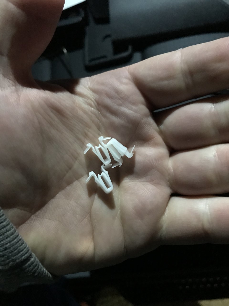

    Thanks for the write up...u owe me $250 now! Just finish install of tweeters, front and rear speakers. Tweeters were cake to install and huge difference in sound. I don't think they'd work for me by themselves though, just too much high with no balance. After reading some of other people's problem with the brackets, I mounted speaker to bracket first and drilled 4th hole since it didn't line up. Taking off the front doors were easy. Rear doors were much tougher to get off, had to use some muscle and then pull clips off the door and put back on door trim. Only did sound dampening sheets in front, mainly because I forgot about the back lol. I don't hear any rattling so I'm sure it'll be fine. My only real issue are the clips holding the trim if the front doors by the mirror (triangular piece). I didn't pull those out and went to put trim back on and pushed 2 of the 3 clips through the door... they're gone, but trim seems to stay. Might have to order a few.

    Just put the Amazon clips on and don't see any problems. Should be good.

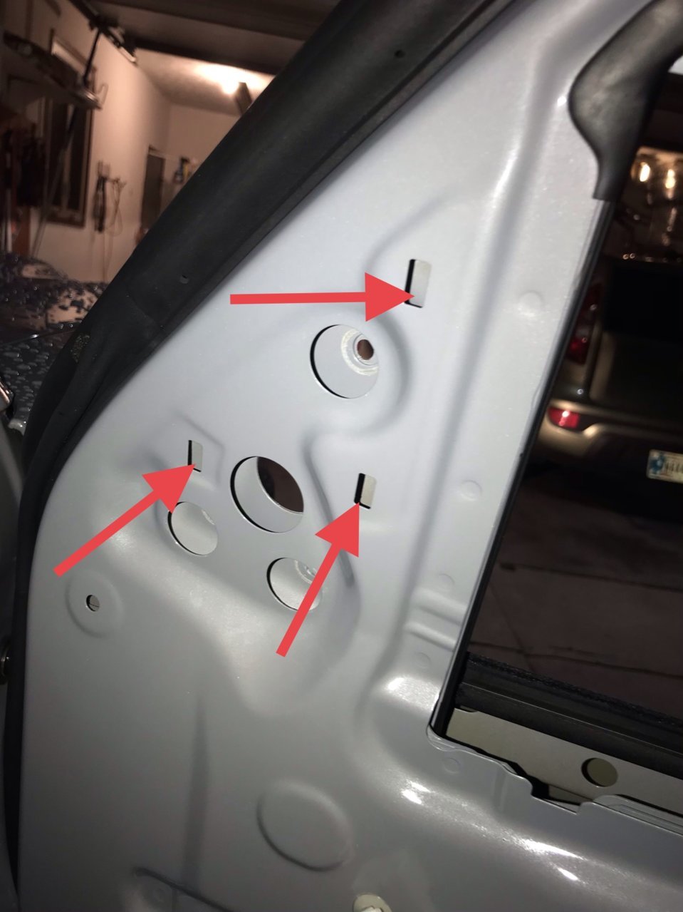

    When taking off the side view mirror cover, make sure to remove the white clips. They are easy to pull out (squeeze together) if they don’t come off with panel. If not, you will push them through the holes and they will drop behind the metal panel. That pocket is not open-bottomed either and they won’t fall through to the bottom. I had to remove mirror and fish them out with a modified hook.

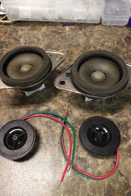

    Has anyone just jut out the OEM tweeter and wired in an aftermarket tweeter on top of the tweeter bracket?

    This would be difficult to do. The tweeter and mounting plate are one piece. You would need to disassemble the new tweeter and figure out how to mount it inside that plate

    Instead of purchasing the aftermarket replacement tweeters I fought I say just replacement plates so yo can add your own preference of tweeter but I cannot seem to find the link anymore. I'm asking because I have a 2 pair of Bose tweeters I would like to install.
    2nd set I am going to parallel into the front set and install on rear wall in access cab.

    I did it. Had some Bose tweeters that looked like they would fit. They did perfectly!IMG_20181023_2301495.jpg IMG_20181023_2345483.jpg

    That picture shows how cheap the OEM tweeters are, might also want to take a look at the door speakers, they are even worse.

    Yes cheap but not as CHEAP as the door speakers. Had the panels off the 1st weekend after I bought the truck to pull the OEM speakers and install Infinity 2way 6.5” and 3way 6x9”.
