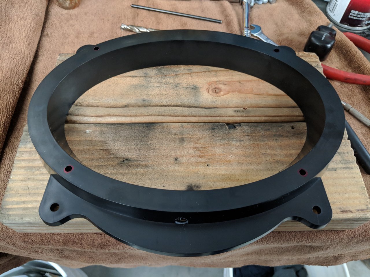

    @SomethingNew71 Thanks for the write up. You gave me the inspiration to take on this project and also the front corner speakers. I'm not looking for a high end system or to rattle windows, just to enjoy my truck. This is a good way to make improvement.
    @PlymouthJLA Thanks for the additional tips. I got the free Metra adapters with my speakers from Crutchfield and what a POS they are. Like you, only two holes lined up perfect and I would have to try to cobble something together to use them (see the OP's picture of the back of his speakers). I've ordered the ones you recommenced from Amazon and now have to put my door back together until they get here in a couple days.
    Edit: I'll be installing the speakers to the adapters BEFORE I tear into the door next time. My bad.

    Interesting I see many are having some kind of issue with the adapters from crutchfield. I ordered my speakers from them as well and got the free included adapters. They aren't the best but not as bad either, worked for me. I mount my speakers to the adapters 1st then mount them to the door.

    I ran into the exact same issue. The metra adapters that came with the component 6x9s did not line up. The holes from the speaker to the bracket. The bracket lined up perfectly with the door. As far as the clips and the door. The ones for the small triangle piece, each time they would come off, I had already seen on a video that a little tip was to super glue those back on the piece itself. NOT THE DOOR CLIPS. The door panels, I found after demolishing my first door panel..even with all the fancy little tools offered. I still had to rip the dang thing off. I did notice that the issue wasnt so much the plastic piece, but the black gasket behind it. Using the panel tool (https://www.amazon.com/KINGLAKE-Pan...5&s=gateway&sprefix=bojo+,aps,159&sr=8-6&th=1). I pried the door from the bottom up. After getting the bottom to pop off, which almost always leaves the clips behind. The others, I would pry it until i could see the clip, and insert the panel tool. Aiming the strait pry bar at the black part beneath the flimsy plastic. Doing that..they popped off much easier.
