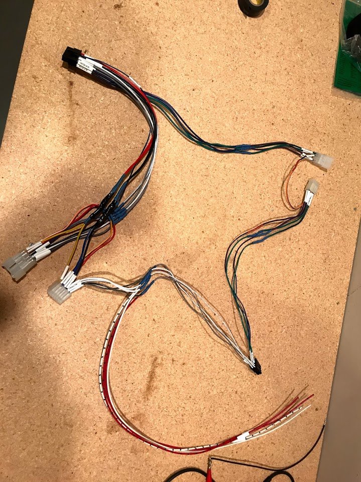

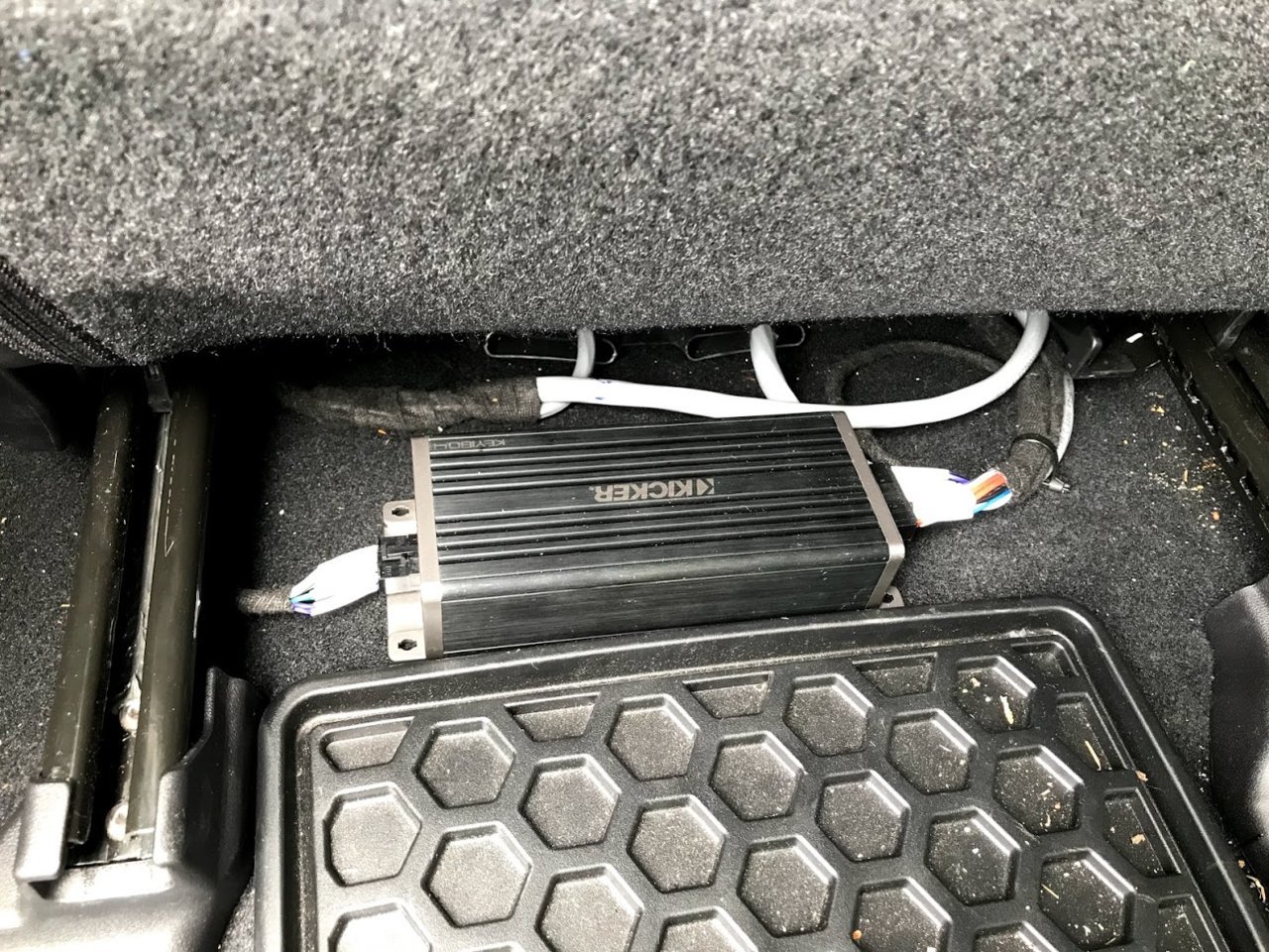

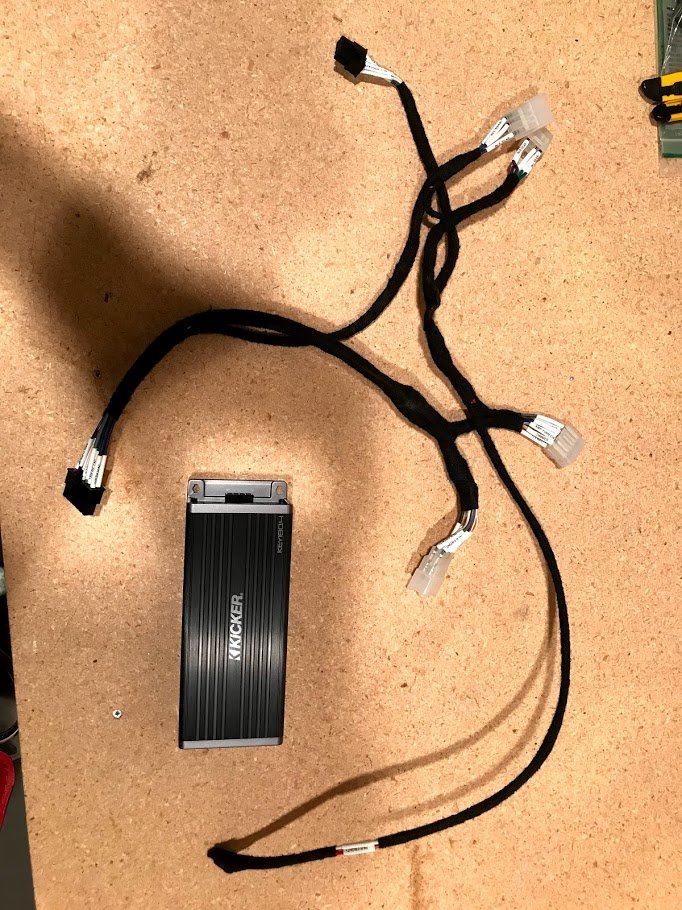

    Kicker key is definitely the way to go if you're looking a more volume at a pretty good price. you'll need to get the metra harnesses (Part numbers: 70-1761 and 71-1761) to make a T harness so you won't have to splice into any of the factory wiring. After completing the setup, it sounded amazing but still had the itch for some more bass, so I ended up getting the rockford fosgate P300-8p that fits perfectly behind in the rear passenger side seat.
    https://www.tacomaworld.com/threads/kickercs-upgrade-with-kicker-key-amp-install-assistance.568985/
    The thread I linked had all the info I needed to build the harness and wire the system. Here's my setup: IMG_0616.jpg IMG_0614.jpg
    Jeff Dartfrog likes this.

    So, if I understand correctly, I can order these plugs, make my own harnesses and not have to run a power cable, grounding cable or speaker wires?
  9. Aug 1, 2019 at 9:36 PM
    #129
    Apaci7
    Apaci7 Member
    Aug 22, 2018
    #263725
    9
    British Columbia, Canada
    2018 MGM TRD Sport DCSB MT
    That's right, you'll not have to run any additional wires for power and ground. All of that will be taken care of by the T-harness
    This is what it should look like (ignore the 4-wires red,red/blk,wht,wht/blk that are loose). I needed to splice those wires for my subwoofer.
    and this was my completed setup after wrapping it with some cloth tape:
    The thread I linked earlier has all the info on where each wire should land.
    Hope that helps!

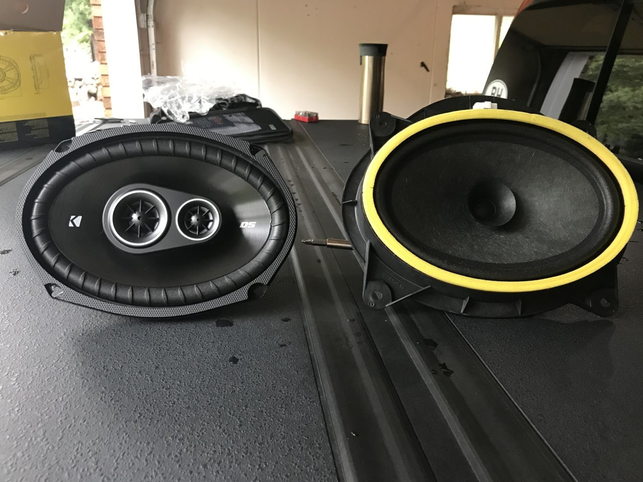

    Hey gang, thought I would add; Best Buy had these speakers cheaper- so a quick chat with Crutchfield, and they matched the price no questions asked. All in for $160 bucks to my door with adaptors and wie harness'
    Should note; mounting the rear speakers in the Metra adaptors... there is a bunch of tabs on the inside ring of the adaptor that need to be removed. I just put a small cut off wheel on my dremel and cut them off. If you dont remove them, it prevents the speaker from sitting flush. Not sure if it was mentioned yet.

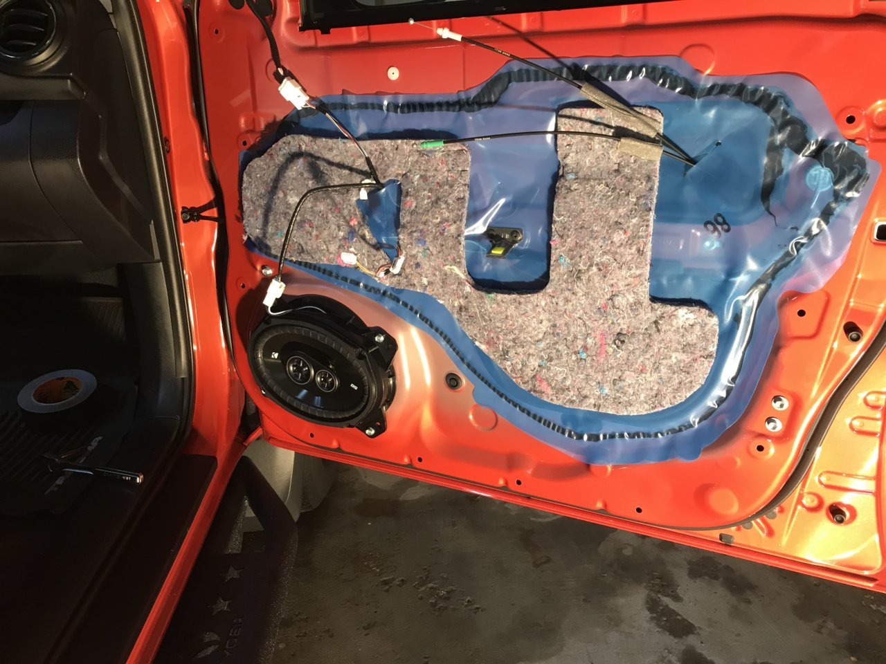

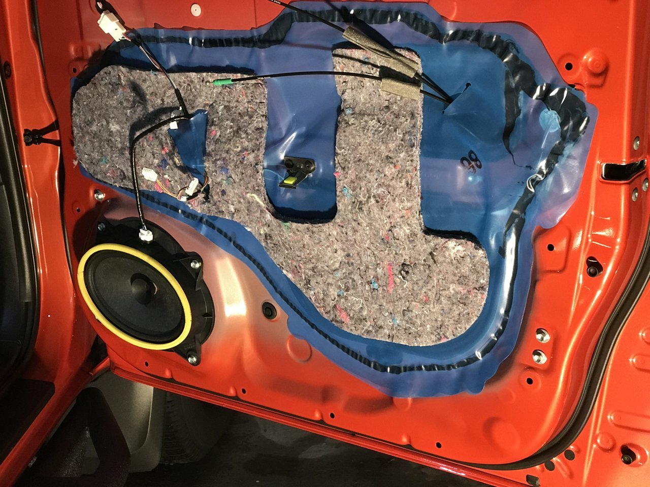

    Taco de Naranja
    Taco de Naranja Well-Known Member
    Jan 18, 2019
    #279730
    1,684
    Benny
    NW WI
    2017 TRD Sport DCSBAT-Inferno

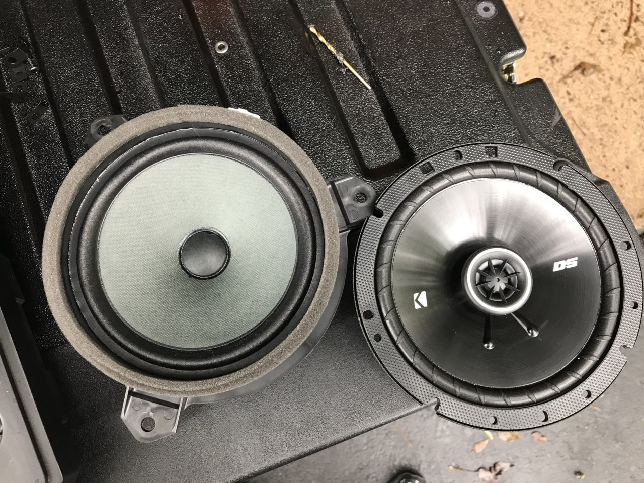

    After doing the Subaru Tweeter upgrade last week, today I installed upgraded Kicker speakers for the doors. Incredible difference. Toyota should be ashamed for the OEM speakers they put in. Great write up @SomethingNew71
    8768A2F6-EC58-415A-8C1B-04A27F8893F9.jpg 6E841636-EF07-4607-8E04-0F9632B2093D.jpg 042BB9B9-A289-456F-A440-C82973E42DDE.jpg 4D93DD22-F9E4-40AA-B1C0-CB9D8BCE5A5D.jpg

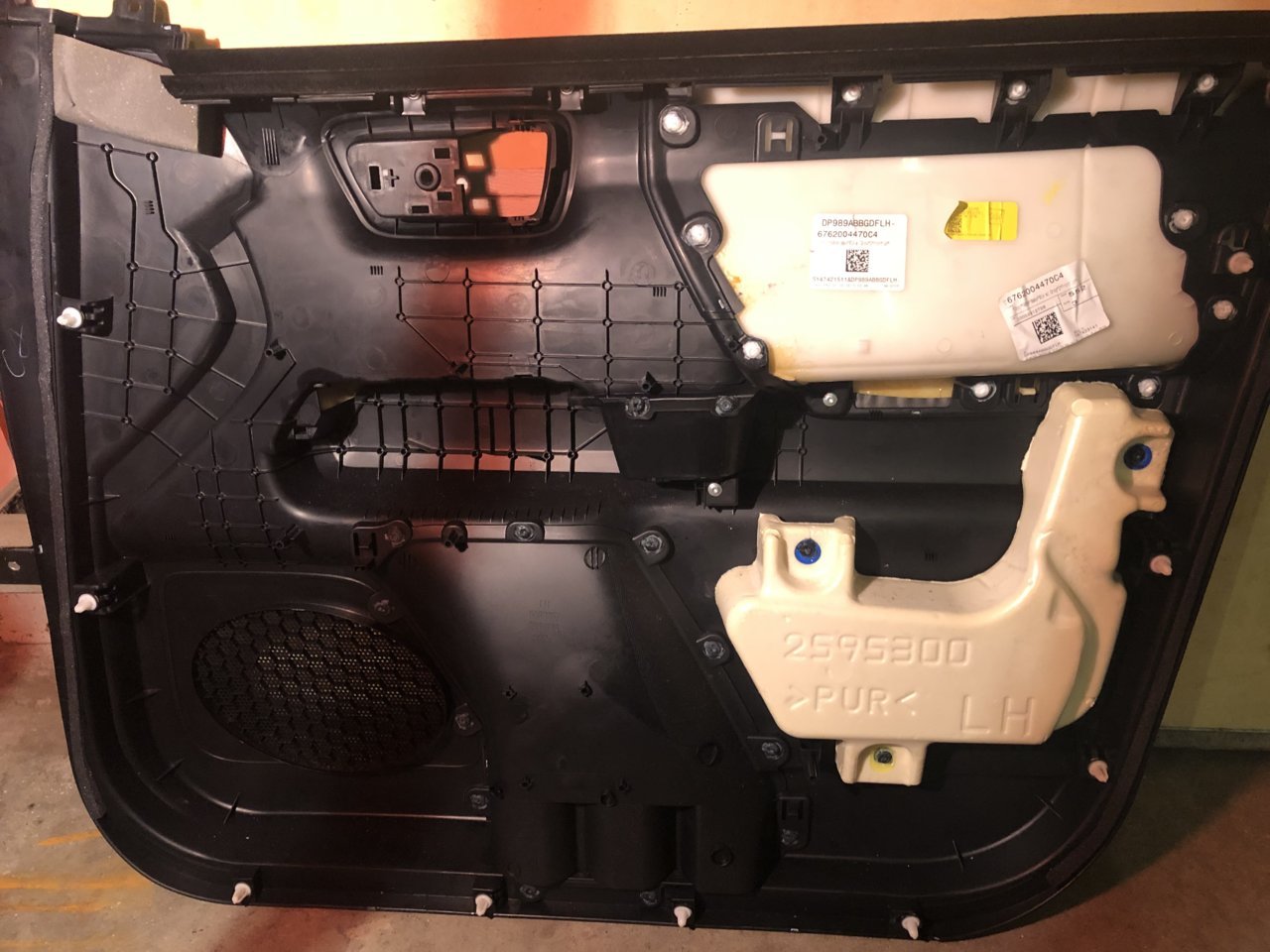

    I hope someone is online tonight. I just pulled the driver’s door panel off and this rubber piece fell out. I can’t figure out where it goes. Any quick help tonight?
