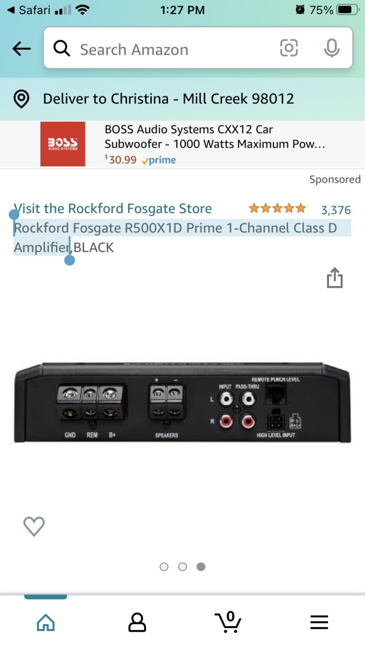

    2019 Trd
    How do you add a amp with the t harness? This is the amp I have

    2019 Trd
    How did you add a amp to the kicker key t harness?
