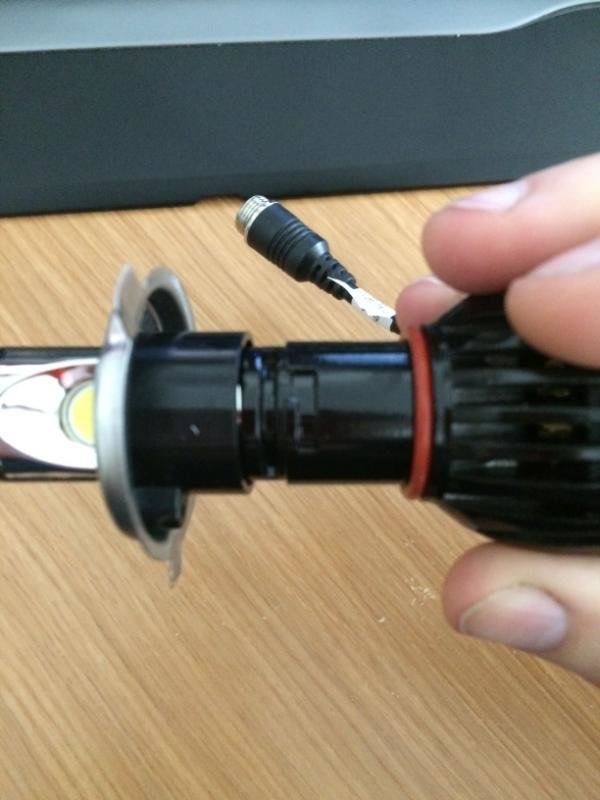

    H4 LED headlight bulb installation
    ***CAUTION*** Be very careful when working with this style bulb and retaining system. I have seen the housing break where the retaining clip attaches. Do not force anything. Try to avoid putting any excessive pressure on the retaining clip. I take no responsibility for any damages caused to you or your vehicle. If you feel you may not be able to perform this task, stop and seek assistance. ***CAUTION***

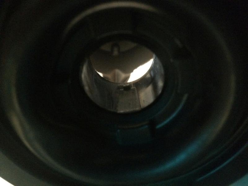

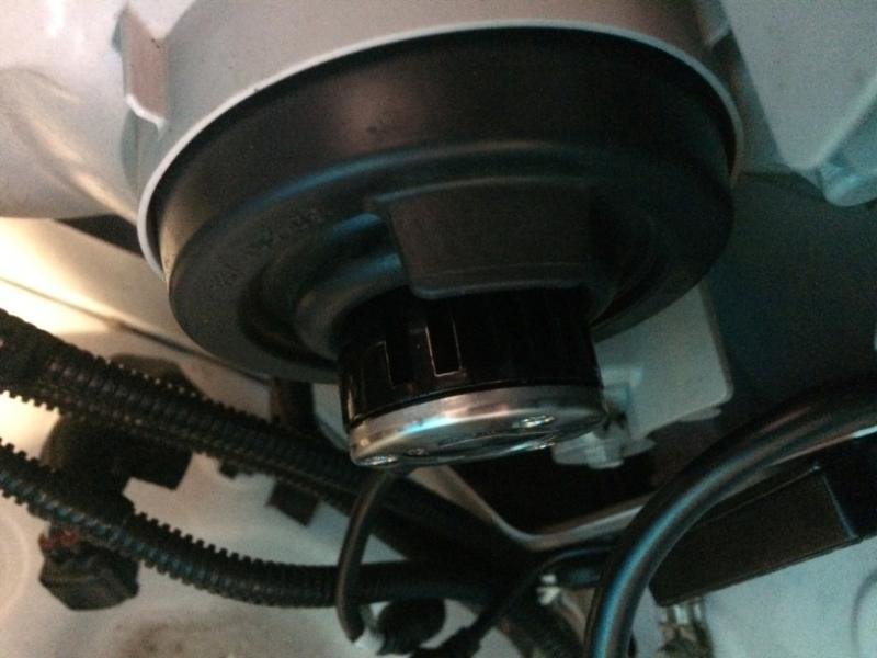

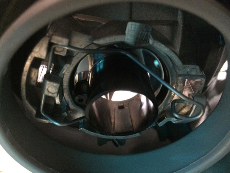

    The H4 style bulb is unique with the manor it is retained in the headlight housing. There is a small retaining clip that applies pressure to the back of a metal retaining plate that is attached to the bulb. There is also a rubber seal that fits very tightly around the base of the bulb allowing a tight seal and only allowing the connector to protrude.

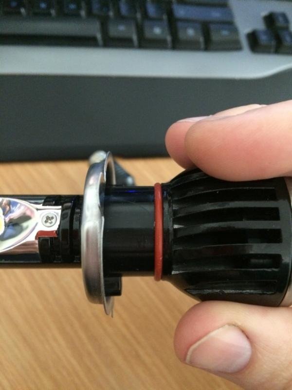

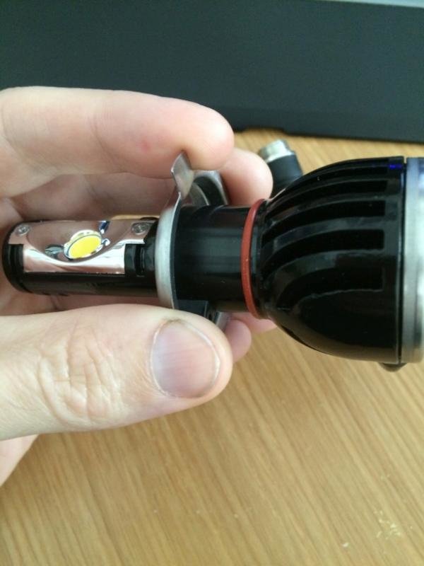

    The aftermarket LED headlight bulb has a unique feature that aids in installation. The metal retaining plate is removable. Allowing just the plate to be secured into place first into the headlight housing.

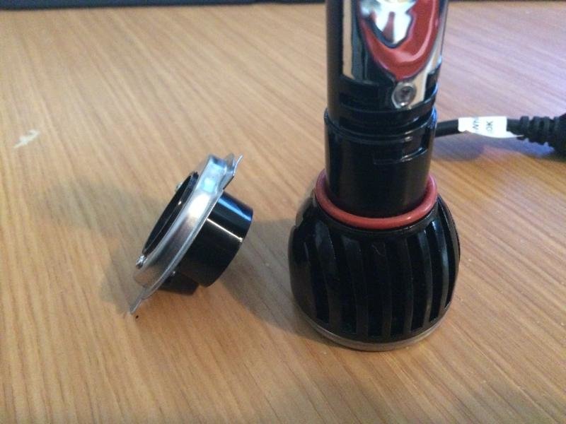

    To remove the ring from the led bulb, with a rag or gloved hand, grasp the metal retaining ring with one hand (the metal can be sharp. please use caution) and with your other hand, grasp the heat sink and gently rotate the bulb counter clockwise. you will feel and hear the bulb unlock from the ring.
    Now install the retaining ring back into the headlight in the same manor the original bulb was installed. The plate is keyed in the same manor a stock bulb would be and should only go in one way.
    Next you will want to work the rubber seal around the base of the retaining ring in the headlight. it will need to be worked far enough down so that the bulb will be able to lock back into the ring.
    Slide the bulb into the ring and lock it into place.
    Connect all the wiring, secure the LED driver and clean up.
    All done.

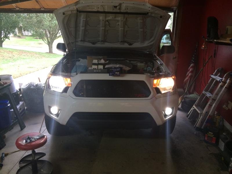

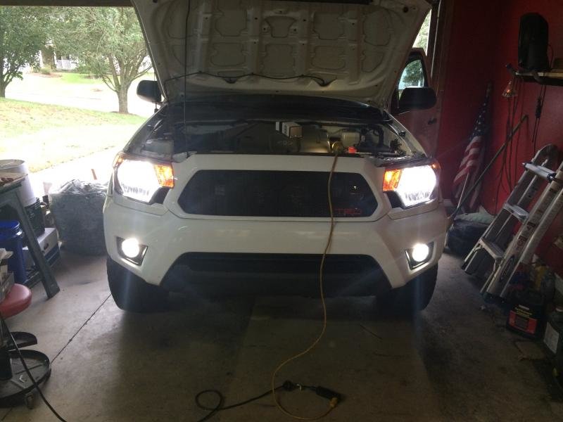

    Comparison of stock and LED. Driver side, or the right side in the image is stock halogen.
    Both sides finished.

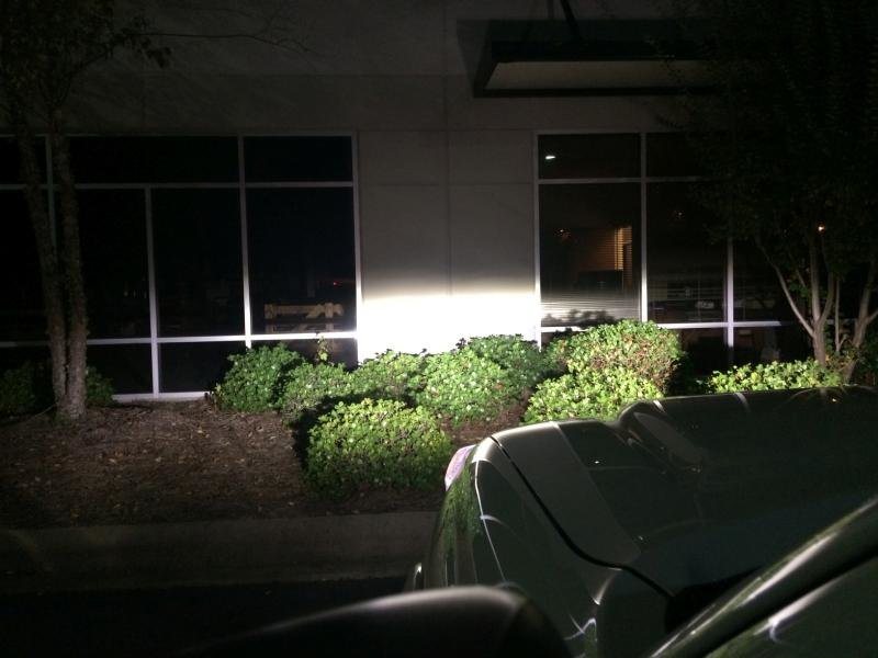

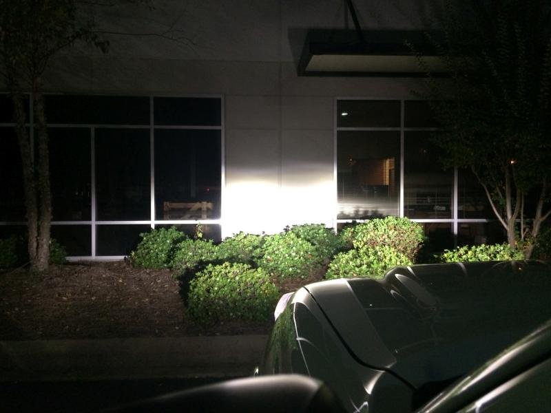

    low beam against wall
    high beam against wall

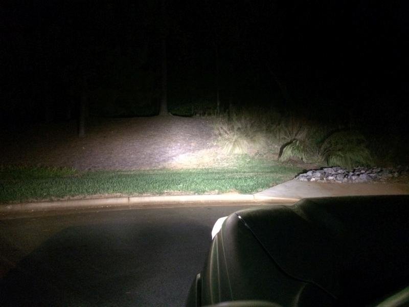

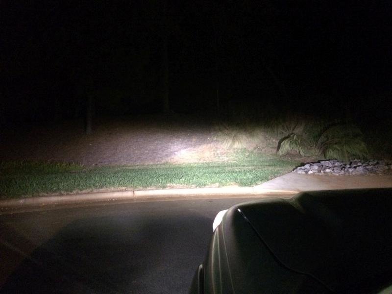

    low beam against hill
    high beam against hill

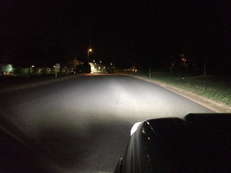

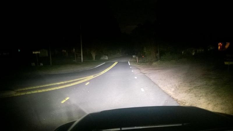

    Down the road

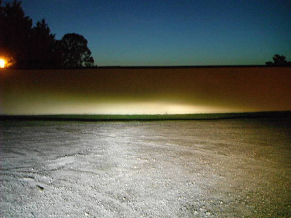

    Just a few LEDs...
    Although I purchased mine somewhere else many months ago, I have these same bulbs in my 2012. I absolutely love them. :D
    Here is a picture with a side by side comparison of these and the stock halogen bulbs shining on a wall that is 240 feet away. I have the LED bulb on the driver's side and the stock halogen on the passenger side.
    The low beam cut-off is not as well defined as the halogens, but look at the ground to the left and the right. The LED on the LEFT lights up way more than the halogen on the RIGHT, and brighter too !!!
    Now look at the left and right side of the wall. the halogen dies off quickly to the right but the LED bulb continues to light up the wall further to the left.
    These are far better than the stock bulbs, in my opinion. :cool:

    thank you for that review and photo. i didnt think to get a shot like that for mine. So few places around me for night time photos i just didnt think to bother.
    Thanks again.
