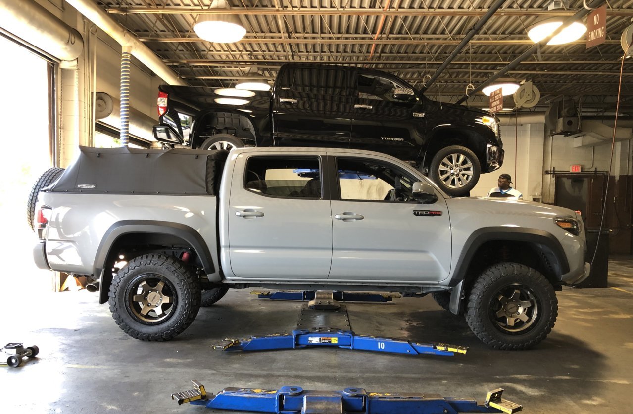

    Finally happened. Went with the supreme 2” lift up front and 1.5” rear block. Definitely pleased with the look and the ride feels almost the same. I don’t do much wheeling these days so I went with a cost effective route. I’m running 265/70/17 Toyo Open Country MT that are pretty aggressive so I won’t be upgrading size yet.

    Looks good!

    nice, same color as my pro,, im going to lift mine in about 6 months after warrenty runs out,, is that a 1 inch spacer up front, which gives 2 inch of lift, thanks,, did you get an alignment ? with 2 in. up front and 1 1/5 in block in back. you prolly have 1/4 in rake ? thanks

    2” spacer up front and 1.5” rear so I maintained the rake. I did get an alignment that is slightly off by a hair. Also didn’t do a differential drop. Haven’t noticed any vibrations or sounds.

    Seriously good looking truck...

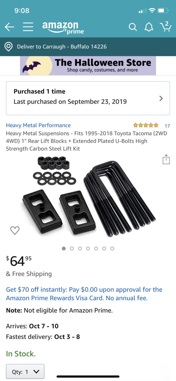

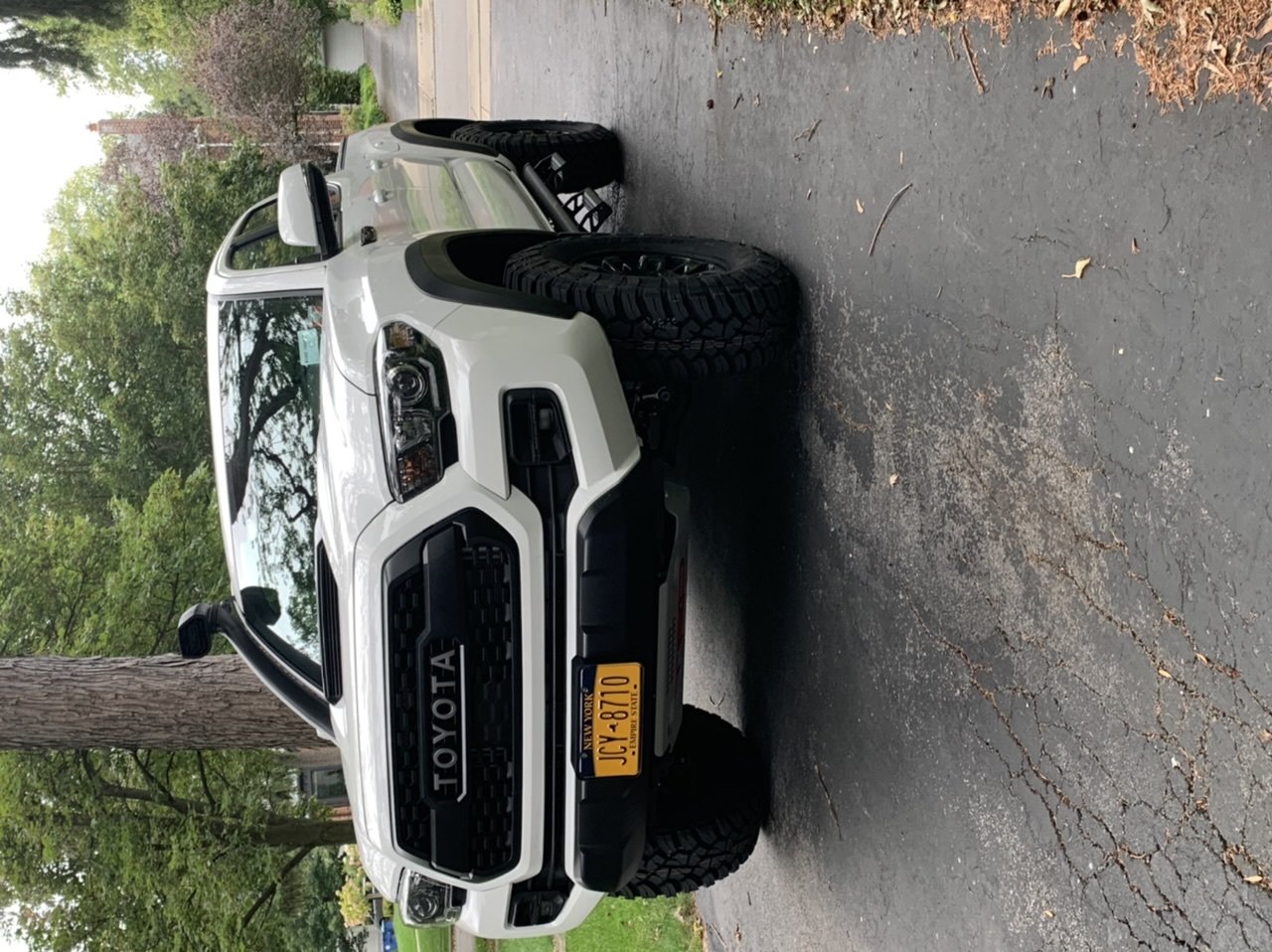

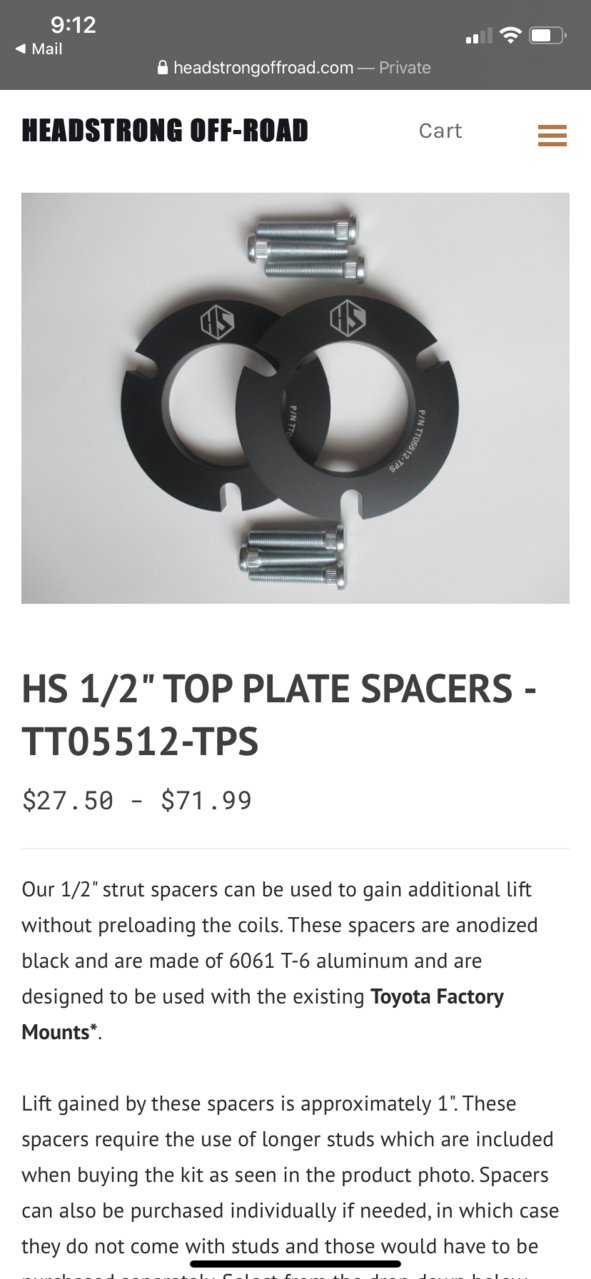

    I just got my pro last week. Did this 1” lift myself in my driveway. Be sure to order the longer bolts/hardware along with the front spacers. You won’t actually use the bolts but will need to use the locknuts that come with it on the stock bolts... once you install the spacers the stock bolts aren’t long enough to thread on the stock nuts, however the locknuts that come with the kit fit fine as they’re half as tall. If you do it this way you don’t need to rent a spring compressor to swap out to the longer bolts. This setup overall gave just over an inch front and rear. Maintaining rake to not mess with sensors in grill/windshield. Tires are 285/75r16 general grabber x3. Close to size as BFG muds dimensionally (so a touch bigger than BFG all terrains). No rubbing on road (no wheel well melting yet, no frame chop, and still running stock mud guards). Further testing to be confirmed for off road use.
