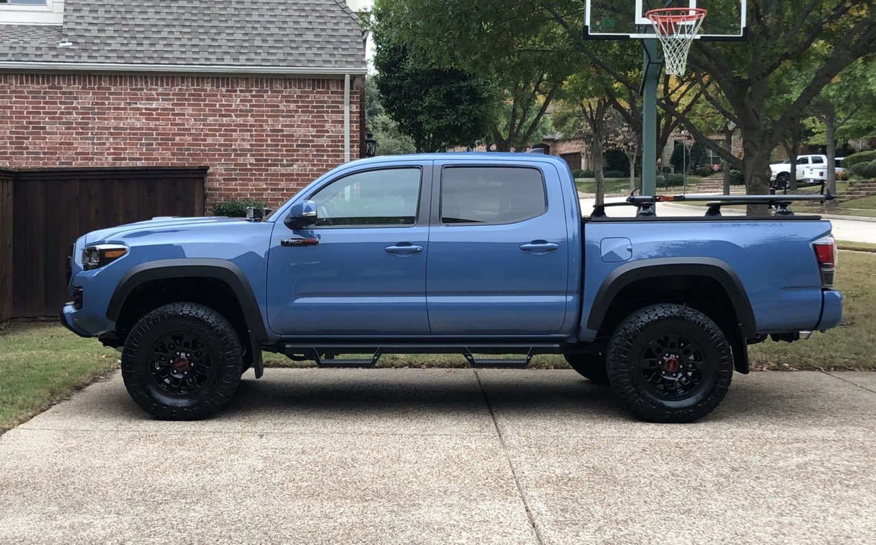

    thanks...in general, I think 265s look too small with lifts, but that looks really good. Maybe bc it's not a full 3" that is the standard for non-Pros? How level do you sit now?

    Very level. Pic below is a iPhone level on the bed of truck.

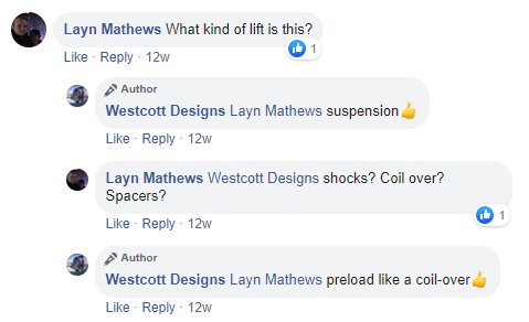

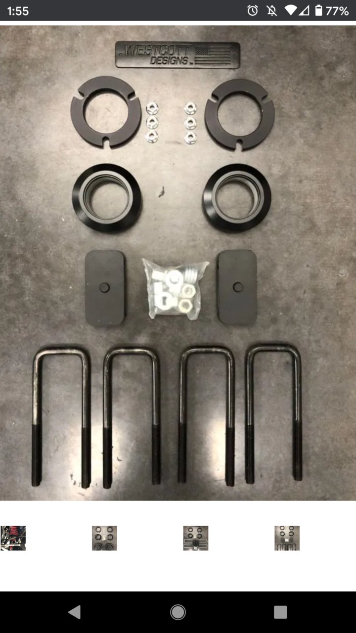

    #269826
    106
    Gainesville, FL
    2018 Cavalry Blue TRD PRO MT
    285/75r16 BFG KO2
    It also says you can run a 33" tire without a body chop... I don't think that statement holds up with a negative or even zero offset wheel.
    EDIT: Upon further glance it looks like it replaces the lower spring perch to a thicker one creating the effect of a coil spacer.

    Yea I have 285s on mine I was just trying to figure out what is going on with that lift kit, it looks to be a combination of a spacer on top, a spring perch/collar replacement, and a block lift for the rear.
    Here's a response to a question on his facebook page:
