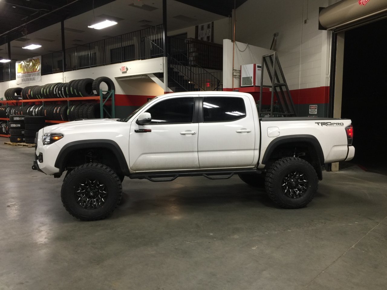

  3. Jan 29, 2020 at 7:05 AM
    #263
    crappie man
    crappie man Well-Known Member
    Oct 24, 2015
    #167579
    2,021
    U have pic with 6in lift
  4. Jan 29, 2020 at 7:25 AM
    #264
    Jtaco50
    Jtaco50 Member
    Feb 7, 2017
    #209934
    24
    Mountain Home, ID
    TRD PRO
    Nitto tires
    6 in Fabtech
    itsmermf, TRD-ED and BangosTaco like this.

    17, 35s

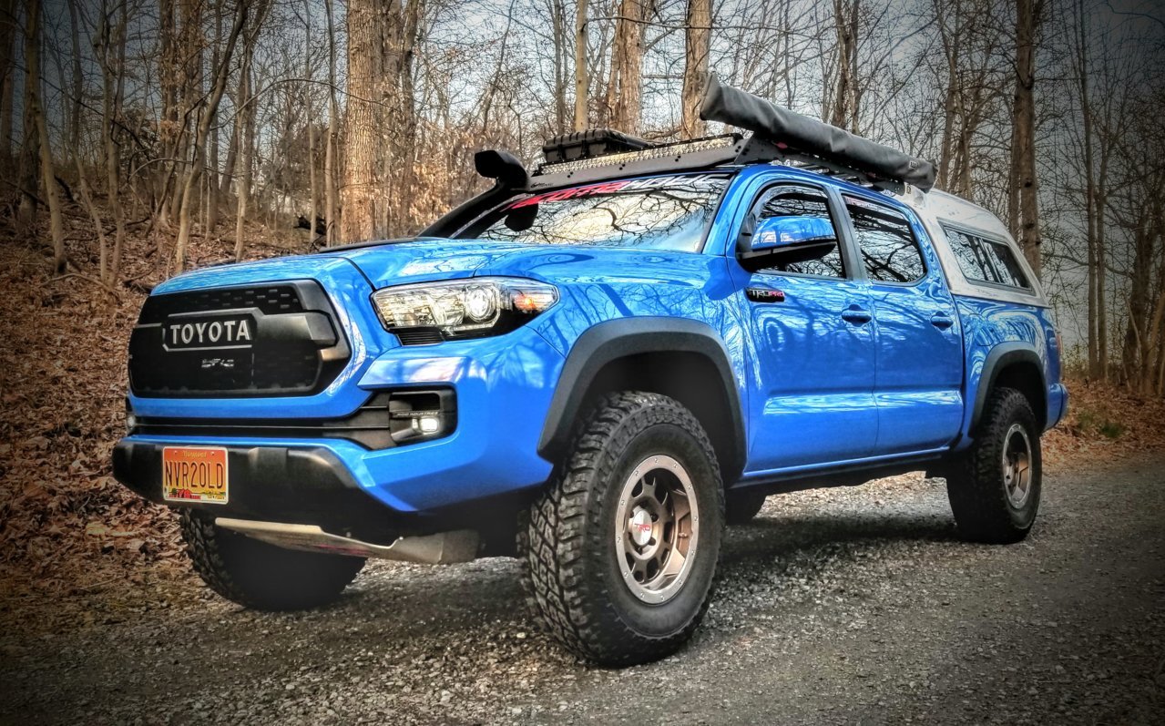

  17. Mar 15, 2020 at 10:57 PM
    #277
    RobP62
    RobP62 NVR20LD
    Jun 4, 2017
    #220718
    41,519
    Rob
    Street, Md.
    TTC Member #0125
    I run 255/85R16 Cooper S/T Maxx on TRD Beadlocks and haven't done anything to accommodate them. I'm putting the mud flaps back on.
