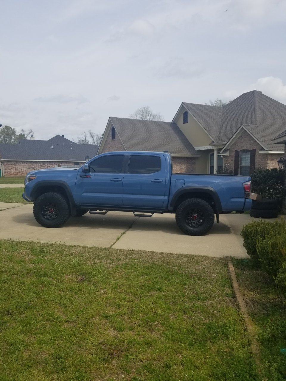

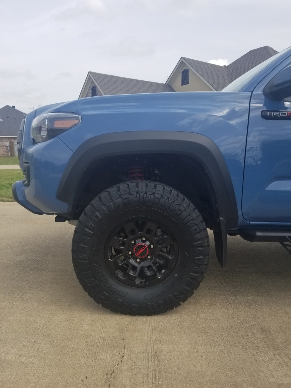

    I'll do my best, as I have a very basic understanding on how this stuff works.
    The rear is just a pair of blocks, simple enough.
    The front splits up the lift, there is a very thin top plate spacer, no more than a 1/2". The other ring looking thing goes underneath the spring, so I think it's like a taller spring perch. From my understanding this makes the ride quality better than having only a large preload spacer. As far as the geometry not changing, I dont have the expertise to vouch for that. I can say, however that my 285's dont rub and my alignment is in spec
    Edit: I also got go keep the mud flaps on

    Its a combo of .5 inch upper spacer and .5 inch preload spacer/collar. The kit does include bumpstop spacers as well. As for functionality idk.

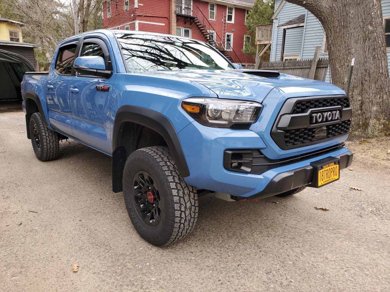

    Scott W
    Scott W Well-Known Member
    Jul 28, 2012
    #83599
    678
    Scott
    Saranac Lake, NY
    2018 Tacoma TRD PRO. Calvary Blue.
    TRD Performance Air Intake. TRD Shift Knob. KTJO 4X4 Red TRD Push Button Start/Stop. Calvary Blue FOBIK by AJT Design. 12volt Solutions Remote Start with CAR:LINK Smartphone Remote Start and GPS app. Sprint Booster V3 Throttle Response Enhancer. AFE Silver Bullet Throttle Body Spacer 46-38010. 2" Supreme Suspension Lift Kit. TOYO 265/75R16 Open Country A/T2. EGR Matte Black In-Channel Vent Visors. REK GEN Offroad Mud Guards. AMP RESEARCH Power Steps. JDMastar 10000lumes LED Low Beam Lighting T1. JD Mastar Raptor LED Lighting. TRUXEDO Tonneau Cover.
    I installed a 2" Supreme Suspension on my 18 PRO. Frt shock spacer and rear blocks. All went well with the install and it looks great. Only issue is a rear vibration on decel from 25mph to 0mph. I am going to address the issue with a carrier bearing drop kit to correct driveshaft angle.
