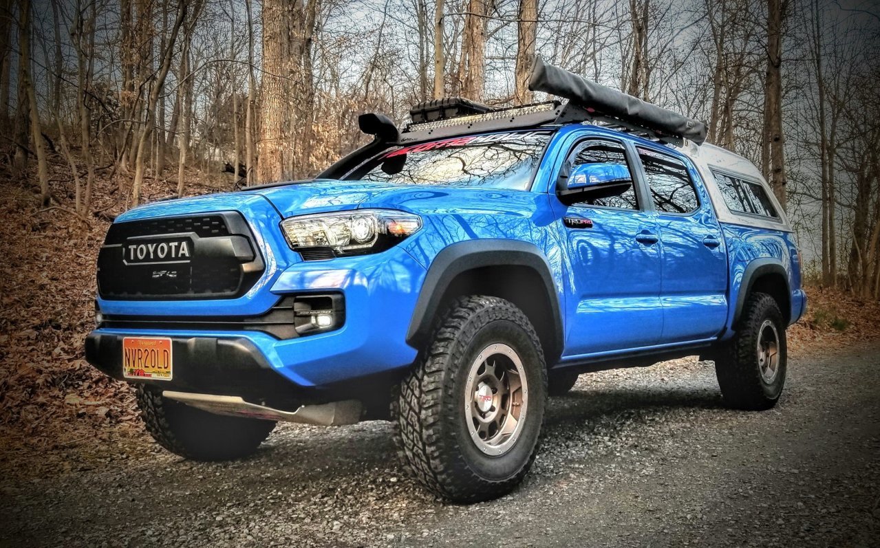

    I'm running Cooper S/T Maxx (255/85R16) on 16" 2nd Gen Off Road Wheels (16"x 7.5", 10mm offset Wheel). These are 33" tires but are only as wide as the OEM tires. I thought about doing a little lift, and depending on what armor I eventually add, I might do a little. For now though, I am not sure I needed to remove the mud flaps. I may put them back on just to see what happens. I tested rubbing by stuffing all four corners and nothing. :notsure:
    It rides great on the road at all speeds too.

    Well, the rings on these wheels will get damaged long before the inner hub. I suppose anything is possible though. Get some rocks in there while deep in a mud puddle and yea. You just have to be ready to accept that or go with a second set. You could also just get some steelies. Those you can spray paint after each time you hit the trail. I would only run OEM Toyota wheels or SCS wheels. I'm funny that way.
    Wider tires are just going to throw more debris up onto the sides too. You need to be careful to be sure you get the right offset so the wider tires doesn't contact your UCAs and when you do that you're increasing the chances of rub at half turn or more. That will lead to a front end alignment in hopes of achieving an increased caster angle, or you will need a CMC.
    Do wider tires look good. Hell yea. Once you get over that and realize all the benefits of a skinny tire and the fact that wider tires are great on the track, and in the frozen tundra, on beaches or dunes, you probably will get over it quicker. Now there is some controversy wheather wider tires are better in the snow than narrow tires and I do agree, in shallow snow more contact patch is better, but in the mud or deep snow, getting the contact patch down to the terra firma is what matters. Ice, forget about it. Ice is ice.
    Prinsu came out with a model designed to work with the snorkel on the Pro. I did ultimately add a couple delrin spacers only because I didn't like how the snorkel bolted flush against it. It's a great product with a great company behind it. Yes it is expensive and there are likely cheaper versions with just as great companies behind them but I wanted something that all my friends had because if I needed help with anything they would be familiar.

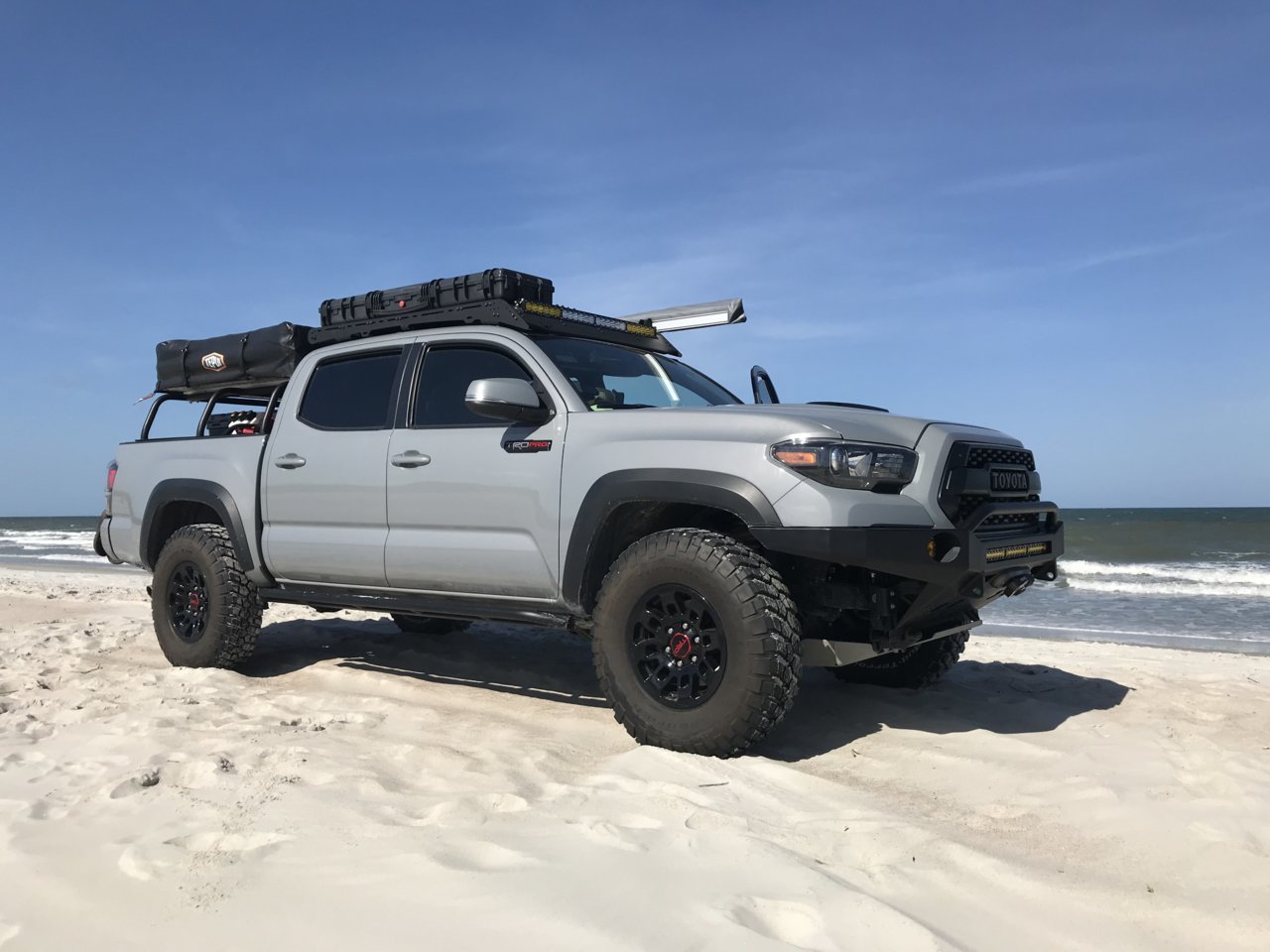

    255/85/16 stock TRD Pro with Icon AAL with overload leaf kept.

    Always a fan of the beach scenes :thumbsup:

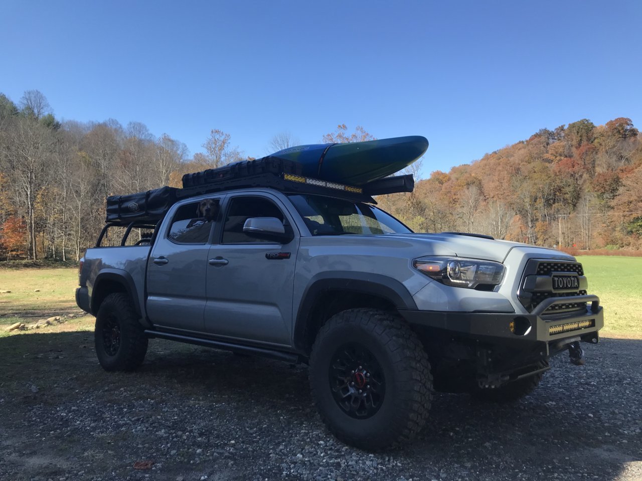

    285/75/16 no lift:

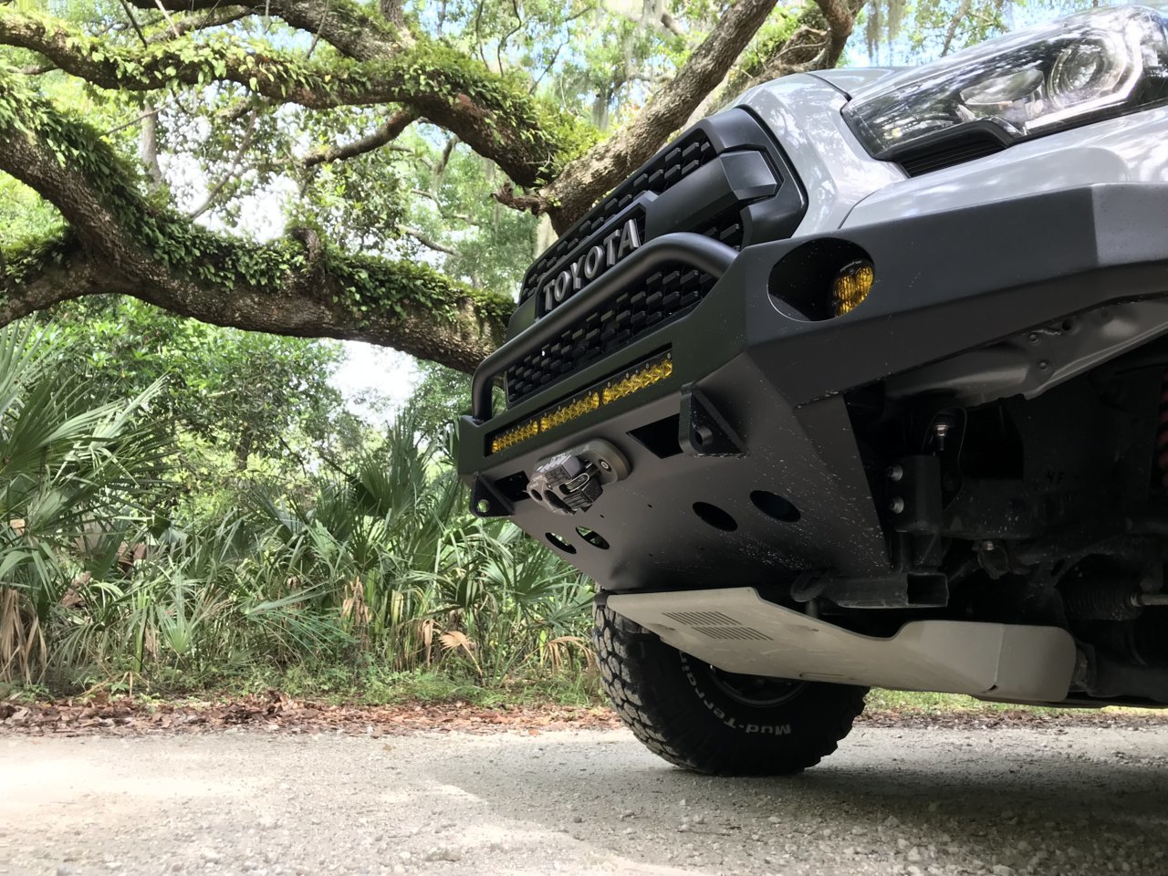

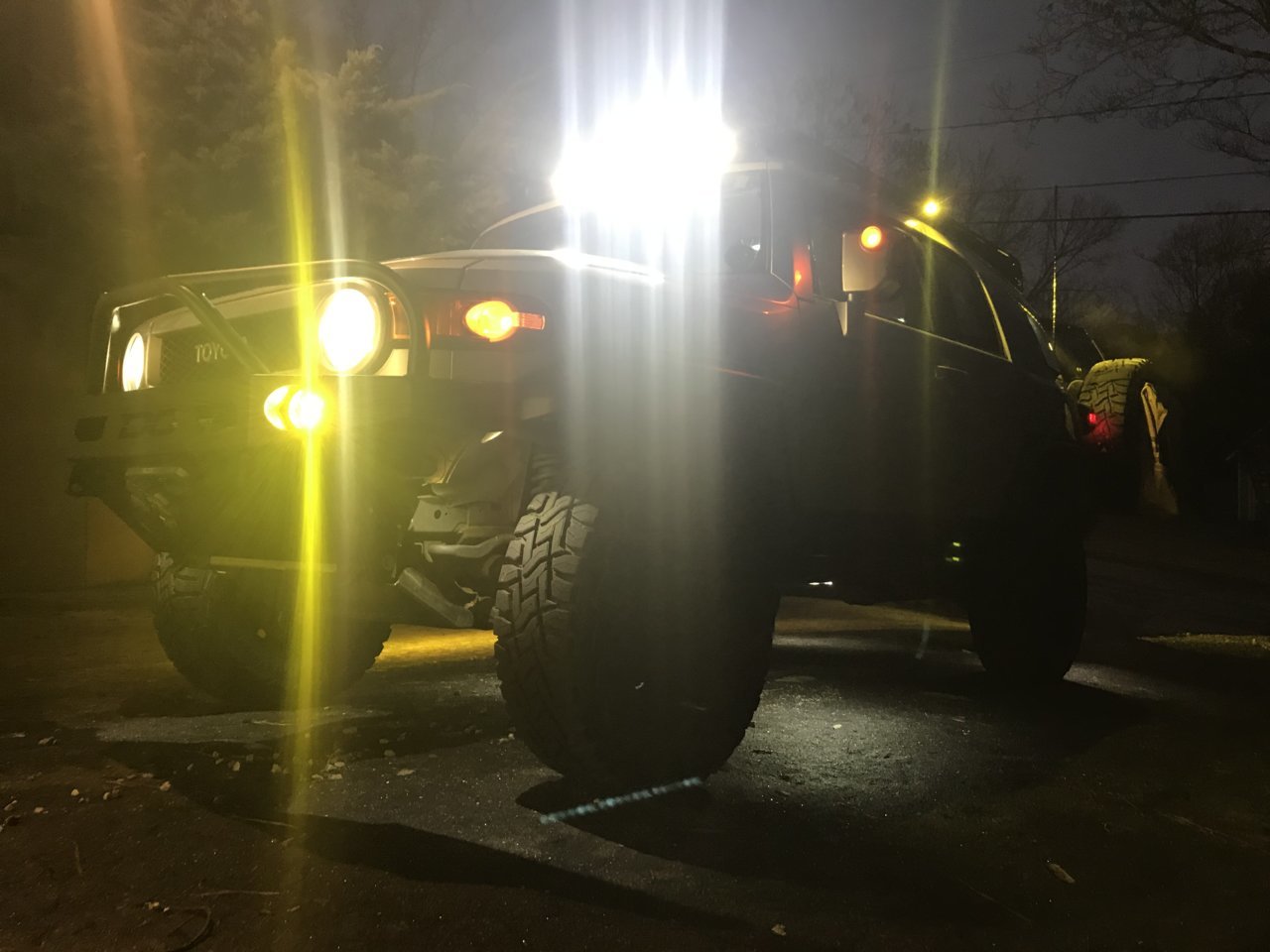

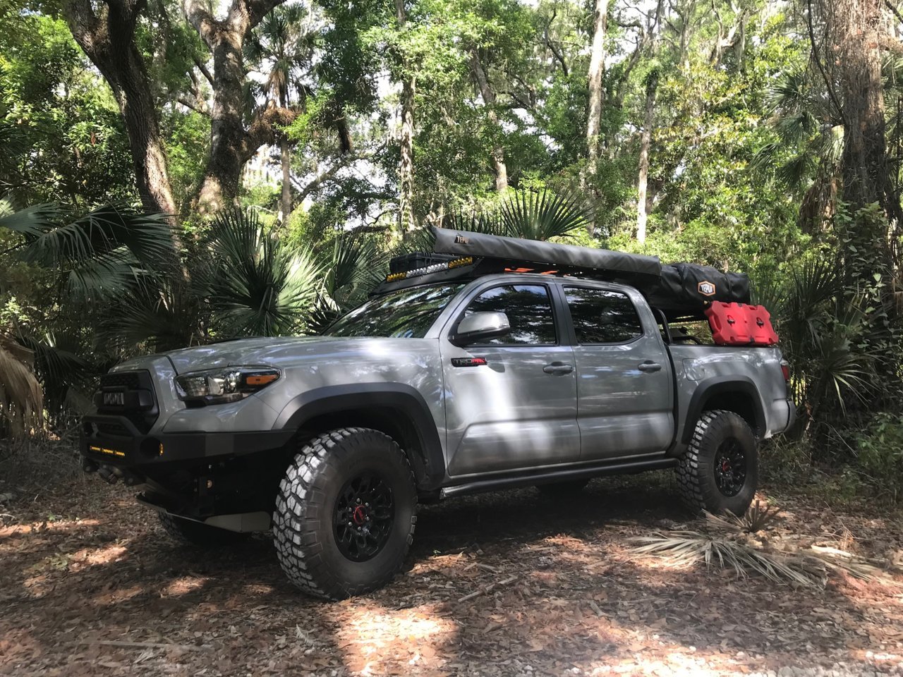

    Well then here is a couple more for you.

    I like it, do you have a front pic, to see the poke? You don't have any rubbing at all?

    No rubbing at all. Took my front flaps off before new tires were put on. Haven’t checked to see if they would rub — will get a front pic today.
