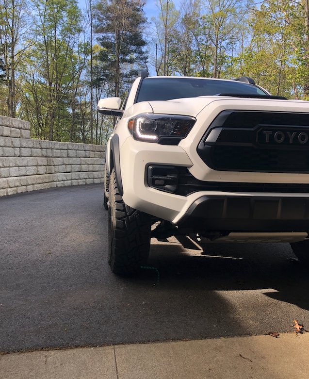

    Not too much poke.

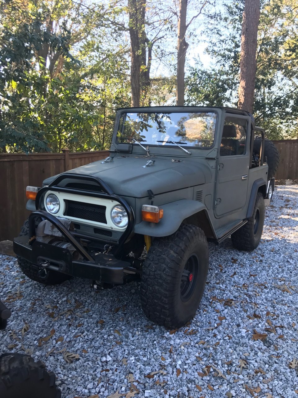

    I know what you mean ;) I had to get an FJC to go with my FJ.

    Looks good man!

    Not too much different than stock. I guess splitting .8 inch is really not that noticeable. Somehow my mind was thinking about an inch to the outside, ... warped thinking, I guess.

    Yea.. I am sure some Spidertrax would make it look great, but I am reluctant to try them even though I know many people use them and are fine. Also makes me think might need some fender work if I push the wheels out too much? Not 100% sure. I just wanted to avoid CMC / cutting my fenders / messing with stock Pro suspension for now.

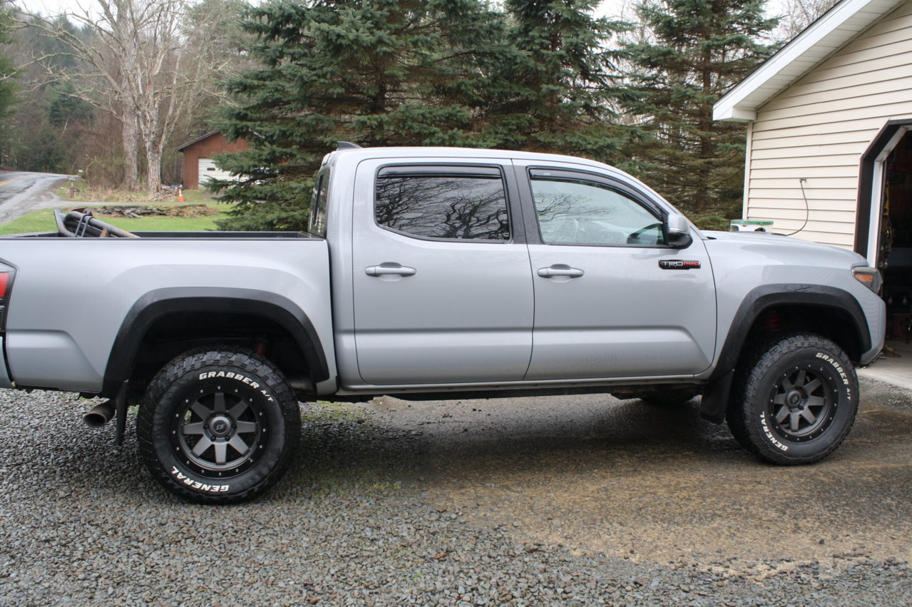

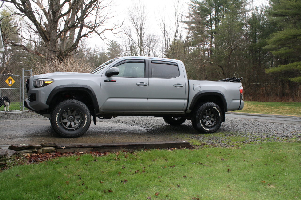

    with such a mild lift, im hoping to have no issues...bought it a yr ago.. got about 70 bucks into parts, and now labor, local shop has no work, hes a friend of mine, so shouldnt be too bad. plus my tires rubbed alittle, with the SCS wheels.

    well lift went well,, 70.00 in parts and 270.00 in labor includes longer ubolts... took it for a ride on a few roads, seems to ride the same. i can notice the height differance when driving, no vibes, i love it,, 1/4 in rake.. i took my tyger auto sidesteps, man they are heavy, mechanic could not believe how heavy they are.gonna put something else on,,.
