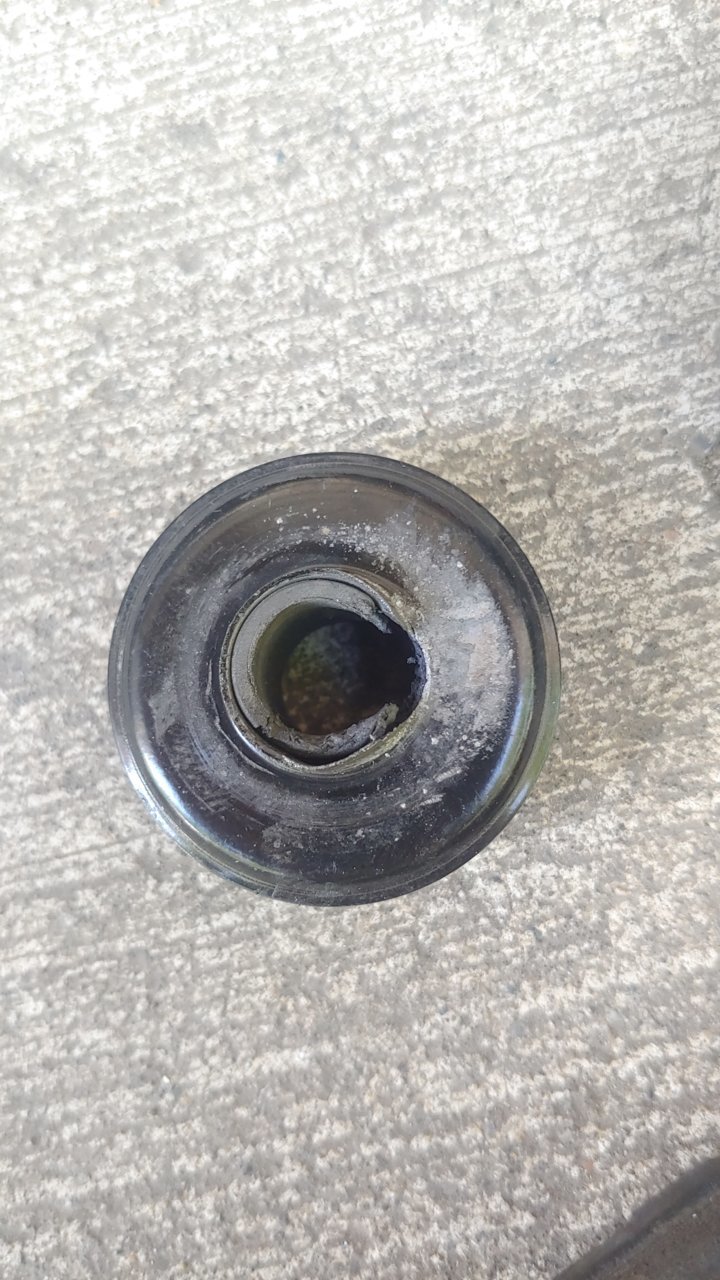

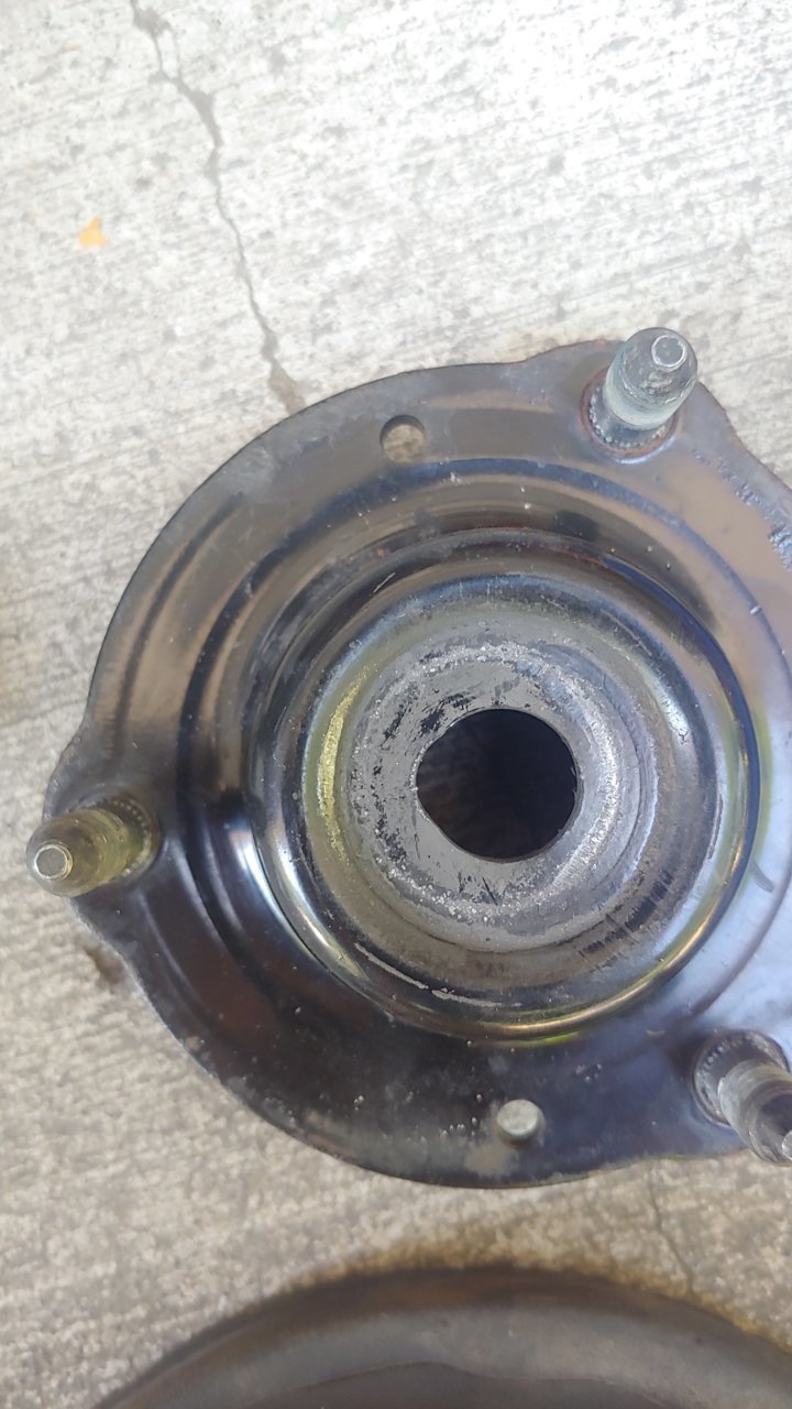

    After installing a Revtek 1.5" on my TRD Pro, I would steer you towards the Westcoast Design.
    The Revtek looks great and seems to ride nice but the lift came with a list of instructions with a lot of basic stuff, but failed to mention one key element that forced me to replace 1 top hat and bushings after one trip off road. I'm mechanically inclined but only do lifts every 5-6years.
    the instructions it says you may need to remove shock boots. It should say" you must remove shock boots" and failed to mention that there was a washer embedded in the shock boot which allows shock to rebound. This MUST go back.
    So, off the shocks come again...
    The plus side, I like how the truck turned out, 285/75/r16 fit great, rides about the same as before the lift and I can now swap shocks out in under 90minutes
