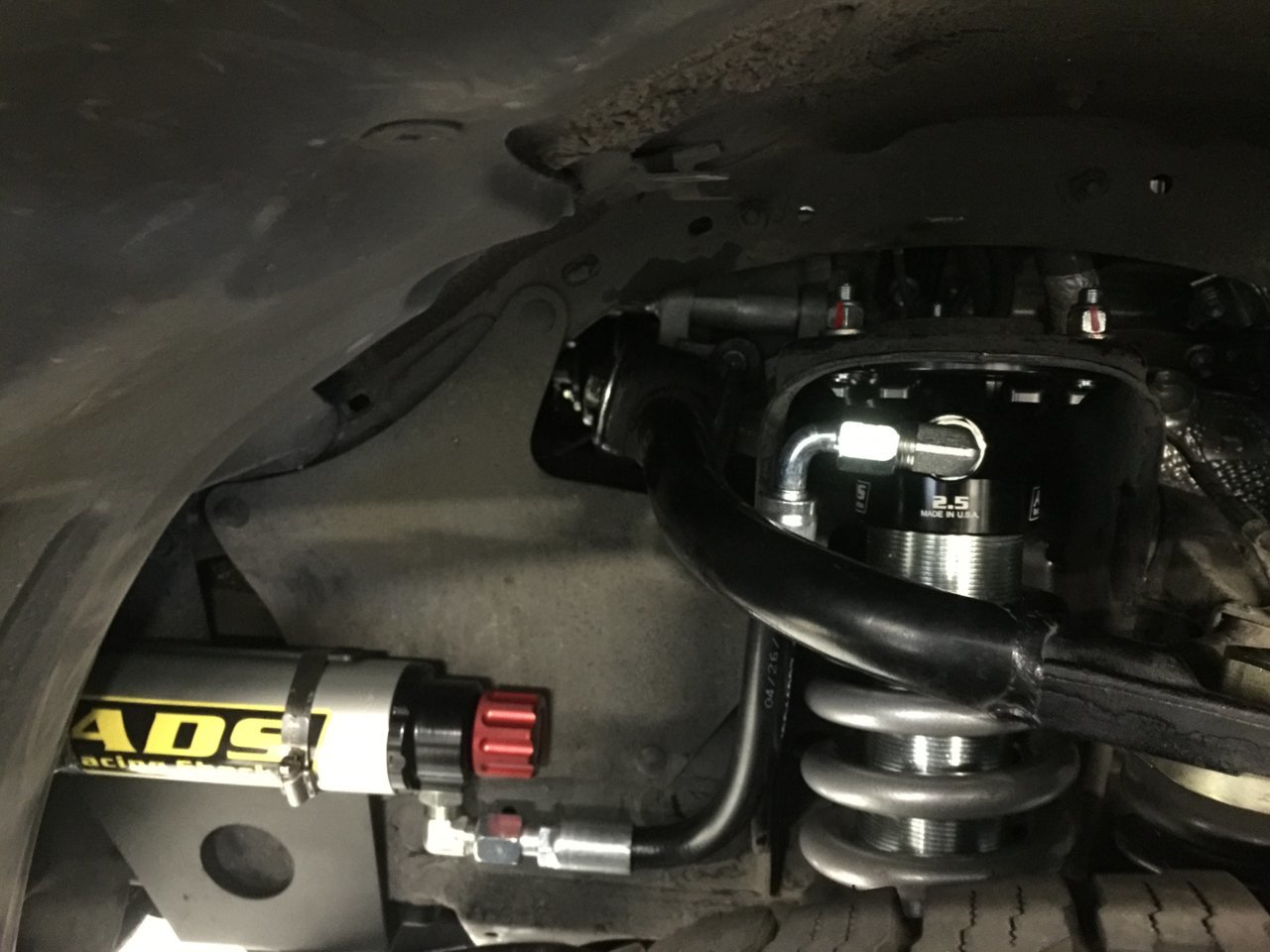

    C4Fab LoPro, BAMF Sliders, Ext ADS 2.5’s, 4.88's, OVTune (OG to KDMax)
    Oh I see. Maybe read up on ADS, supposed to be better than many other coilovers due to their unique valving and exceptional build quality. I can hit 7” rocks at 35mph and they take it like a champ. Just research a lot before you buy if you do end up upgrading :thumbsup:
