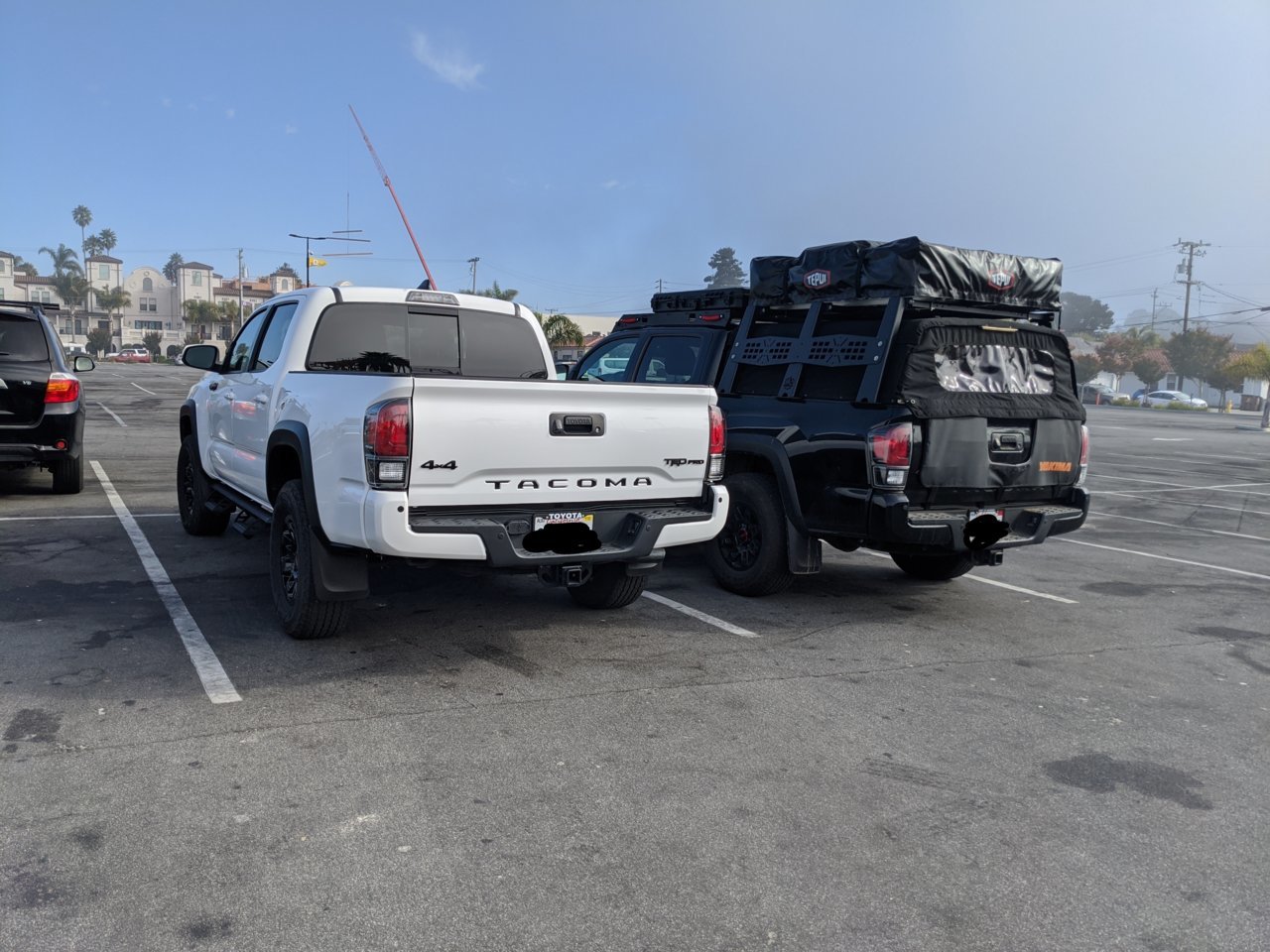

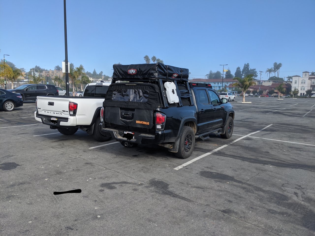

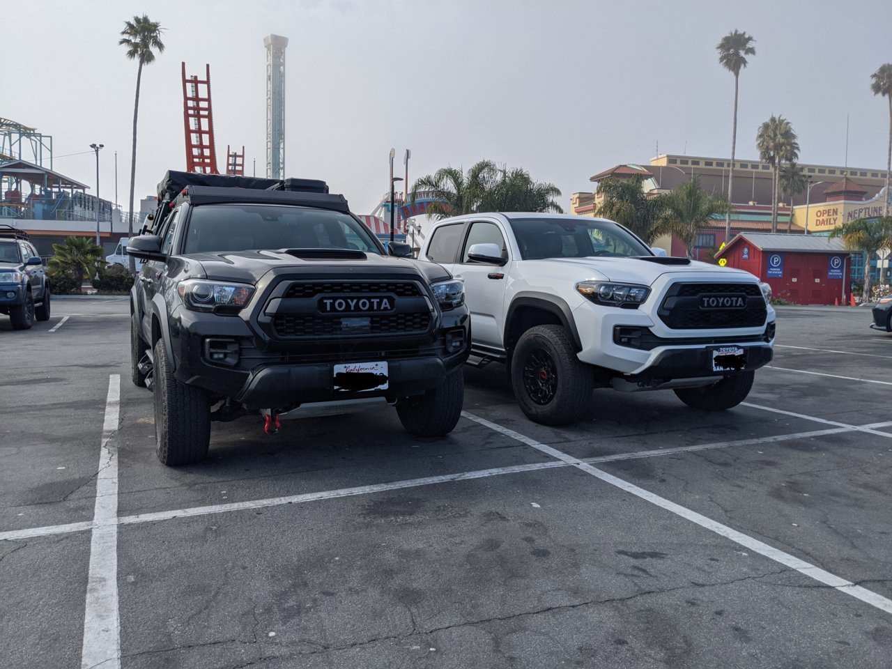

    For reference, a stock empty 19 Pro and heavy stuff on 18 proIMG_20200813_091106~2.jpg IMG_20200813_091054~2.jpg IMG_20200813_091038~2.jpg

    Do you carry anything in the bed or tow anything? I'm curious about how much the back end might squat. Being that the spring rate isn't changed but just lifted off the axle I'm guessing it's probably gonna be the same as stock. I routinely carry a dog, heavy bike rack and 1-4 bikes and the truck sags pretty hard. Camping gear in there too and it's comical. I have 285s on the truck now without issue and I'm more concerned with getting rid of the Cali Lean than actually lifting the truck, although the extra height wouldn't hurt my feelings. The simplicity of the Westcott kit is appealing but I'm thinking it won't help much in the way of keeping the back up while loaded. Probably answered my own question...

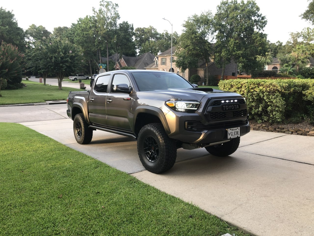

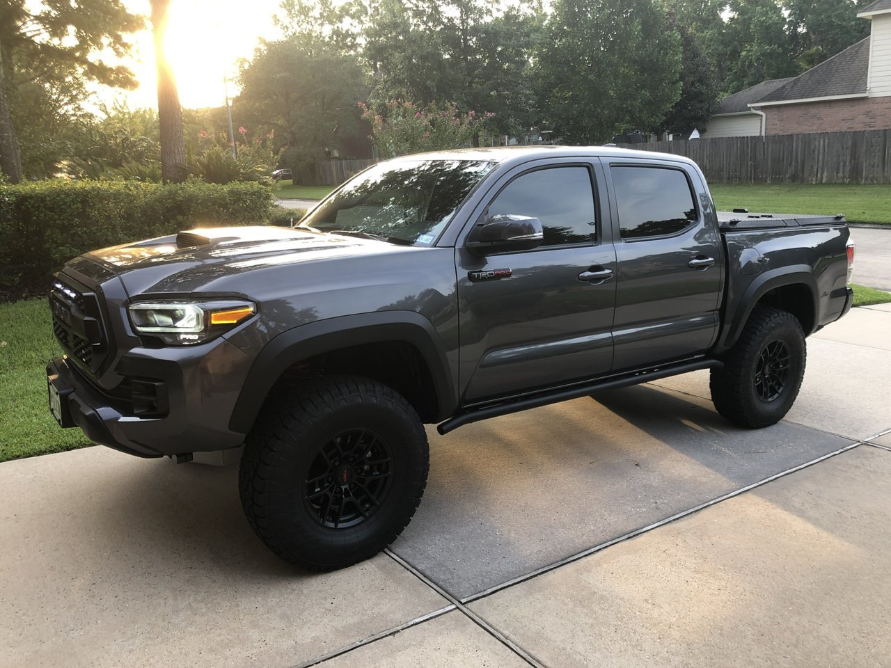

    Jumping in here, did the Westcott Designs Front and changed out the leaf pack for OME medium on my 2020 Pro. Love the look, drive great, no rubbing or cutting. Also went with 285 75 16 Toyo AT3s. Really happy with the set up.
