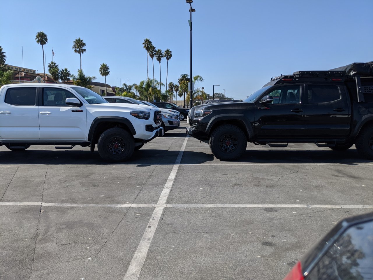

    Stock left, 33" no lift right.

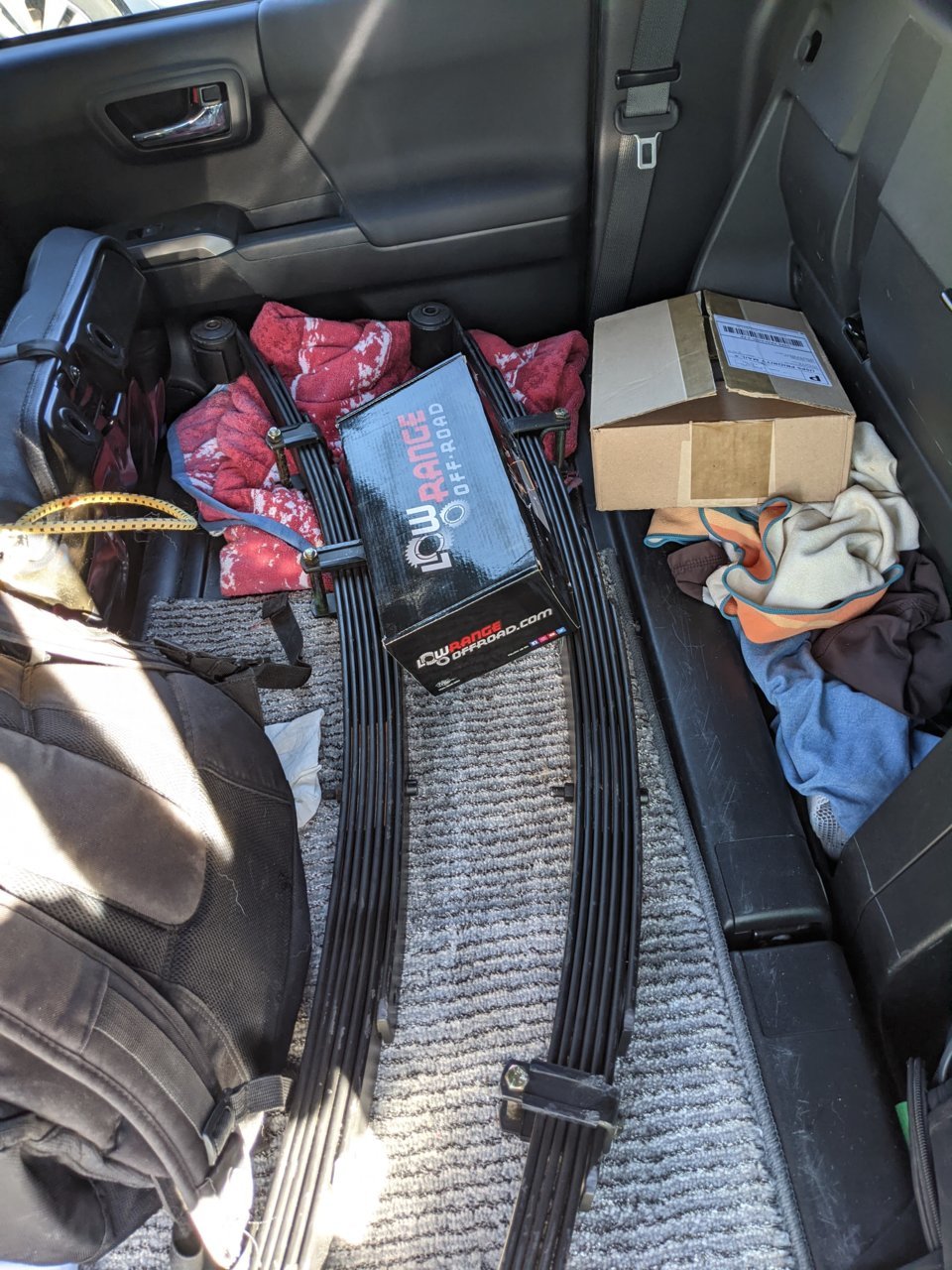

    About to put the westcott up front and RXT in the rear. I got the kit from wheelers but I'm not sure where they put the additional leaf. All 7 are together. Any idea? @Icon_Adrian ?PXL_20201026_191951304.jpg PXL_20201011_221939413.jpg

    The 158505's are shipped with an additional leaf and a hardware pack that consist of a center pin & nut, a galvanized liner and a spring clip.

    • Thanks, it looks like im missing the additional leaf. The box wasn't beat up enough for me to even take a picture, which I almost always do... It really looks like it was left out of the box. Looks like I'm going with option 1 until I can figure out what happened, I'm assuming this is still going to give me height and support better than stock with 400lbs constant?
    • I was going to install it on option 3, waiting for my BAMF dual swingout bumper which should bring me closer to 600lb constant.
