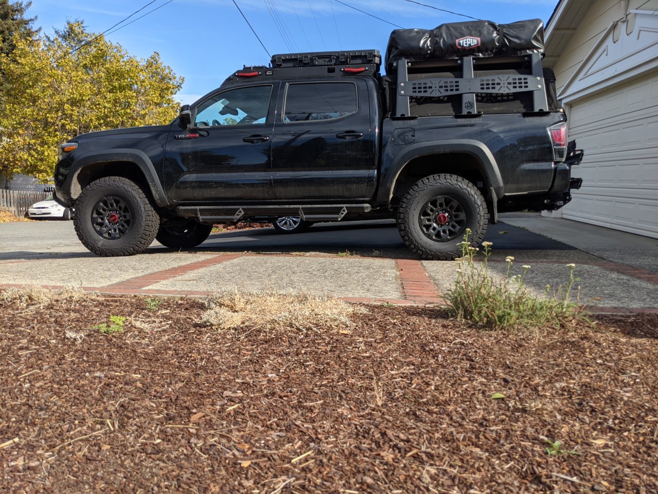

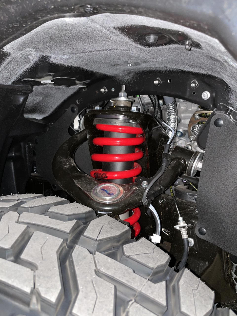

    Sorry for the bad photos. Just picked it up from the shop and it's dark out.
    2020 Pro
    Westcott front
    Revtek 1.5" AAL
    SCS BR6 17x8.5 -10mm
    Yokohama Geolander MT 285/70

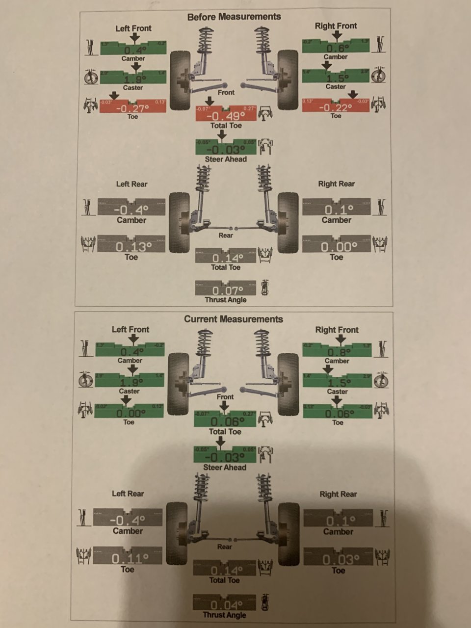

    Quick question for you guys, after having the Westcott kit installed, I thought i did notice some steering wheel shake in certain instances on the freeway. From reading other threads it looks like castor should be set higher then factory specs during alignment. Should it be higher?

    How's everything working out? Are you happy with the set up? How's your transmission liking the 285's? Power Loss? Fuel hit?

    So ended up ordering some JBA UCA’s and a ECGS bushing. After the Westcott kit and the Icon AAL, I’m getting bad highway vibes and steering wheel shake. Even after the alignment. I also have 32” inch tires so I’m guessing my castor is way to low for the lift now as it’s only 1.5 on both ends now. Hoping after the install of the new parts I get a smooth riding truck again!

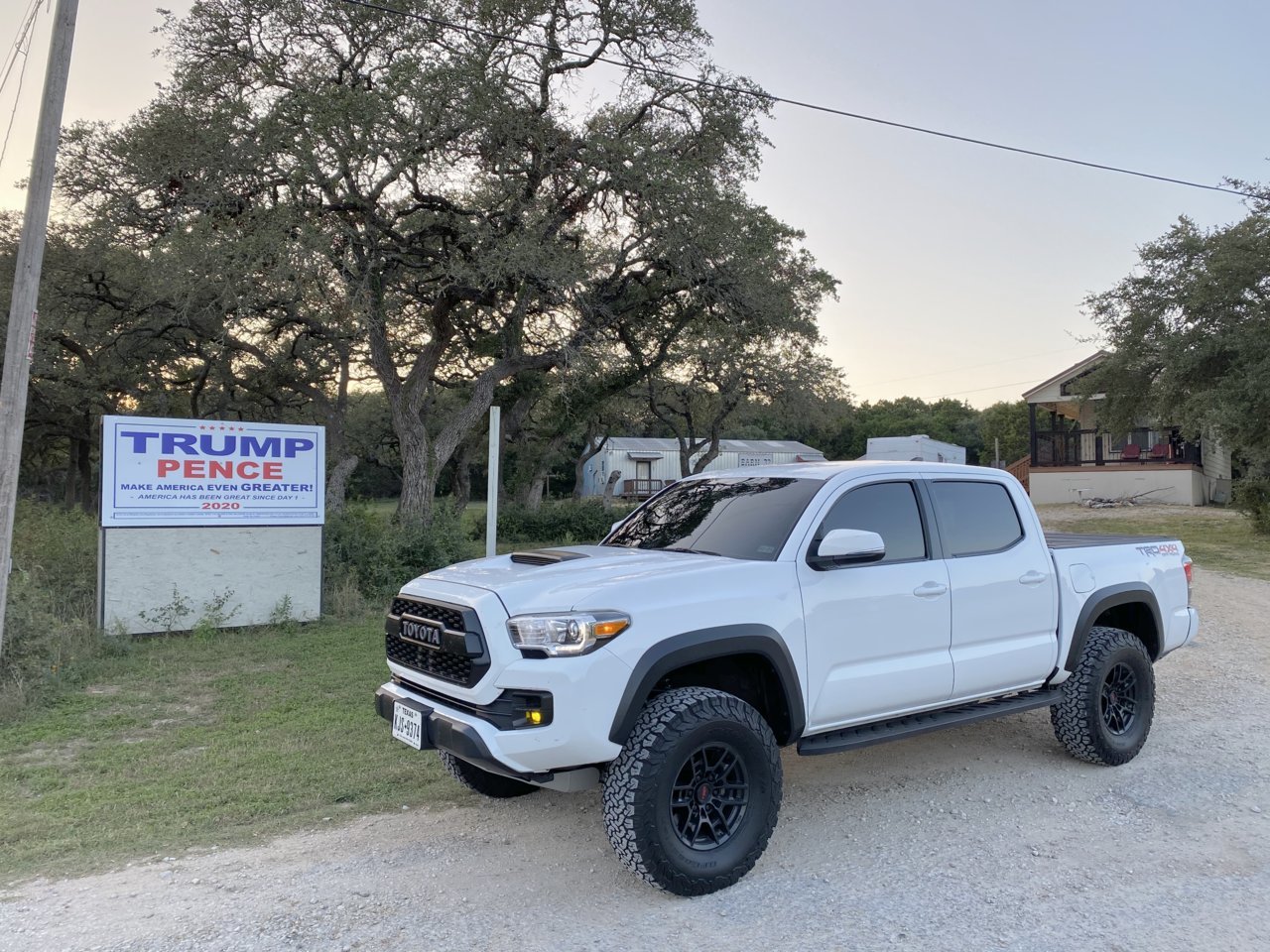

    2017 Tacoma TRD Off-Road
    Westcott/pro setup on 285s.

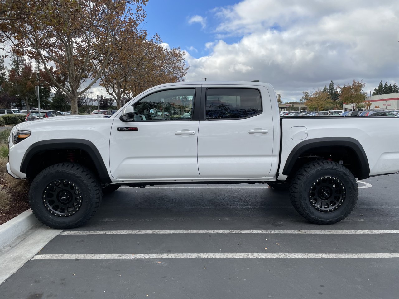

    Got the pro suspension with the westcott lift, I have 295/70, so, 33.5" tires, I chopped the cab mount and put a 2" AAL in the rear.
    Sits a touch low in the front, and rubs just a tiny bit when turning over a bump. Probably going to pull that .5" spacer from the top and add a 1" spacer. Should solve the rub issue, and level it out.

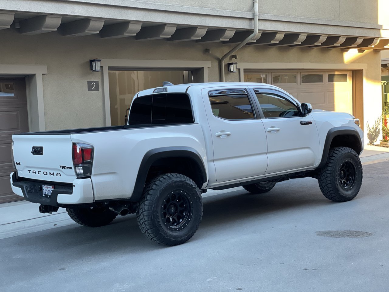

    Alucab Canopy Camper BAMF HC Dual Swingout Rear bumper BAMF Sliders Westcott 1.5" TRD pro lift Icon RXT option3 leaf pack Rago HD Shackles & Hangars BFG KO2 285/75/16 CBI T3 Aluminum front bumper Warn EVO 10S Total Chaos Bed stiffeners Home built Aluminum HDPE bed platform.
    Wescott up front, Icon RXT in the rear option 1 at the moment. About 450lbs on the bed.
    285/75/R16
