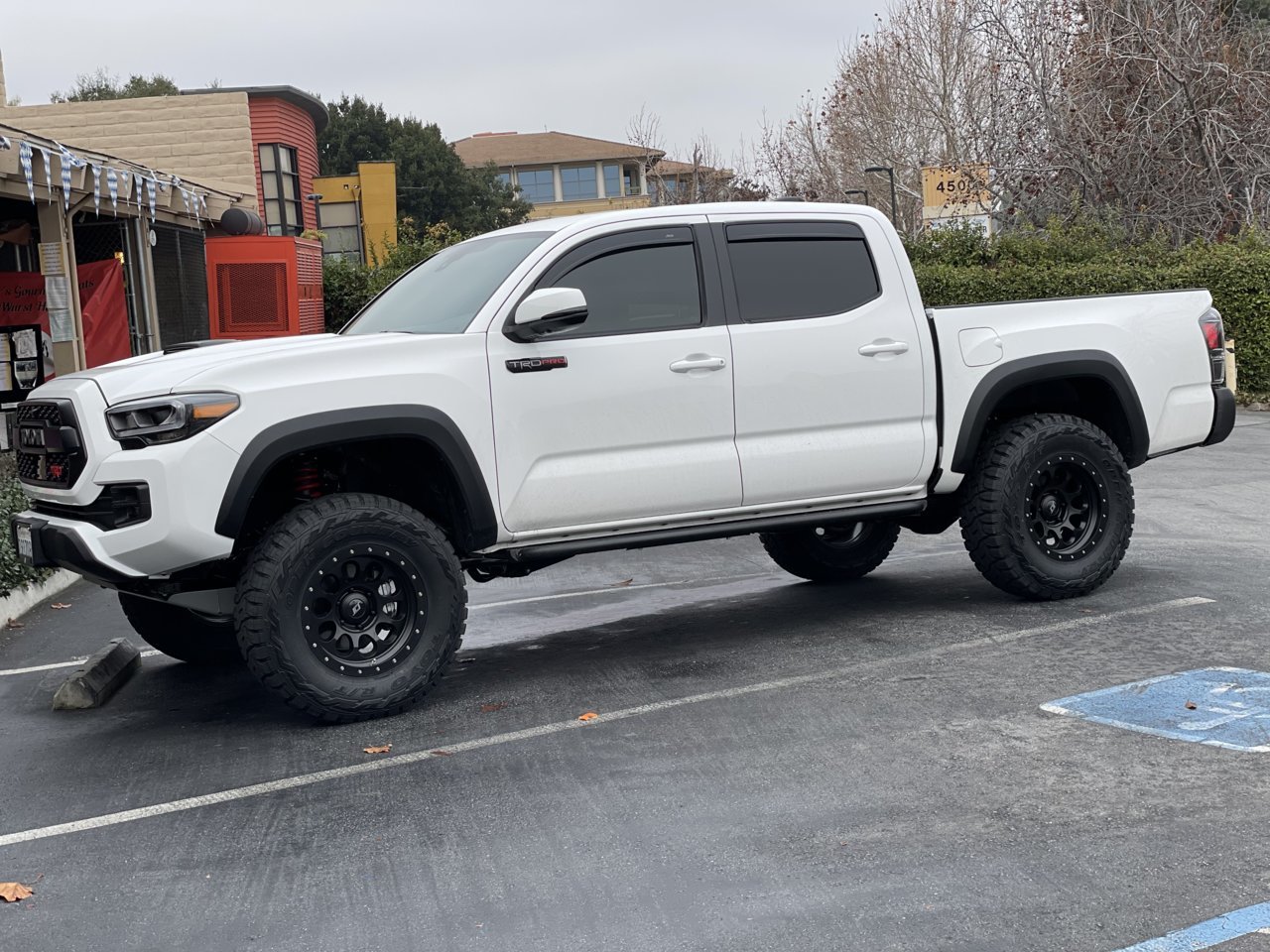

    Westcott kit
    AAL
    285/70/17
    No rub on pavement

    Harry
    2021 Taco TRD PRO
    I like this Westcott setup, but have you done a full articulation run and do they still not rub?

    Wescott lift Wescott rock sliders Prinsu Cabrack SpartanXcustoms skewp light Demon Hook front recovery point Diamondback SD (just shipped) N2 Designs Remote Start A few meso goodies
    I can verify no rub at full articulation. I’m working a travel nurse contract in Tucson right now, and I’ve been able to run some trails around here and Sedona, and the truck performed flawlessly. I just ordered some Wescott sliders, since his shop is only a little over an hour from here
