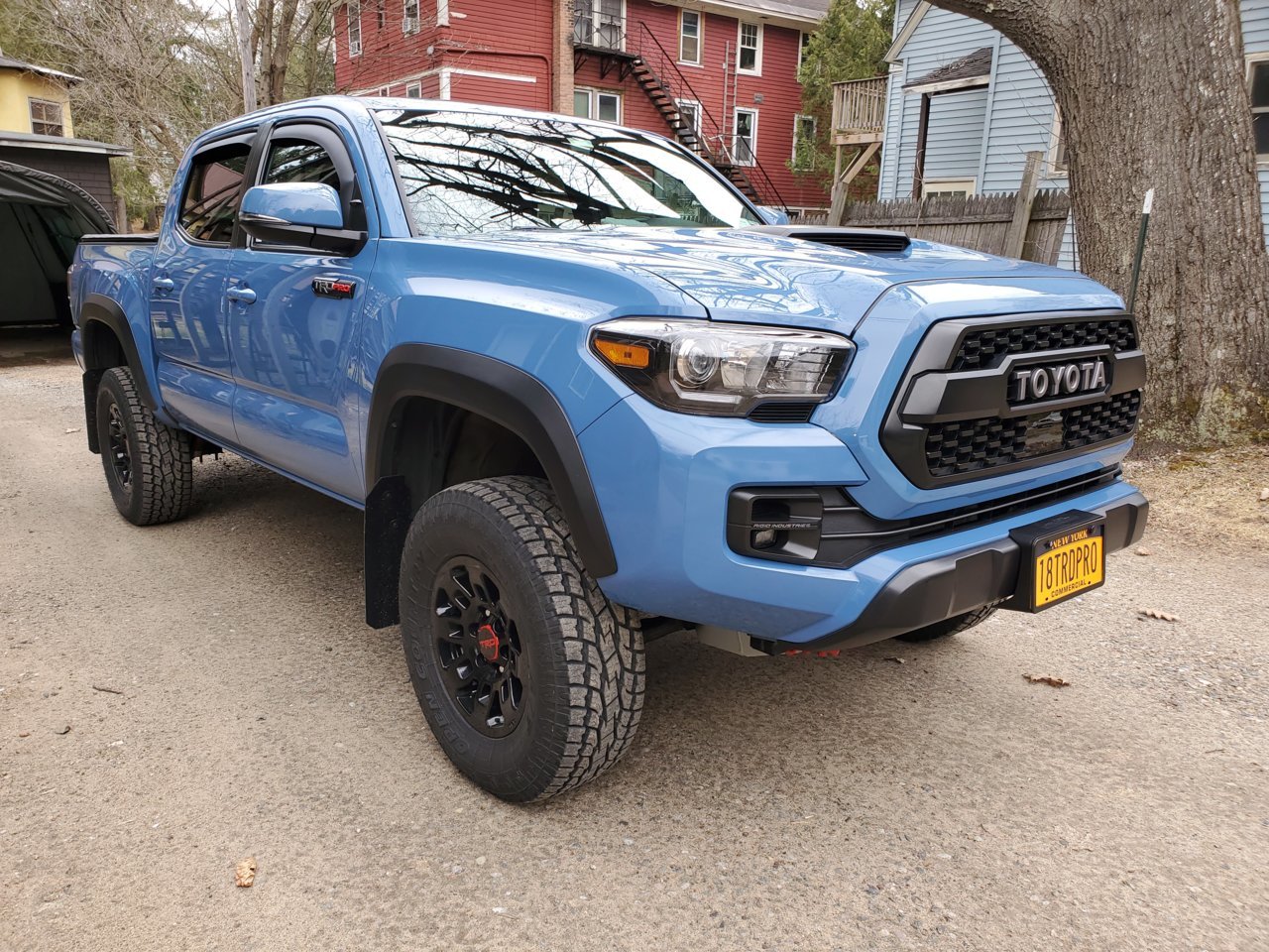

    2018 Tacoma TRD PRO. Calvary Blue.
    TRD Performance Air Intake. TRD Shift Knob. KTJO 4X4 Red TRD Push Button Start/Stop. Calvary Blue FOBIK by AJT Design. 12volt Solutions Remote Start with CAR:LINK Smartphone Remote Start and GPS app. Sprint Booster V3 Throttle Response Enhancer. AFE Silver Bullet Throttle Body Spacer 46-38010. 2" Supreme Suspension Lift Kit. TOYO 265/75R16 Open Country A/T2. EGR Matte Black In-Channel Vent Visors. REK GEN Offroad Mud Guards. AMP RESEARCH Power Steps. JDMastar 10000lumes LED Low Beam Lighting T1. JD Mastar Raptor LED Lighting. TRUXEDO Tonneau Cover.

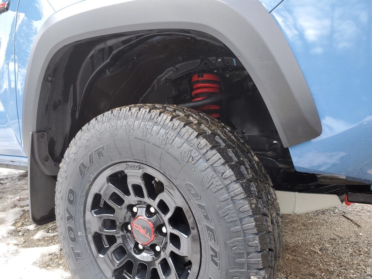

    TOYO 265/75R16 Open Country A/TII.
    Installed myself.
