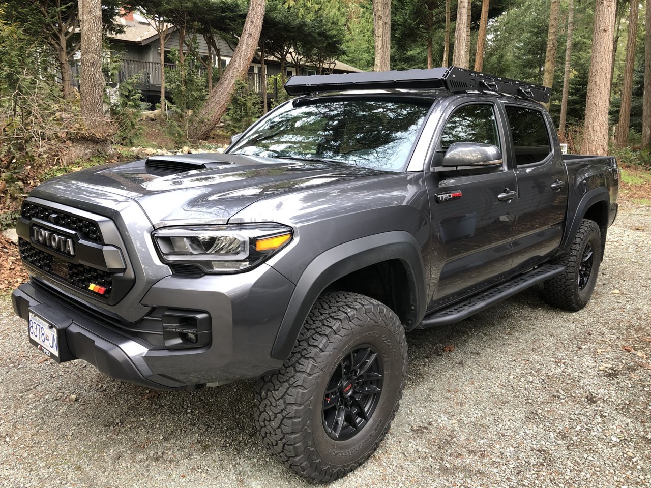

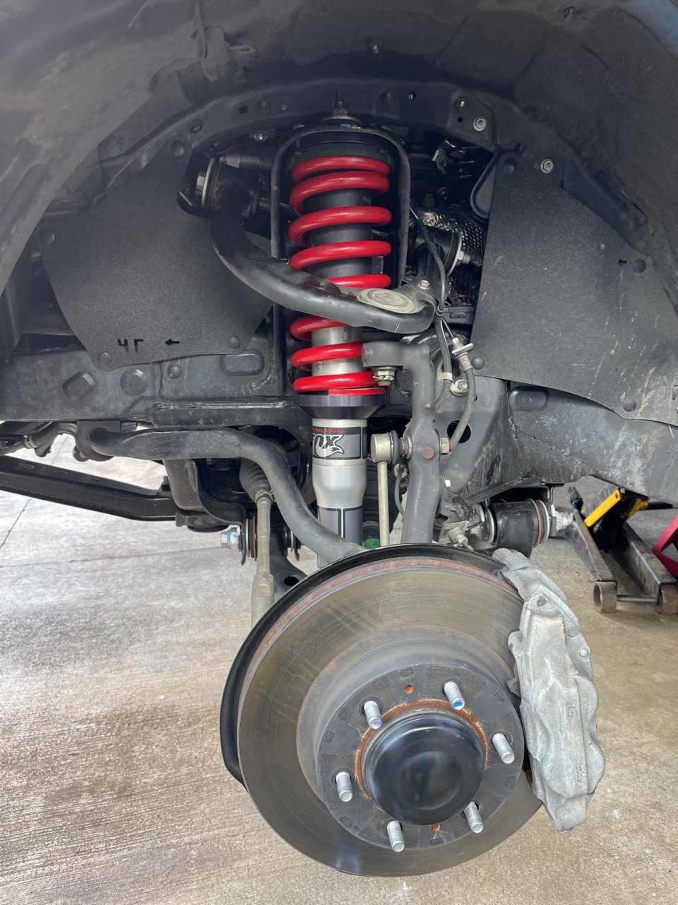

    I’ve had the westcott lift kit in the front for a couple months now, have been off road a few times.
    I feel that the suspension is a little stiffer, but by no means bone jarring.
    I opted for the Icon AAL in the rear over the blocks that westcott offers.
    I had my alignment done at the dealership, drives great, no issues.
    Over all, I’m really happy with the set up.704EE6C9-A400-451D-82BA-81268761A517.jpg

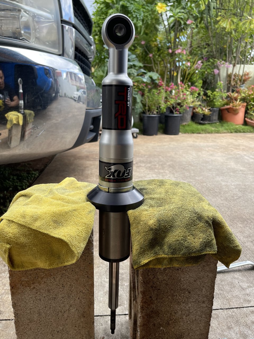

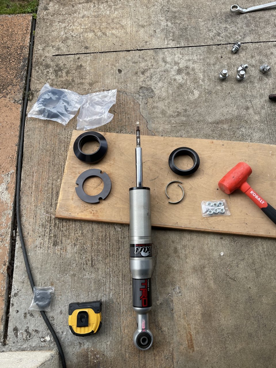

    RedLantern, did you happen to measure the length of the front coils after removing from the coilover? If so please post, thank you!
    Mahalos :thumbsup:

    Aloha @GOLIVER0131 !
    Sorry bro I didn’t measure the spring itself. It never crossed my mind. Hopefully someone sees this and when they do the lift, they can do a measurement on it.

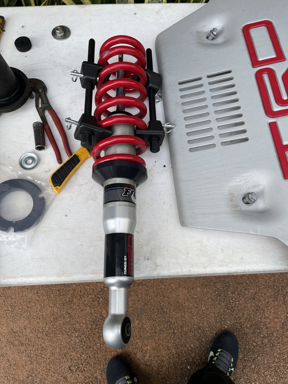

    Did those spring compressors mar the shit out of the shockbody ? Used the same ones Friday and once compressed it wouldn’t let me pull the shock out til I decompressed them .

    @mysubiewasalemon I rented a spring compressor to install my Westcott lift and it looked like it was rubbing the shocks pretty bad. I ended up removing/installing the springs by jacking up by the LCA. A lot safer that way in my opinion and I’m no mechanic.

    It looks like the rental ones from autozone . Yeah they rubbed my shock body so I didn’t get to finish .

    It marred a little on mines, not a lot. It was the only type the parts store had which sucked. But nothing too serious since I could knock it down with a little file and sand paper.

    Actually I’ve done this on my 2nd gen to decompress everything and for the install process. But that was with the stock suspension. I jus didn’t try because wasn’t sure if the preload was too strong to put everything back together. If I were to jack the LCA back into place to hold everything in, It might lift the truck off the jack stands because of the stronger preload.

    This is exactly the set up I was thinking about. What size tires are you running? Any rubbing?
  12. Mar 18, 2021 at 11:27 AM
    #552
    DHC6fixer
    DHC6fixer Member
    Nov 7, 2020
    #346093
    18
    Victoria BC
    2021 Tacoma TRD Pro
    285/75/R16 BF KO2's on stock rims,no spacers.
    Had to do lots of heat gun treatment to the front wheel wells, no front mud flaps.
    I get a tiny bit of rubbing in reverse full lock, left or right, can't remember?
    Have had it on moderate off road trails, no problems, very happy.
