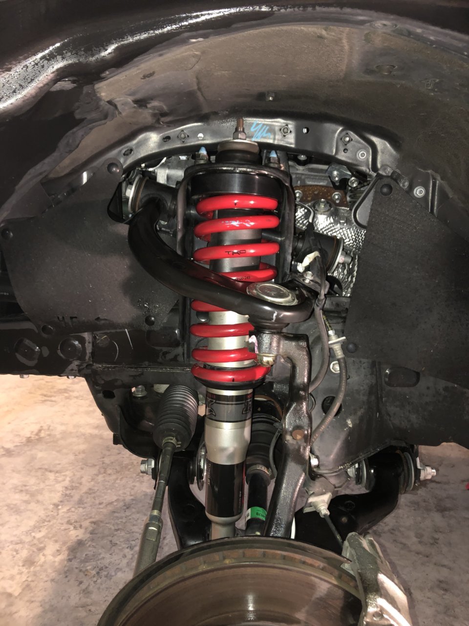

    Well I’m doing the lift today. Did one coilover last night, painted the spacers black with VHT epoxy. I like the black. Looks pretty low key. B9C15B9C-DC8C-4DEB-AA13-149379CC1644.jpg 19CE37D1-28EC-4664-9BE0-8B0224BF53AD.jpg

    Is anyone else not a fan of preloading the front suspension like that? Hopefully that type of lift does not wear out the expensive Fox shocks prematurely.

    I’m not really a fan of preload spacers, but cranking the collar on adjustable coilovers has the same effect.

    Not true. The PRO shocks are entirely different than aftermarket coilovers. Spring length is different. Preloading the PRO shocks is a bad idea

    I guess I’ll find out since I’ve already done the install. :)

    Quit listening to what everybody thinks,put a 1.5 inch spacer up fronton top of the coilovers ,and a 1-2 inch STEEL block or AAL in the back,and done.
