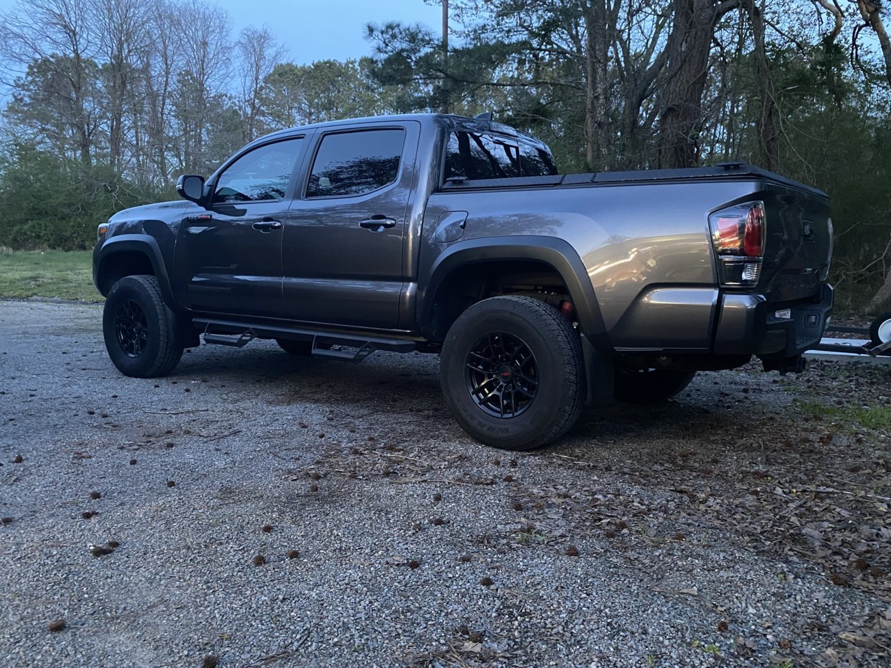

    Here’s a pic of my Tacoma with the Westcott front kit and Icon AAL in the rear (overload spring removed). Bed is empty w/ Diamondback SE, if that matters to anyone.
    I was at a bee’s dick over 21” all 4 corners prior to lift (maybe slightly under 21 1/8”) and am now at 22 3/4” all 4 corners.

    This is looking more and more like the way to go. How’s the ride with this kit? Especially the front?

    Granted I’ve only driven 20 miles or so since, but it felt great. I have no complaints. I’ll get more time behind the wheel on Friday and will have a better feel for how it compares.

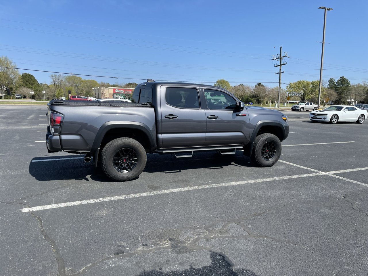

    Here’s a better pic. I’ve driven a few hundred miles since the install. Very happy with the ride quality both front w/ the Westcott and rear w/ Icon AAL.
    Yes, I know I still need bigger tires. I’m still deciding how I want to go and am not really in a rush. So you’ll just have to deal with the tiny tires. HAHA.
