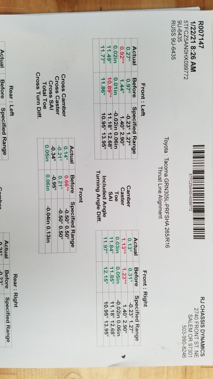

    I'll try to find the alignment sheet.

    I emailed Westcott Design. They said their TRD Pro lift does not affect geometry and does not need an aftermarket UCA. It will fully align to manufacturers specification for caster, camber and toe. Also, they said you can choose to not install the top plate and only install the spring pre-load insert. It’ll give you 1” of lift.

    It will absolutely effect geometry, it's a lift. It may not negatively impact geometry because there is enough adjustability in stock components to compensate (i.e. aftermarket adjustable UCAs not required). But to say there are zero effects is untrue.
    Glad they responded to you, I got nothing when I reached out. And that is exactly what I wanted to know...what is the amount of lift with only the perch.

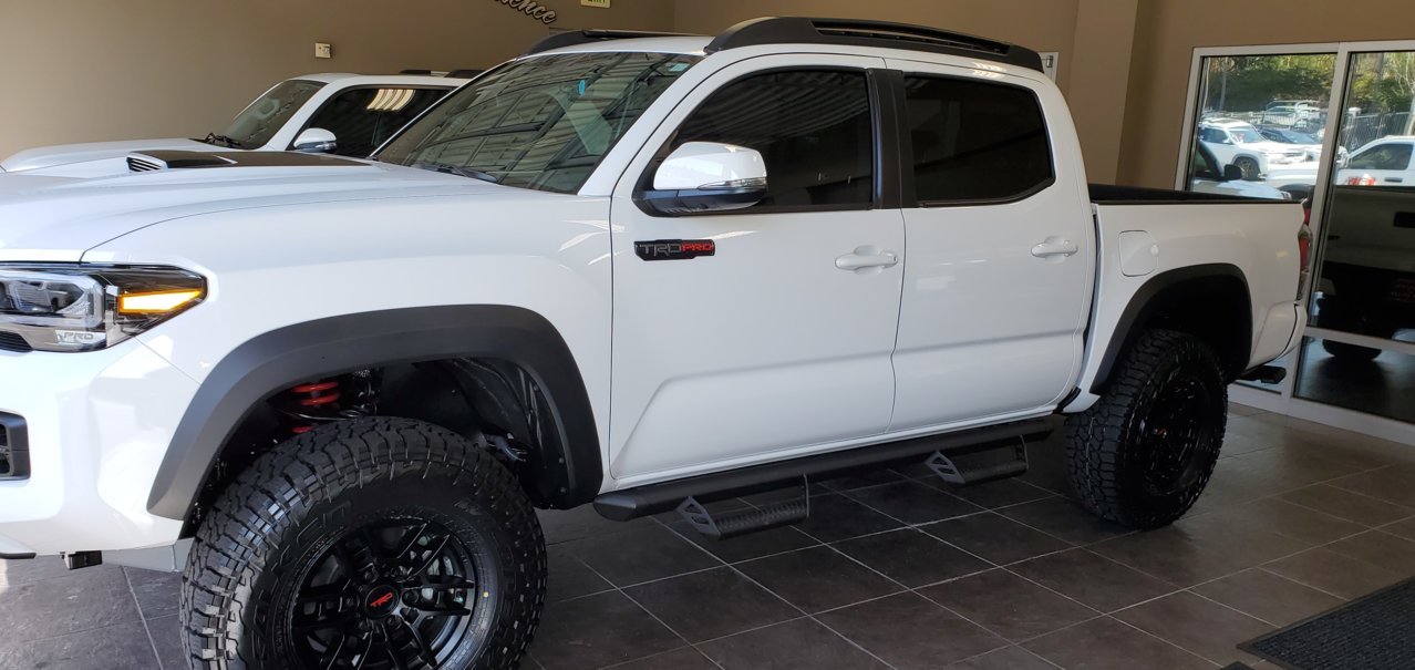

    Dealer installed the Wescott kit and Wildapeaks 285s... Love the look. Just noticed though that the mudflaps are gone. Live in the PNW and these are pretty helpful...
    Anyone else see rubbing on the flaps? it's either that, or they forgot to put them back on.

    Interesting... I just got a 2021 Pro with the wescott kit and 285/75/16 Wildpeaks... came with flaps off. Asked dealer to put them back on and they said it would rub.
    Just ordered some Tufskinz to try...
    but your saying yours doesn't rub at all?

    My fronts rubbed but I have 1.25" spider tracs spacers. Maybe thats why. Rears are fine.
