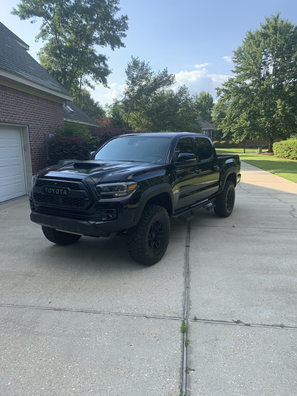

    Chuck
    2021 Black Tacoma TRD Pro
    I installed both the perch and spacer. 1 5/8” lift up front. I installed a 1 1/2” block in the rear for a 1 7/8” lift in the rear. I lik the result.

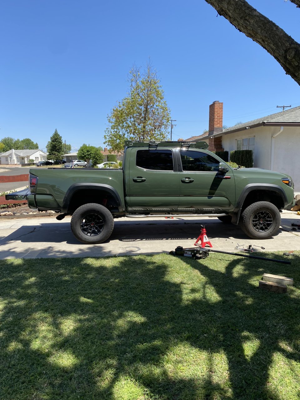

    Edgardo
    Army Green TRD Pro 2020
    Here it is. Westcott up front and Deavers stage 3 for the rear.

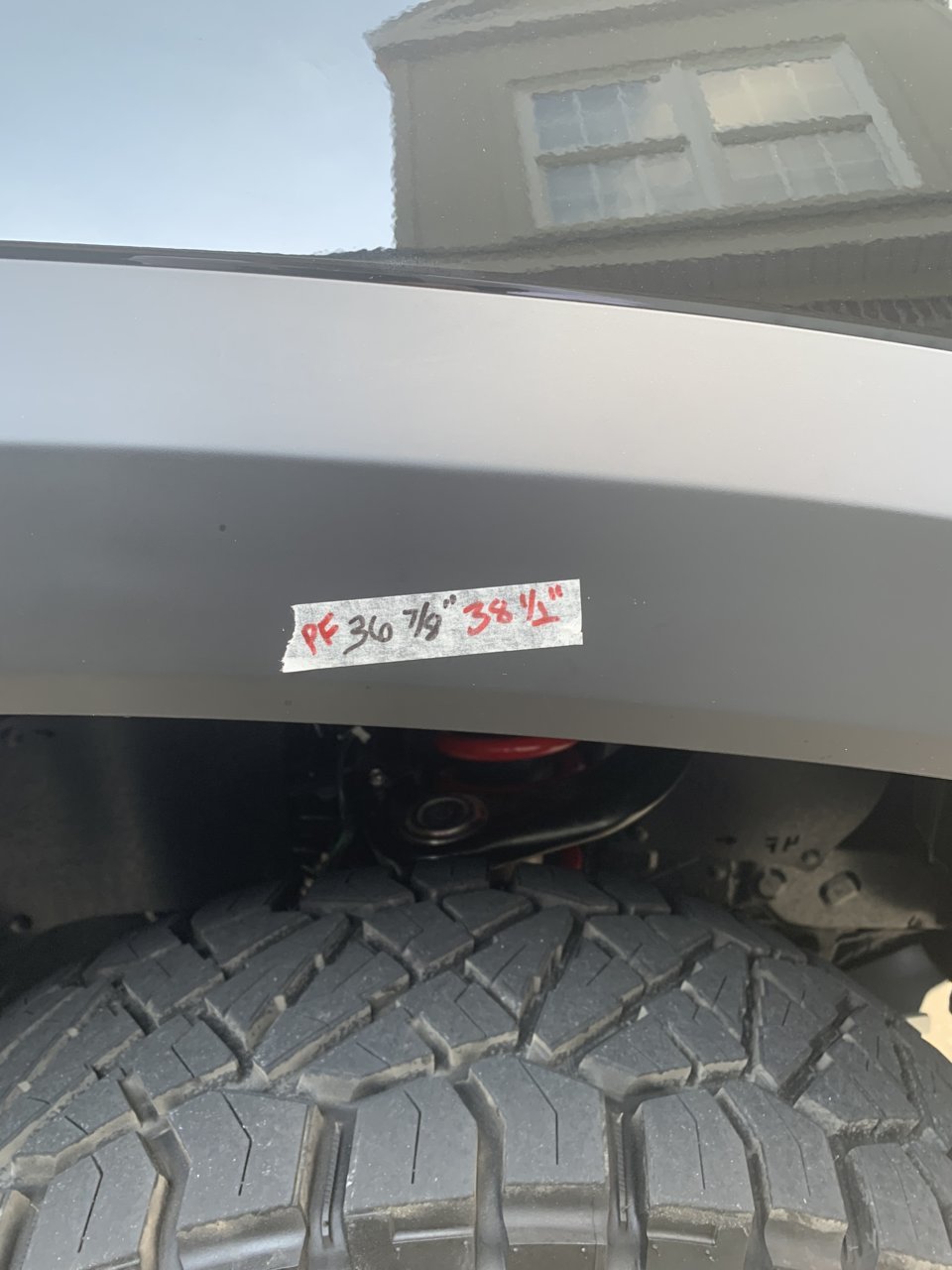

    Chuck
    What tires are you putting on? Your Westcott lift looks higher than mine.
    Passenger Front. Black numbers is the height from ground to fender prior to lift. Red numbers are height after the lift.
