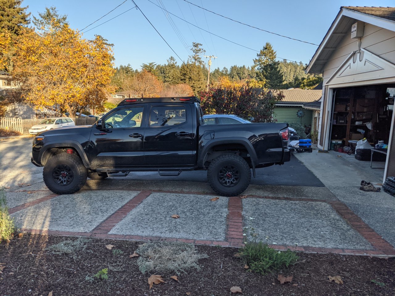

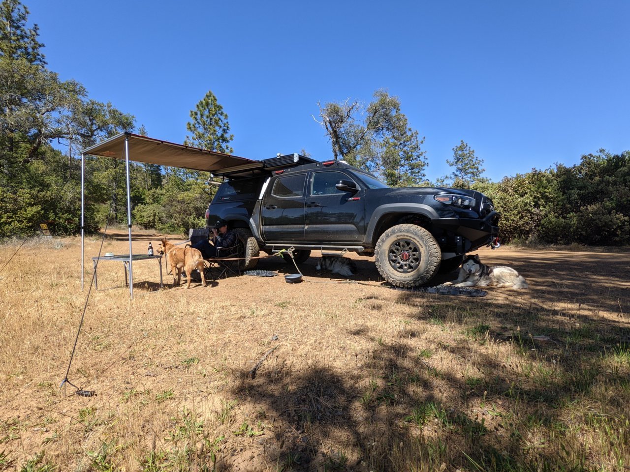

    Kinda reposts from earlier in the thread but highly recommend wescott in the front, RXT option 1 no weight in the rear or option 3 with really any weight in the rear.
    If you plan on a shell, bumper or rack and tent I would just go straight to option 3, if it's too much rake just throw 2 sand bags in the bed. It feels better than stock.
    The weight I have definitely isn't a better ride than stock, haha, but I did everything in steps so I could figure out what each component did before and after.

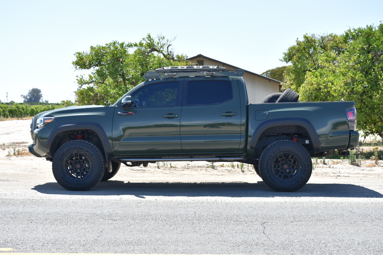

    Lifted and new shoes. Finally! :rofl:

    That looks awesome! How do the stage 3’s ride?

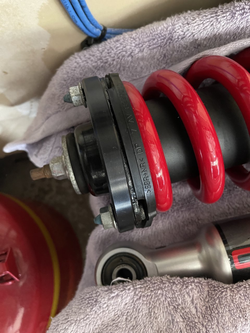

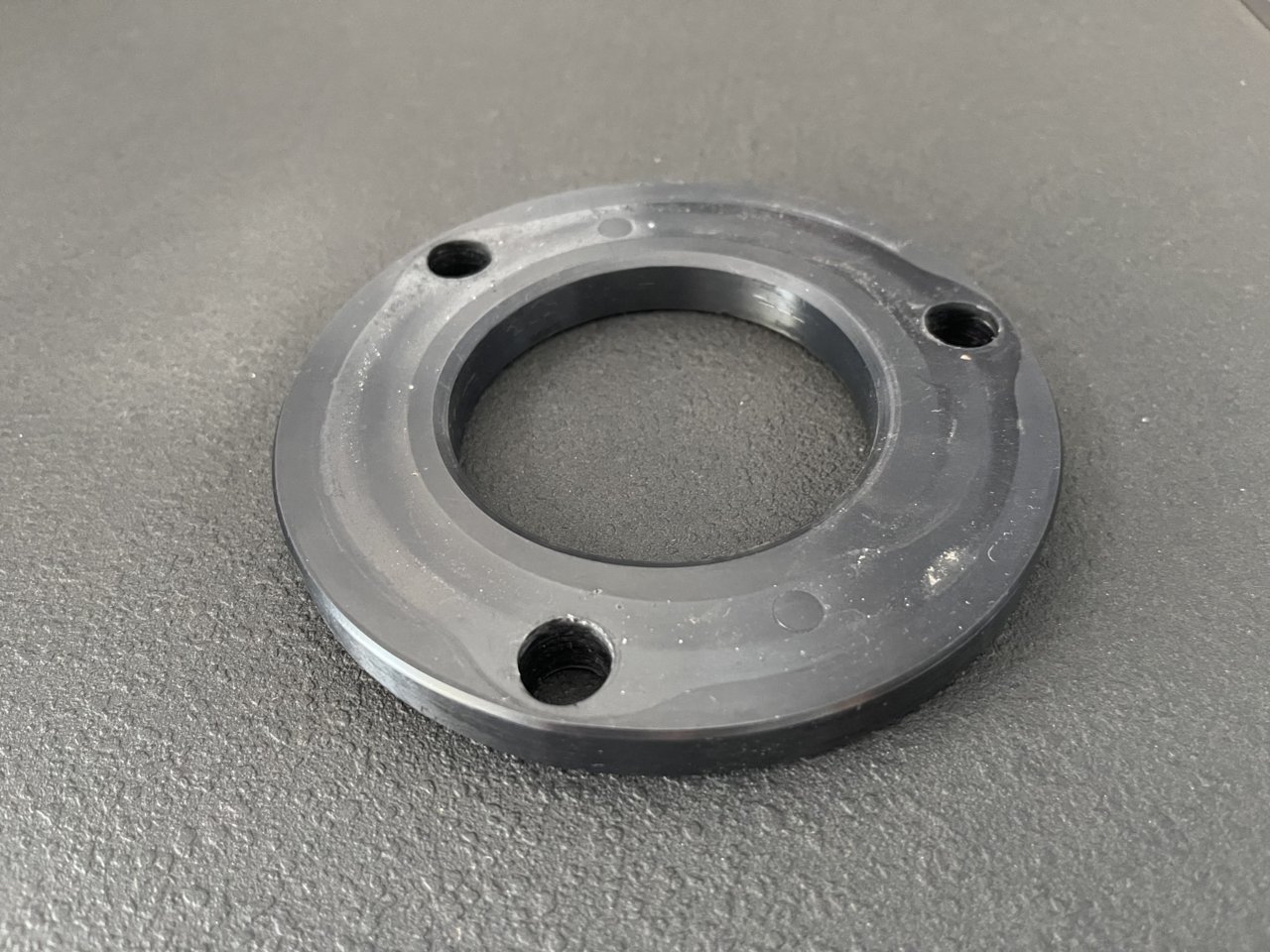

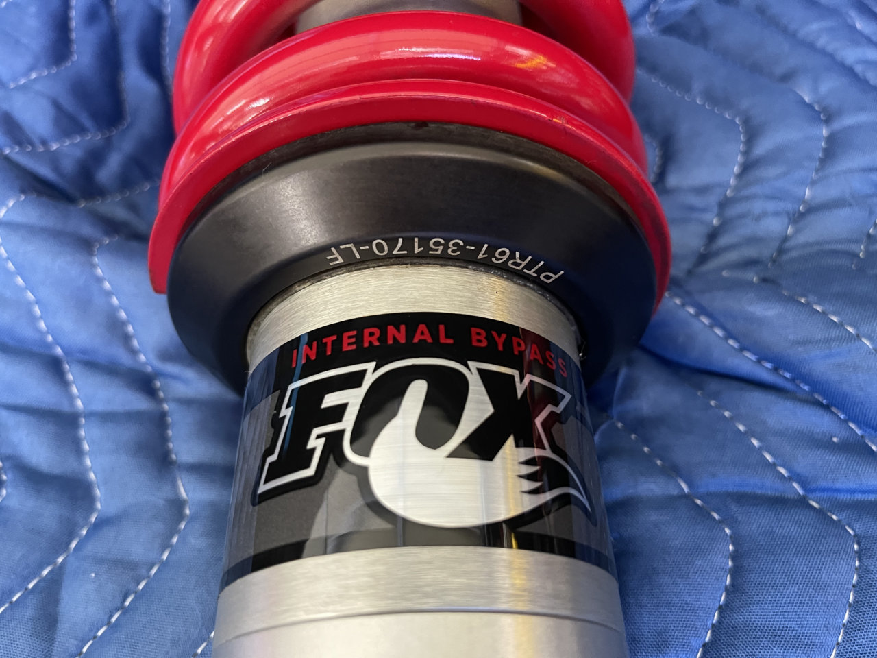

    Hey Guys, I have a question for all of you that have lifted your trucks with the Fox Pro shocks. I bought a pre-owned set of Fox Pro shocks from a guy locally. It looks like it already has a spacer on the top hat of the coilover. Not sure if it should come that way from the factory. Can anyone confirm? Pics attached. Also it looks to be made of a hard nylon type of material. I wanted to buy the headstrong spacer mentioned in a few posts prior but will this spacer (if it is one) work okay?
    Thanks!

    is it possible it already had the wescott lift installed on it?

    The bottom seat has the factory part numbers on them so I don’t think so. I wish!

    Does the Westcott lift have those nylon spacers?

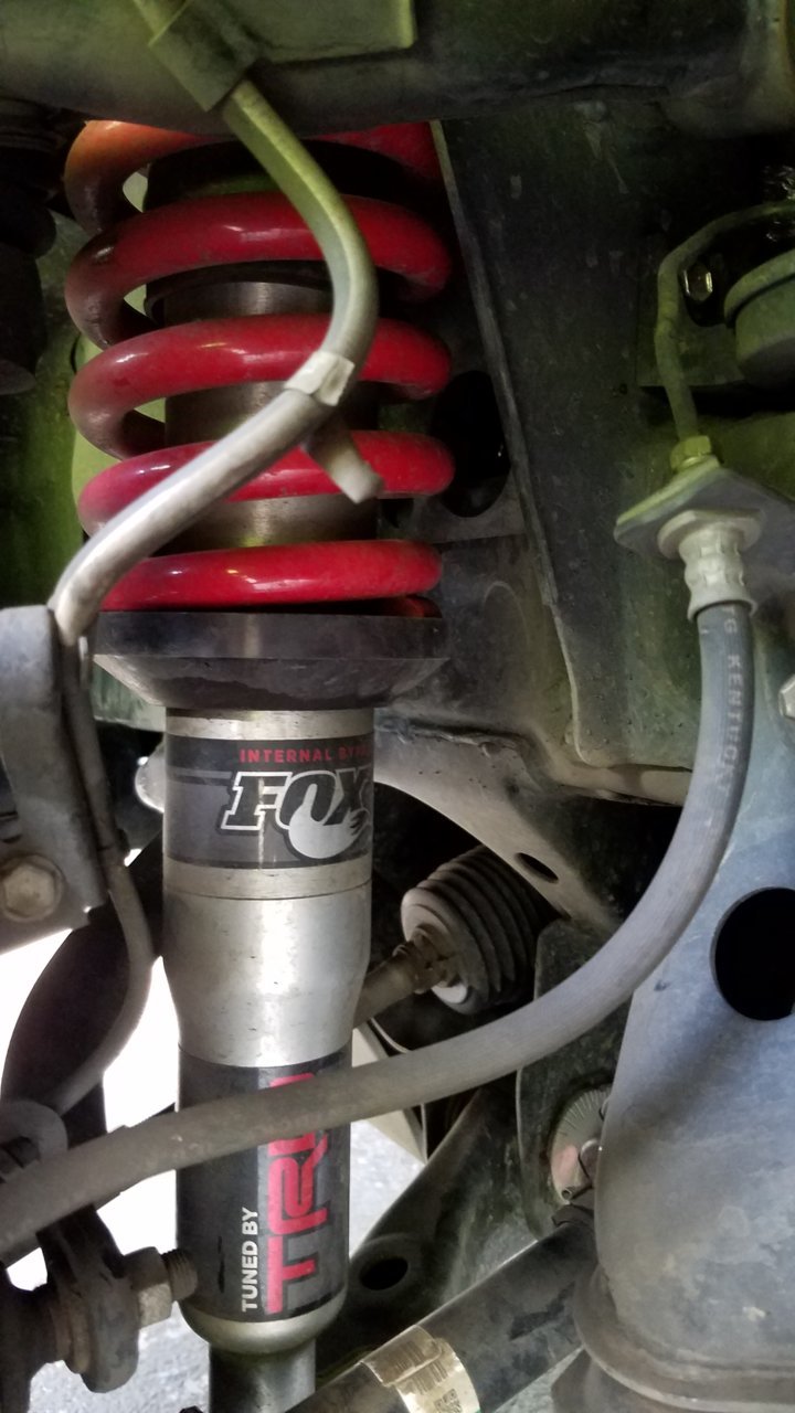

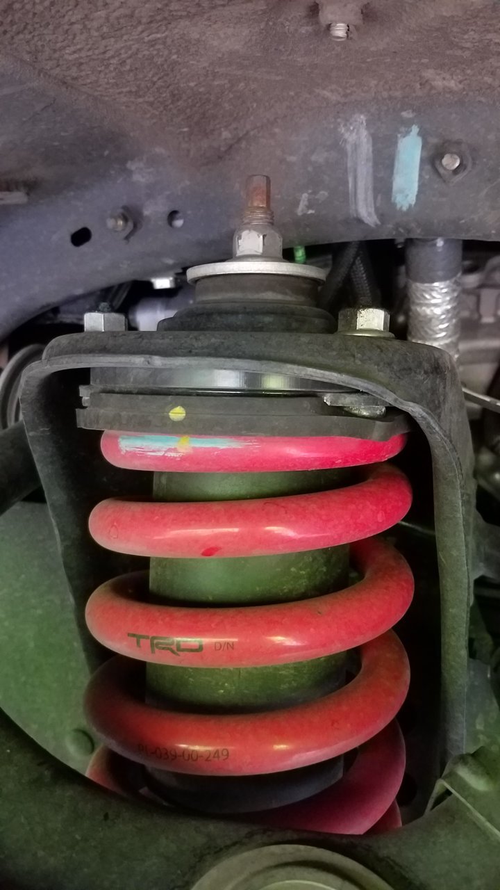

    Here is my 2017 with Wescott. Both top and bottom are Aluminum.

    No. Metal

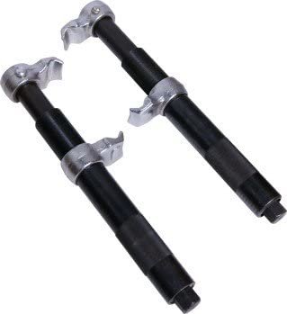

    Those are exactly the compressors they use to do UTV race coils, been really interested in this.
    They worked good, huh ?

    Like I said, if the applications allows for them, they are my go to compressors. Haven't had any issues.
