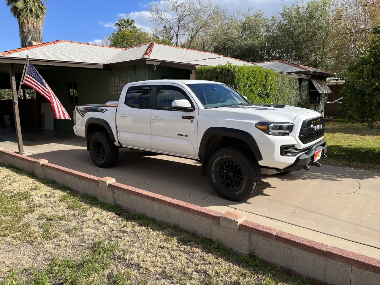

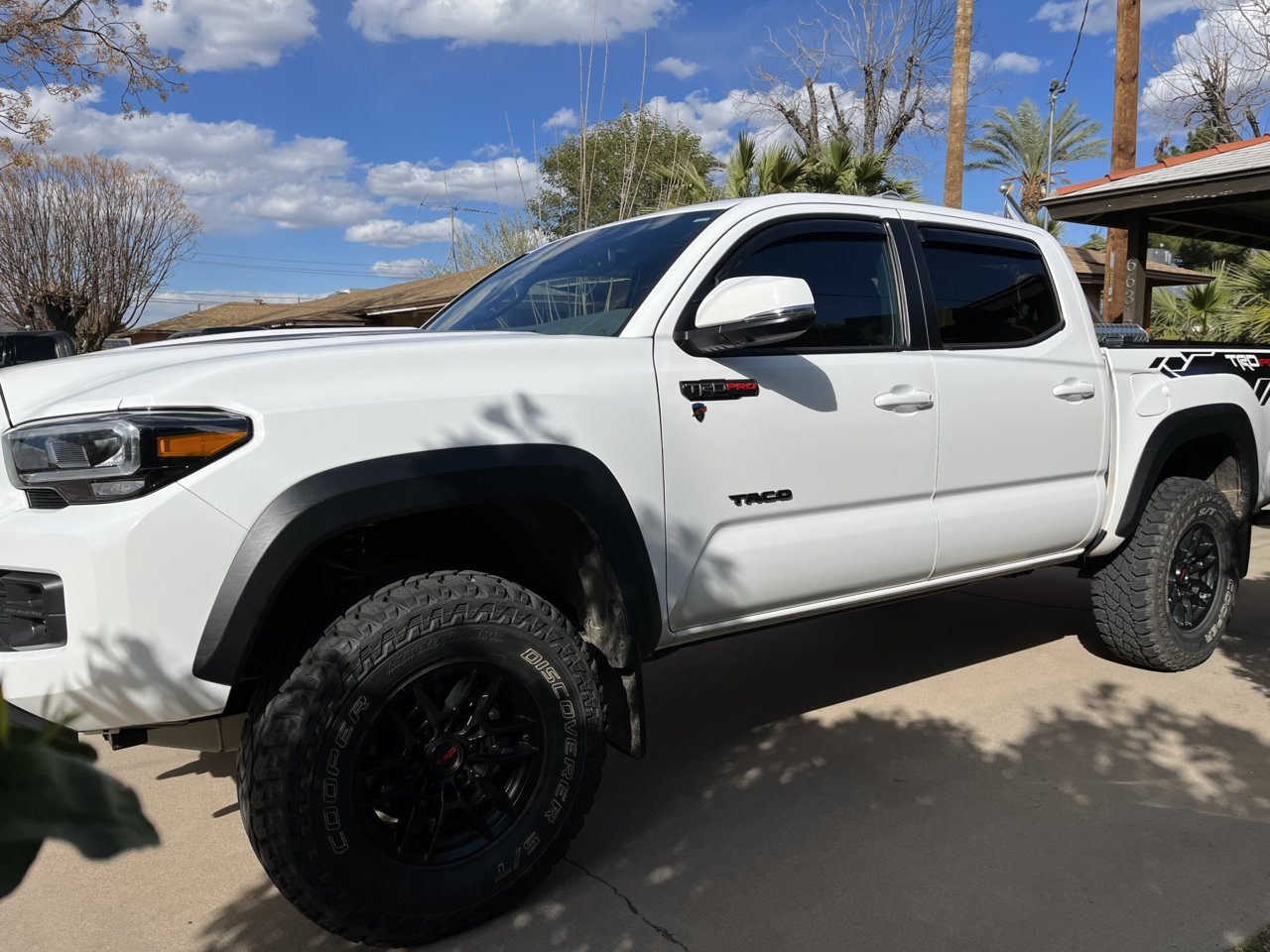

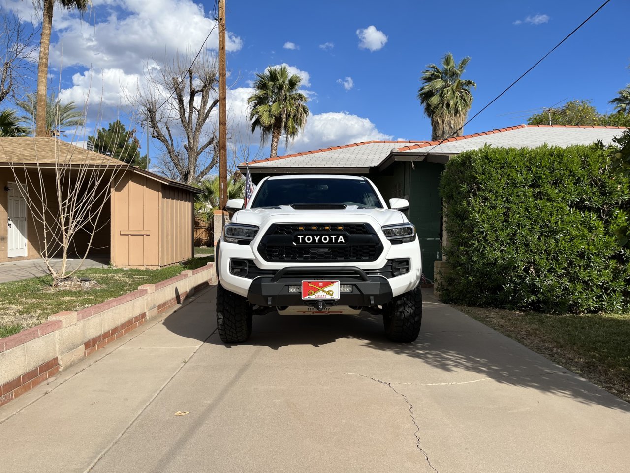

    7FAA88CD-0770-4E4C-9D18-359302B94572.jpg CC090510-0548-4435-9BF7-2C682F717F7A.jpg Just got home with the Westcott lift installed by their shop today. Love it! Taking it out camping next week and will put it through some paces. Rear blocks for now, probably get the Icon leaf packs in a year or so. Running a Body Armor 4x4 bumper with Warn VR EVO 8S winch. Front lifted 1 3/4, rear lifted 1 1/8. Happy with my 32” 265/75-16 ST MAXX tires. Next on my list are the sliders from Westcott.

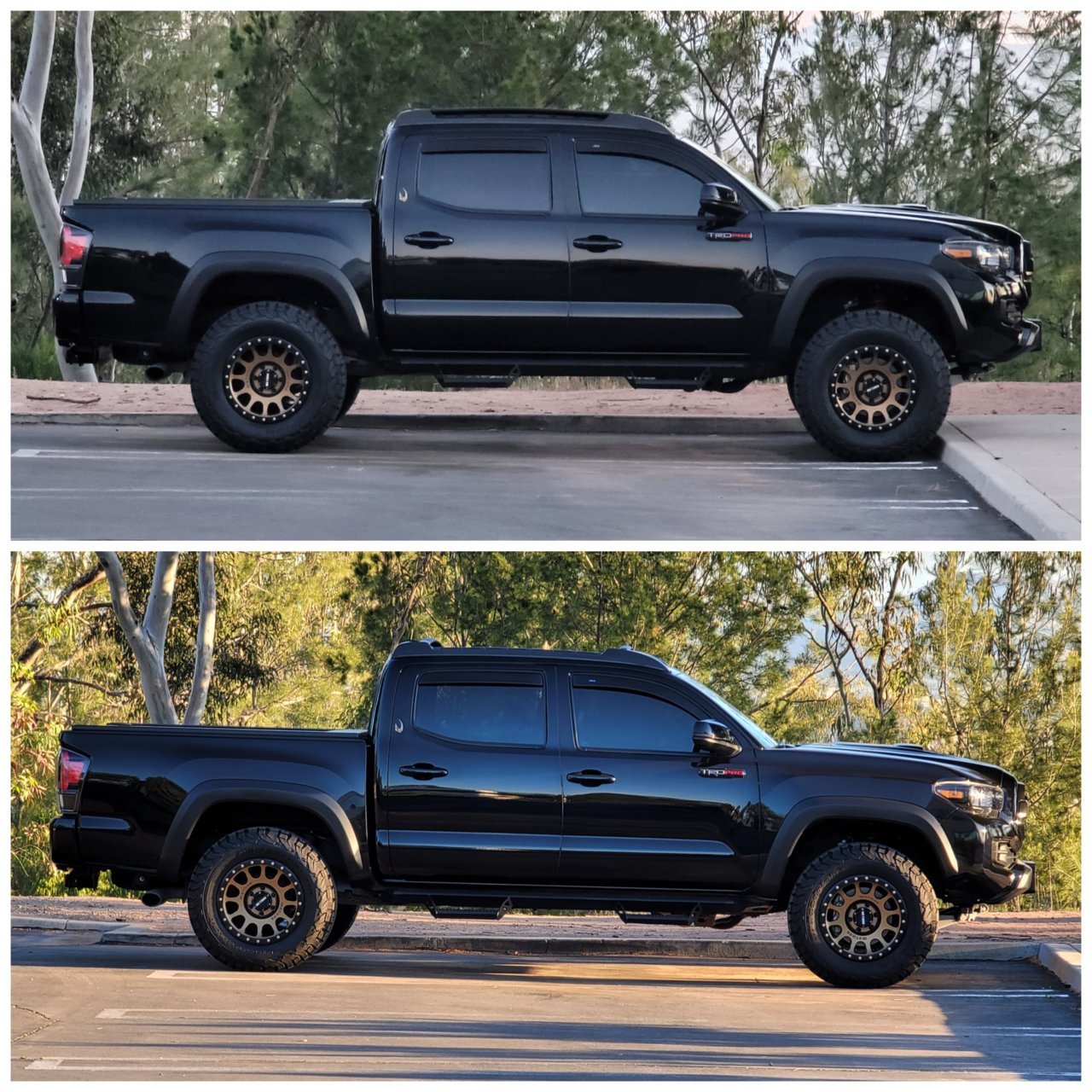

    Before and After
    265/70/17 Stock suspension
    285/70/17 Westcott kit 1.5" Front, 1" Rear.

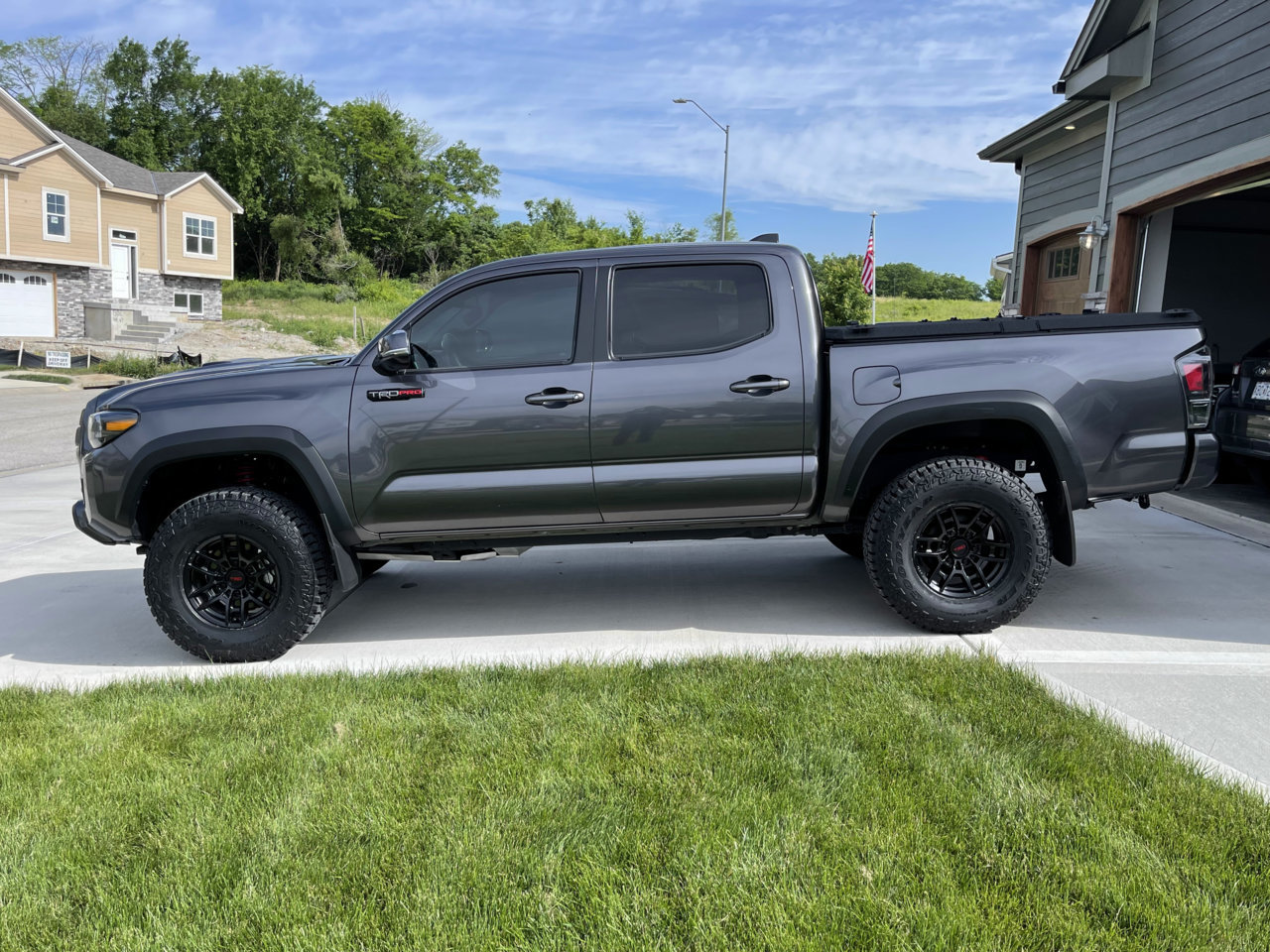

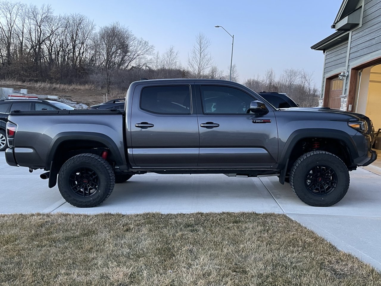

    First pic is Wildpeak AT3W in stock size 265/70/16. Second pic is Goodyear Ultraterrain in 265/75/16
    Westcott lift in front and Headstrong 3 leaf add a leaf in rear. (note the headstrong is better than the icon IMHO, no clip cutting and its threaded for brake line mount)

    How are you liking the ride with the Ultraterrains and new lift?
  18. Jun 13, 2022 at 11:52 AM
    #738
    gregnauman
    gregnauman Well-Known Member
    Jul 2, 2020
    #333209
    472
    Greg
    2020 Tacoma TRD Pro
    None
    Honestly so far the ultraterrains ride better than the wildpeaks in stock size. Maybe it’s the taller sidewall.
    So far I really like them and they are now cheaper and lighter than the Wildpeak. $189 for the Goodyears and they weigh 40 lbs
    had the lift on for both. Rides great.
