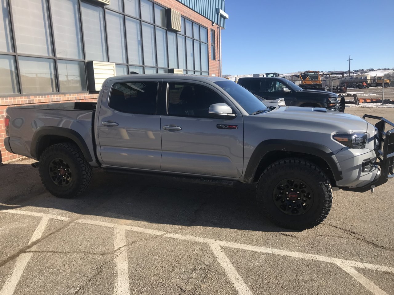

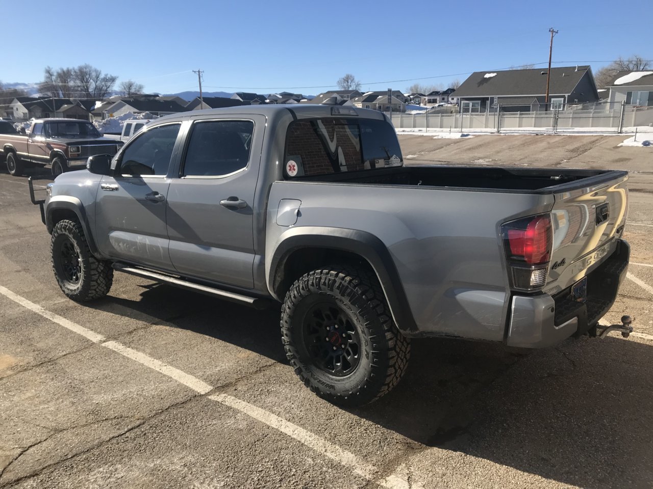

    Pics stock with 285 duratracs

    Thanks, truck looks perfect!

    I see you removed the mud flaps...does it rub the cab mount or any of the plastic at the front?

    It doesn’t. It’s close but hasn’t rubbed yet. Yeah the mud flaps got ripped off with stock tires

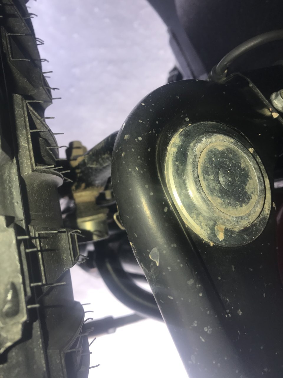

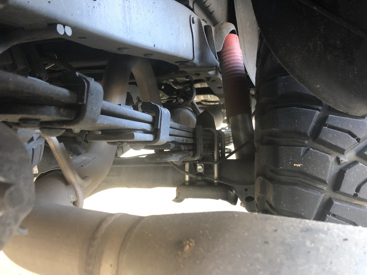

    Thanks. And the 285s clear the uca ok?

    Yep. I can take a picture in a few if yah want

    Still lots of room

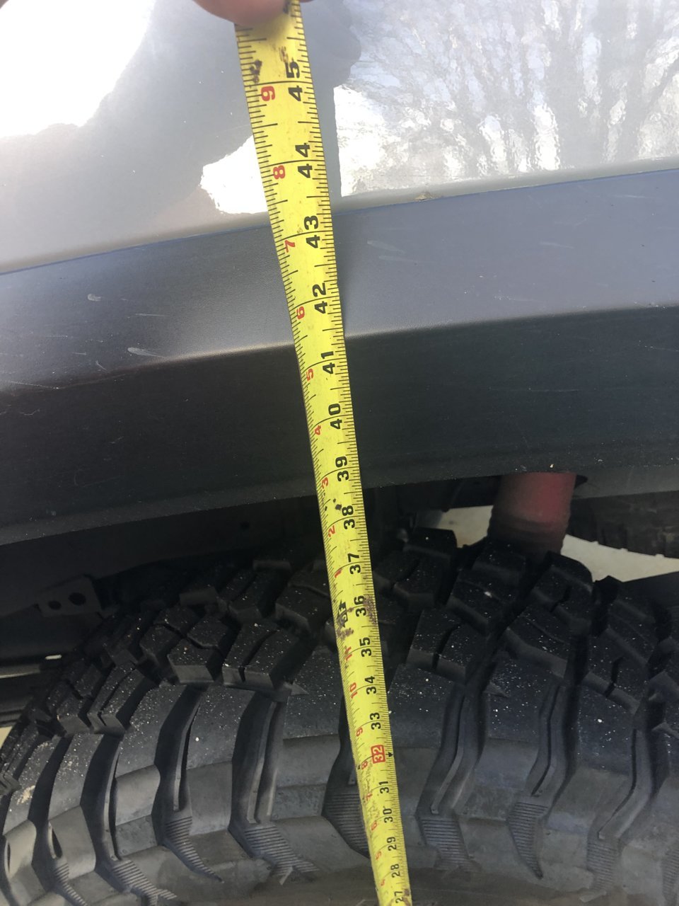

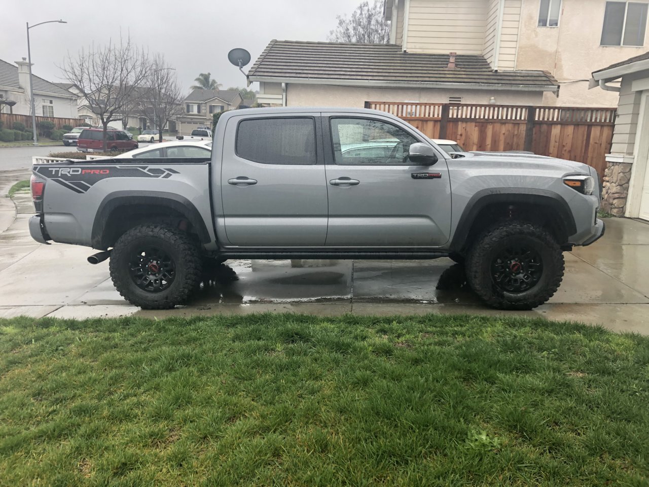

    this is before Revtek lift on 285/75/16

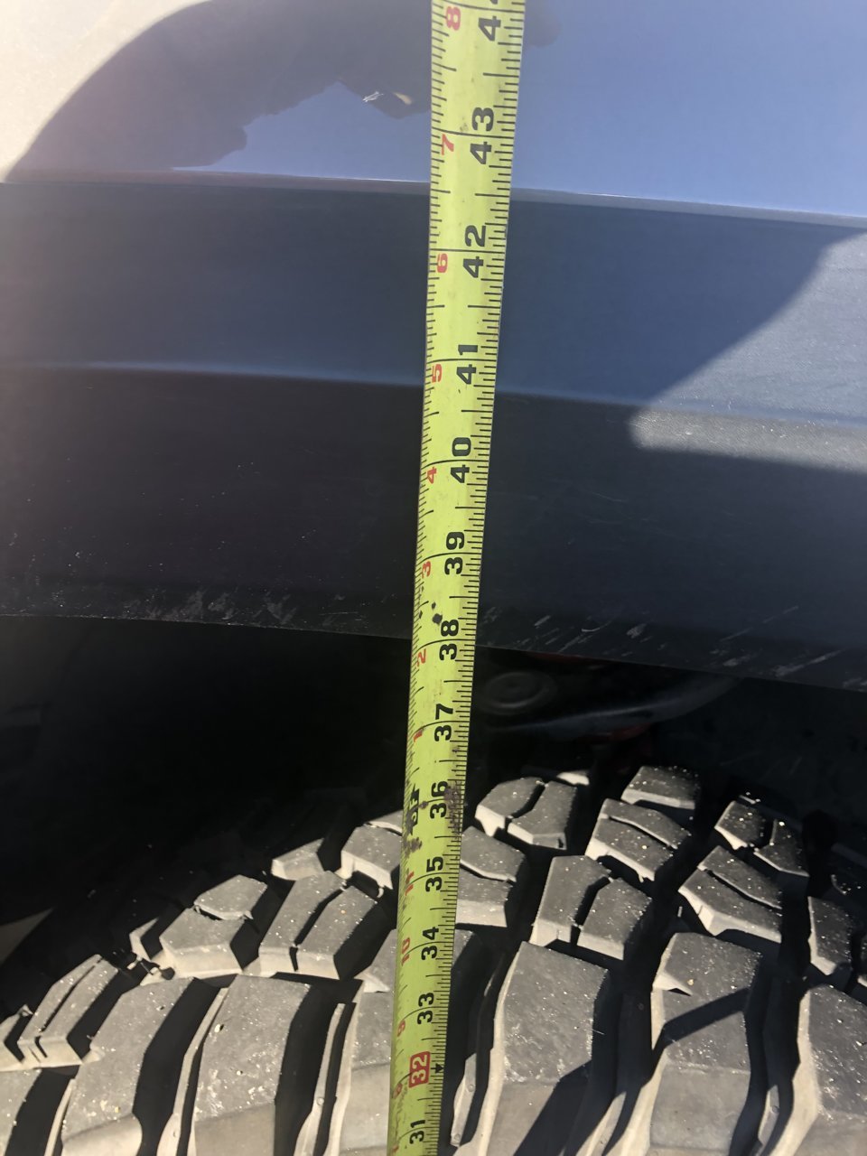

    this is after Revtek lift about inch and a half up front and two inch in rear could be the driveway

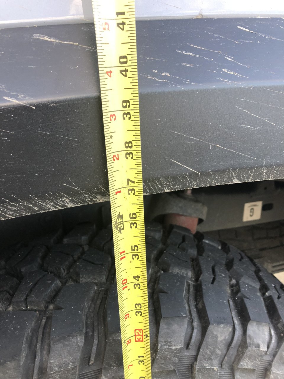

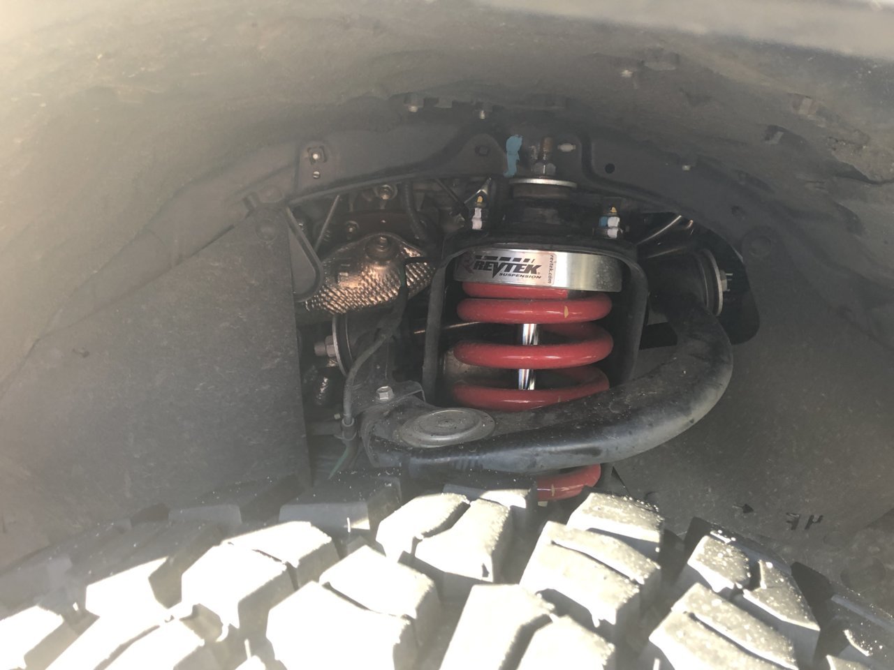

    D71E37E1-C8AC-4AAA-831D-273A96D885D2.jpg 92AC072E-9C92-423B-8EEB-54023562B53B.jpg B8CF8376-A9C5-4FF3-90E1-2F04D8CB7EFF.jpg. I like the way it drives and looks would recommend to anyone. With tires 285/75/16 KM3’s and Revtek 427AP around 2 1/2” taller than stock PRO. Thanks OP for the info would not have known without your thread. Happy trails
