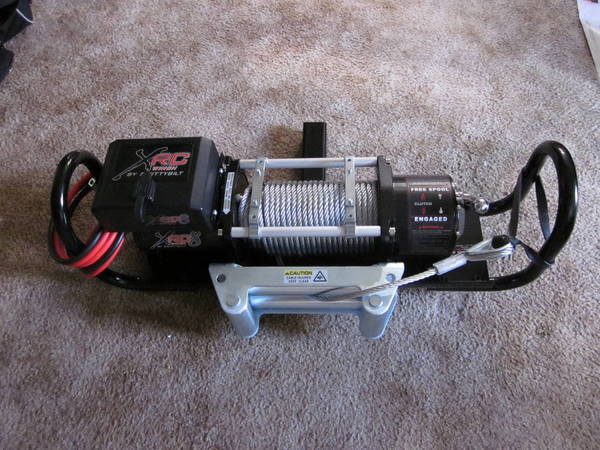

    i just ordered the cbi front mount....
    curt also makes a front hitch but you will loose some ground clearance....
    the cbi one comes out behind your front license plate....no ground clearance lost
  9. Jun 19, 2010 at 10:12 AM
    Barnone
    Barnone Guest
    I don't understand why a receiver mount on the front would be any different.
    I had a front receiver mounted winch on my Dodge with long jumper cables so I could use it in the front or rear receiver.
