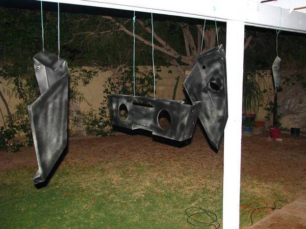

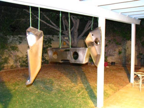

    Also some kind of line or wire to hang the two side pieces and the middle section up. I couldn't imagine painting these on the ground. The lower part of the bumper is too heavy to hang in my opinion and I didn't need to do it.

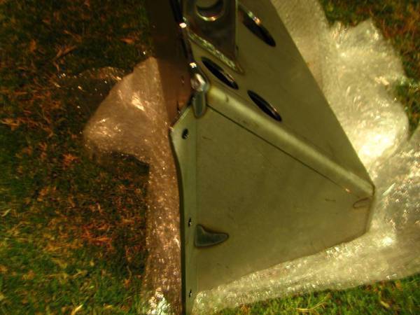

    To start, make sure you inspect the bumper for any bent pieces from shipping (UPS was a little too rough on the package) see below for details on fix.

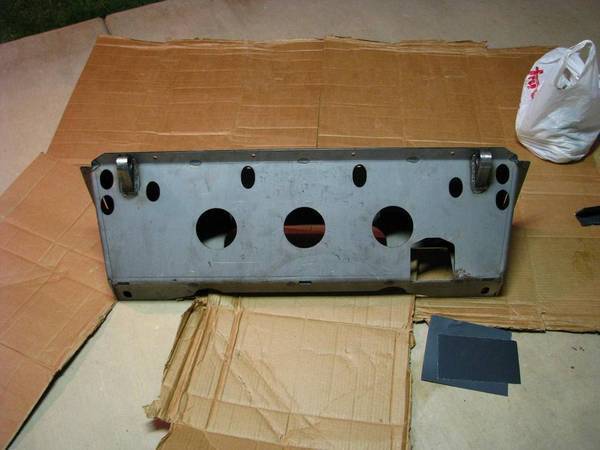

    Next either lay everything out or hang it up and clean the surface with the rags and rubbing alcohol. This will ensure that no oils, dust or dirt is left on the surface of you bumper when you go to the next step.

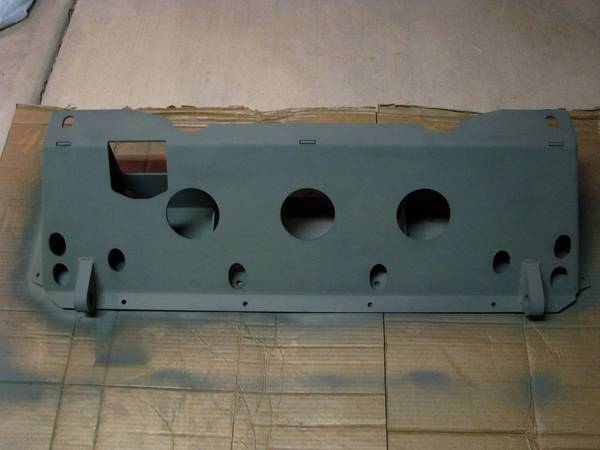

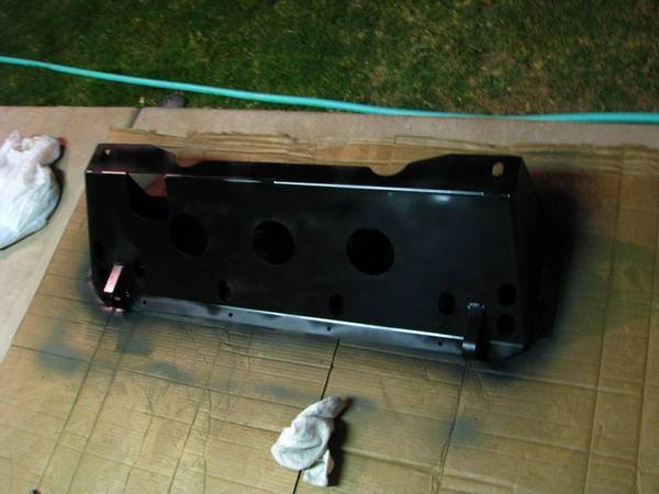

    After all the surfaces are clean apply a couple coats of primer, I used rustoleum self etching primer.
    Once the primer is dry, I started applying light coats of flat black paint from Krylon.
    A couple more coats and everything start looking like this before it drys.

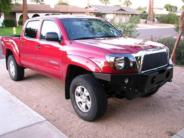

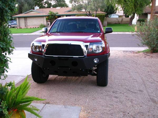

    I let it sit for a day and then assembled everything and put it onto the truck.
    The final product looks like this:
    If you get a run, it's ok don't freak out (like I did) it will sand down when it drys. I used some wet sand paper that I had laying around (200, 400 and 600) to sand it down and then smooth it out.
    If your bumper comes with some bent flanges, you will need to correct them before you paint. Luckily, my dad had an aluminum block and I used a sledge hammer to just bend the steel back into place. If there is more sever damage to the bumper from shipping, I would suggest that you call All Pro for a resolution. Mine wasn't that bad, so I took care of it first. Just make sure you take pictures before you correct anything.
