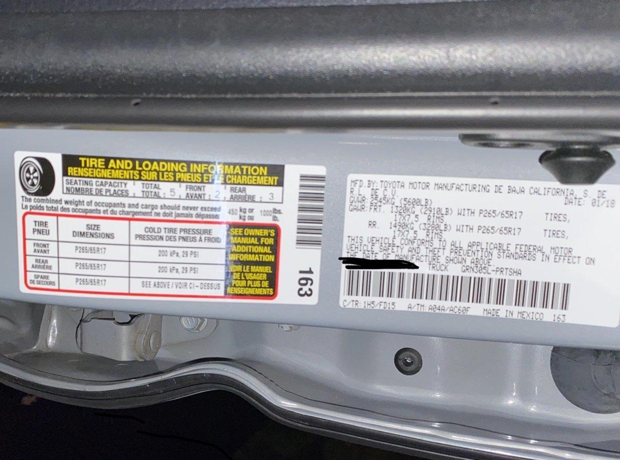

    So I thought my payload was 1120#s but looking at the door jam states 1000# am I reading this wrong?

    You are thinking about it right. Add 90 for the hitch and you should have a good estimate.

    Humm... That’s how I’m reading it too.
    It’s kind of odd, but the more stripped the configuration the more capable the truck is (according to these numbers). Double cab adds weight, V6 adds weight, 4x4 adds weight... all working off the same max cassis capacity.
    Then on the 2.7L they artificially lower the tongue weight limit to 10% of the 3,500 max towing, even though the chassis can handle 10% of 6,000. So you “can’t” tow 3k with a 400lb tongue weight. So, I’m a little skeptical of the numbers.
