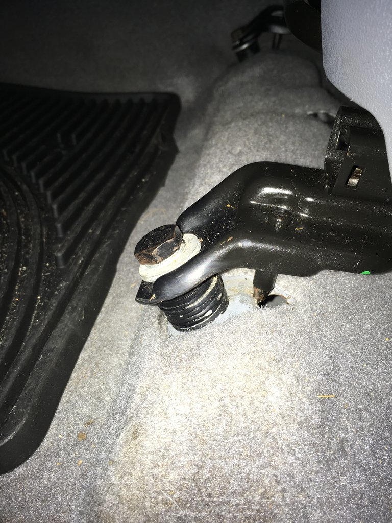

    Previous owner of my truck raised the front of the drivers seat with washers, but the problem is that the pin is raised out of the hole. I really hate to lower it back down because I like a lot of thigh support, it's actually perfect to me just like it is. It does concern me though if I get in a wreck.
    (excuse the dirt, the flash makes it worse:oops:)
