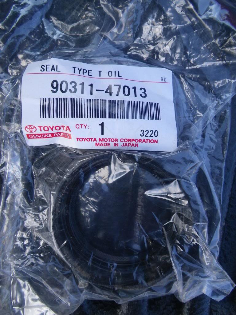

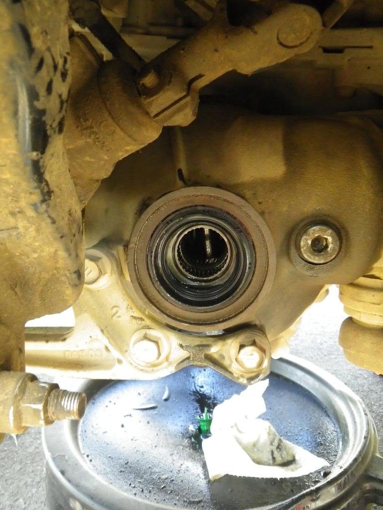

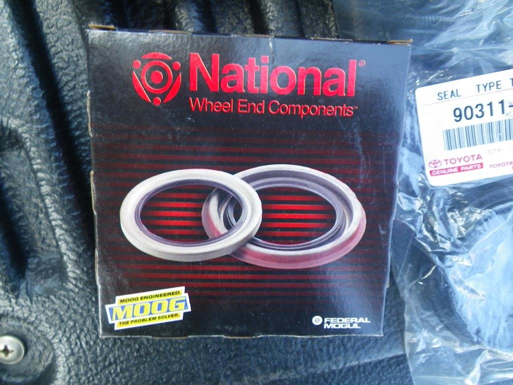

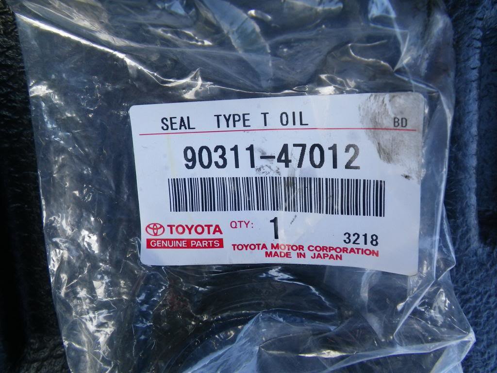

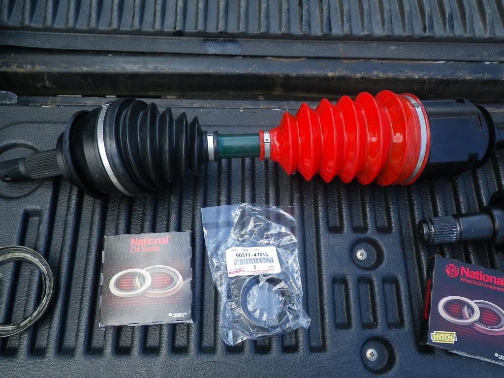

    Finally got around to doing this as well, went with the CVJs with the silicone inner boot, came to $300 with core exchange, and no shipping, they are local to me. I also replaced the inner oil seals as well as the seals in the knuckle.
    The oil seals looked OK, but the ones in the knuckle fell apart when I pulled the CV out. I had planned to replace the oil seals, so I had them on hand, but not the ones in the knuckle. A little research came up with the replacement parts, but I had to call like 10 different shops to find them, and finally found two spots that had one each.
    Part numbers are shown for the Toyota diff seals, $38 for the pair (which are different for each side); the Nationals are #710573, $20 each.

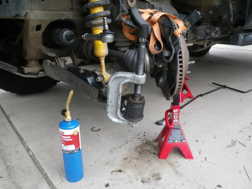

    Well I took this on. My diff seal was leaking. Since I had to take it apart to get to the seal, thought I'd go ahead and put a new axle in. My lower ball joint also needed replacing. Got the axle out....it was tough but got it out.
    It was the ball joint that kicked my butt. I could not get it pressed out. Rented the ball joint press from the store. Tried an air hammer.. after a couple of hours I gave up.
    So I replaced the seal and CV axle. At this point I guess I'll take it to the shop to have them do the ball joint.
    I hate it when something beats me.

    I had the same issue, I thought everything was going to explode and I was going to be killed be shrapnel. My notes are here: http://www.tacomaworld.com/forum/4runners/238998-wishbone-runners-build-3.html#post7327602
    If you can have the truck apart for awhile, try what I did and let it sit overnight with pressure on the press and dousing it with PB.
