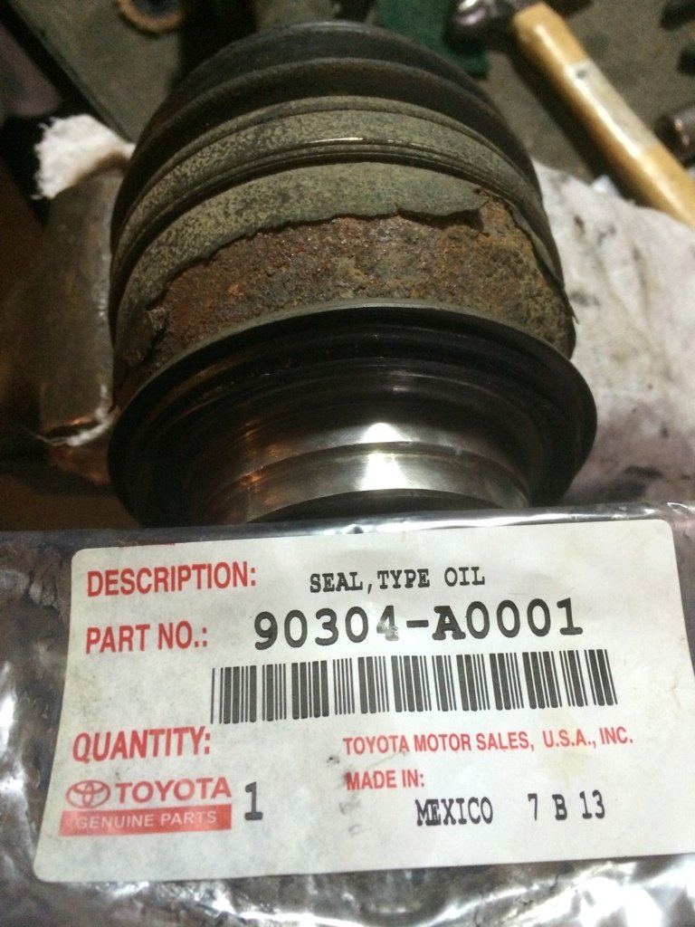

    I'm pretty sure this is incorrect. 710573 is the seal that sits in the knuckle or spindle.
    Does anyone know the number for the seal that sits on the CV and mates to the spindle seal?

    It's a dealer only item, I'll post it in a few.

    What are the torque specs on the actual hub? 4 bolts? Saw the cv nut is 173.
    How often is the inner dust seal torn/ripped?

    The seals that were left on the axle are 710477 and 710573???

    Yup. I left those on because I wasn't able to find those in town at the time, but I'm sure you can get those from local seal and bearing places or even your local auto parts stores.

    Other than the seal that goes into the diff are these the only seals needed?

    Yup that's it. There is a seal that's supposed to be in between the hub and the bearings pressed in already if you get the bearing assembly from either bamatoy or nj, otherwise, if you do take Your old bearing off to be pressed in separately, you would need another seal which I don't have that part number. It's been a while since I've updated this thread, but I'll try and get to it some time today if not tomorrow.

    I got the assembly from Bamatoy and bought the seal too. So to put that seal in I have to take the CV out and replace it where the CV goes into the diff correct? Just trying to find out what steps I need to do to put the new seal in with the assembly. Any help would be great. Thanks.
