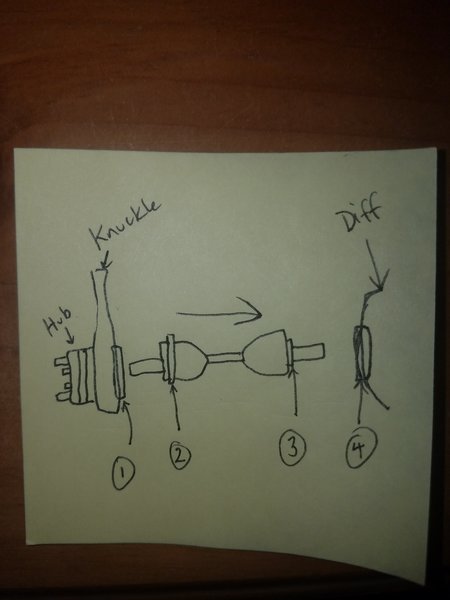

    I'm getting ready to swap out my wheel bearing hub assemblies and cv axles on both sides. Headed to the parts store this morning to order what I need.
    I saw part #s listed in the OP, but just wanted clarification.
    Can anybody look at my side view sketch and tell me the part #s for the 4 seals indiicated.
    I believe #1 is 710573
