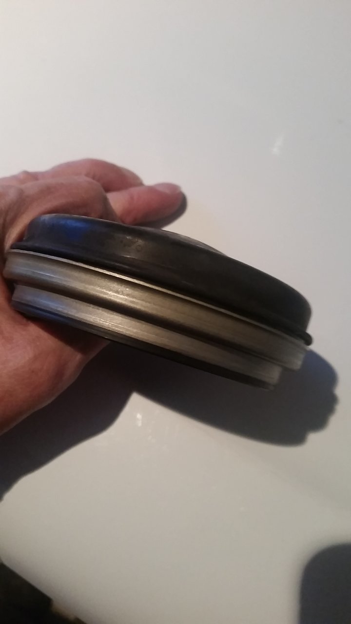

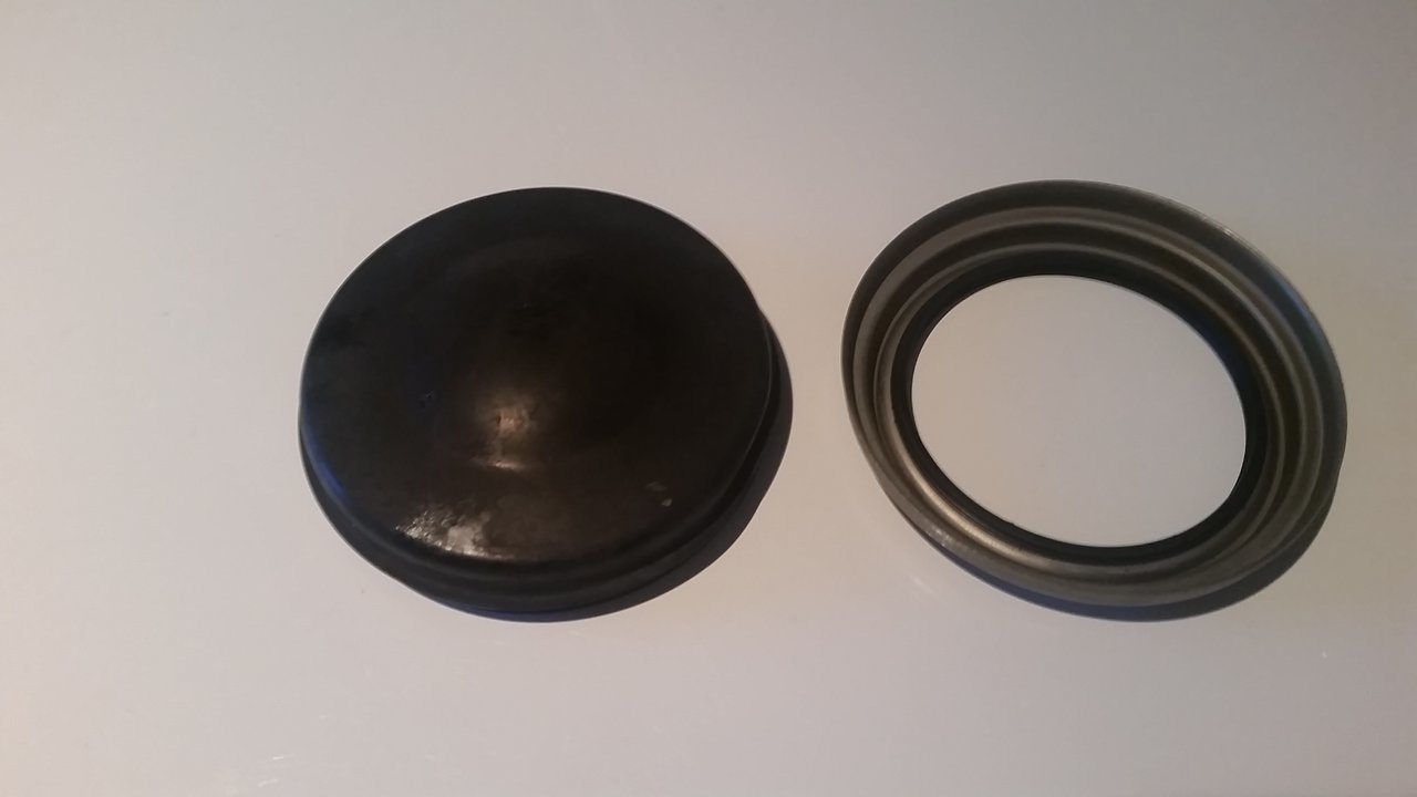

    Found a perfect seal driver for cv joint/wheel bearing in the back of the hub.
    The dust cap.

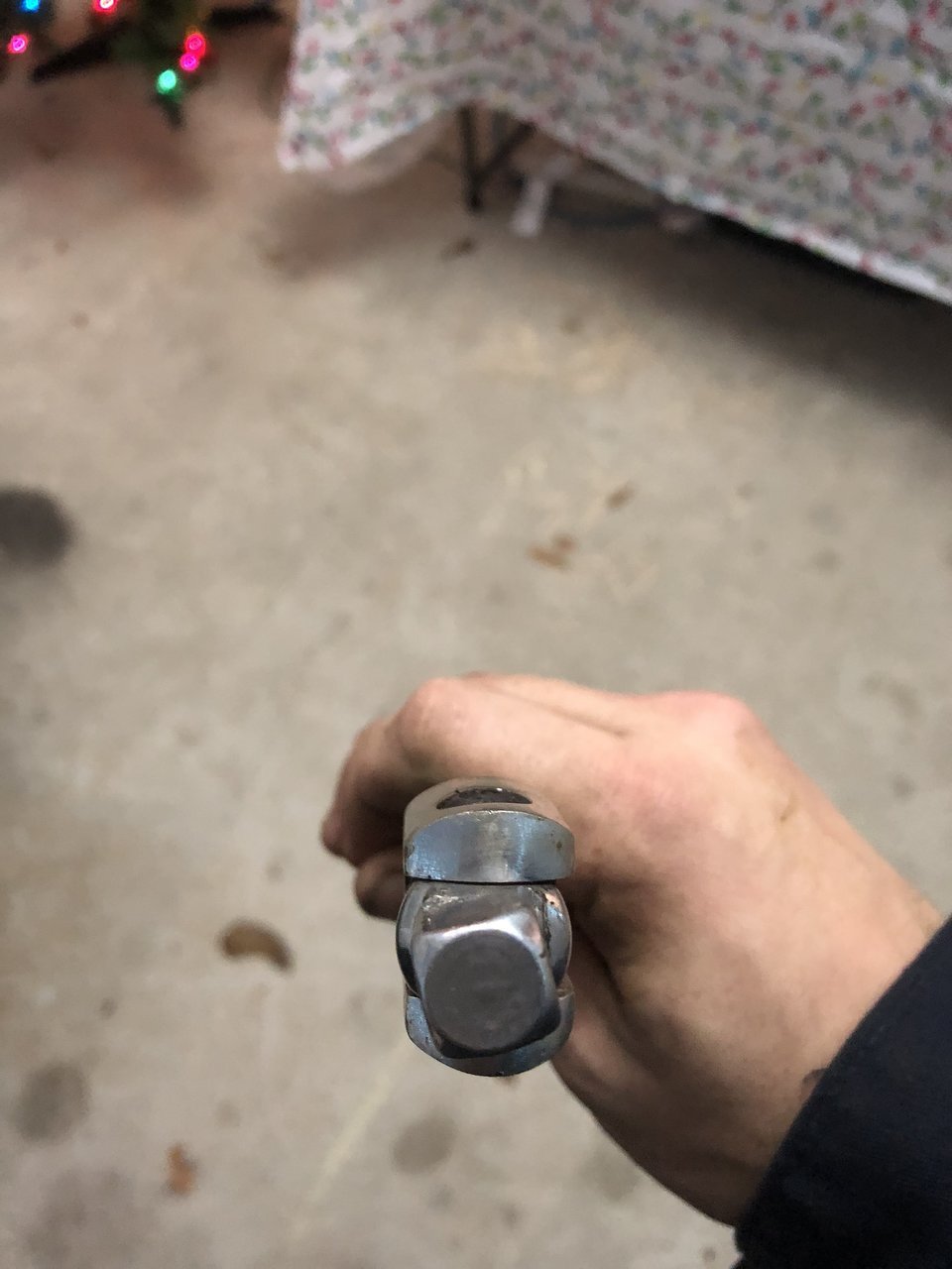

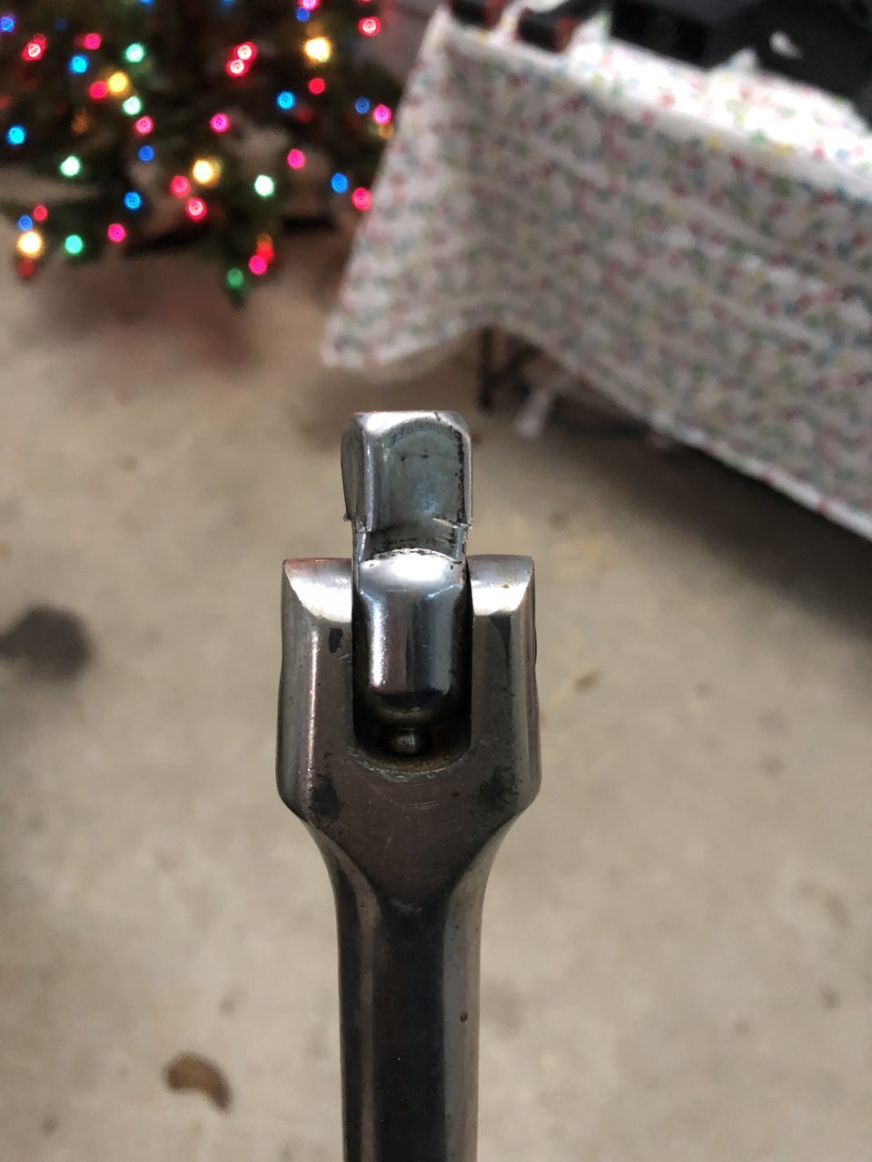

    Axle nut: 1
    1/2” breaker bar: 0CC26A32C-4794-49F3-ACC3-F95A76C8D080.jpg 196C3CFB-1F7B-4972-9C8C-82723801CA7E.jpg

    my craftsman impact wouldn’t budge it so I put my craftsman breaker bar on it with a 4 ft cheater pipe after I broke the Chinese one. That and some ATF/Acetone and it finally broke loose.

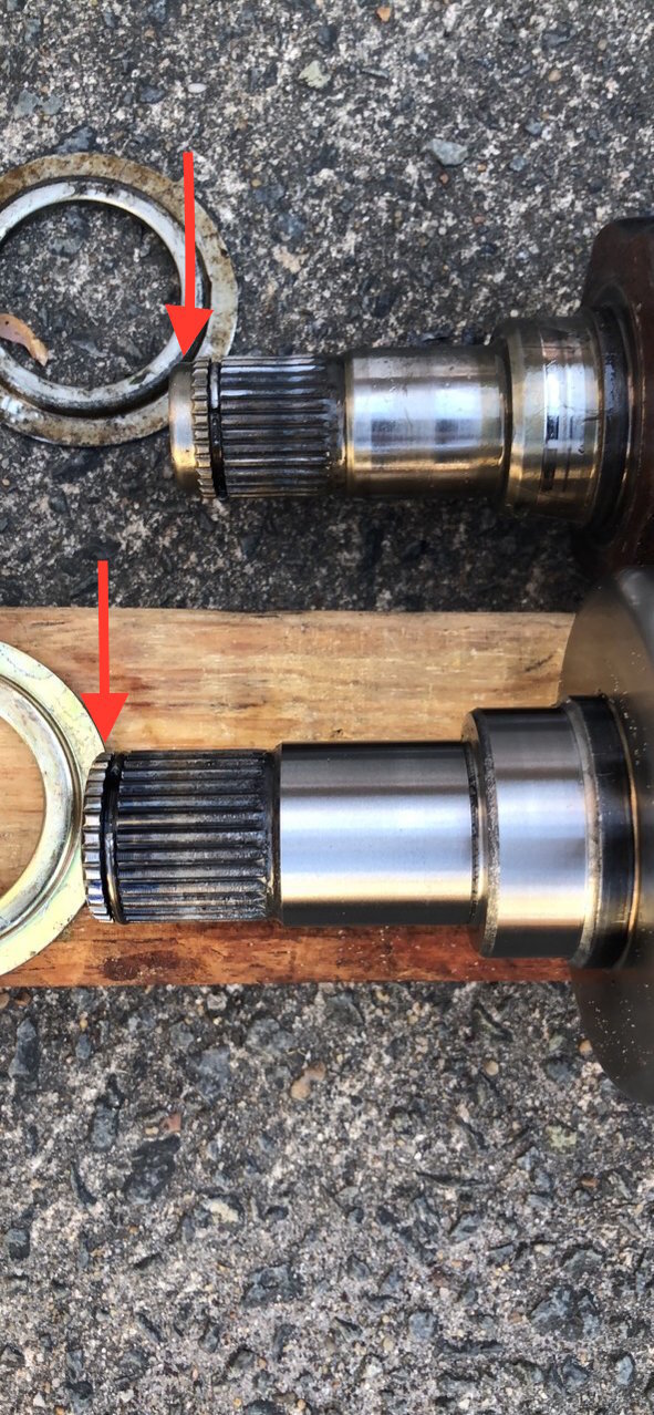

    Difference around the c clip of old and new cv, supposed to look that different?

    I actually have this same issue right now, did you use the original cv? Mine has a pretty good amount of lateral play and I’m still getting a vibration and a (whomp whomp whomp) noise but neither are anywhere near what they were before and they go away when I turn left.

    Where did you get the cv axle from? Are you sure it is the correct one? Why the difference on the end of the shaft by the c clip?

    I got it from O’Reillys, it has about 1/4” of play at the dif. Going to pull it back out and take it back to O’Reillys. It seated and works fine from what I can tell but still more play than the original. Probably just going to rebuild the original.
