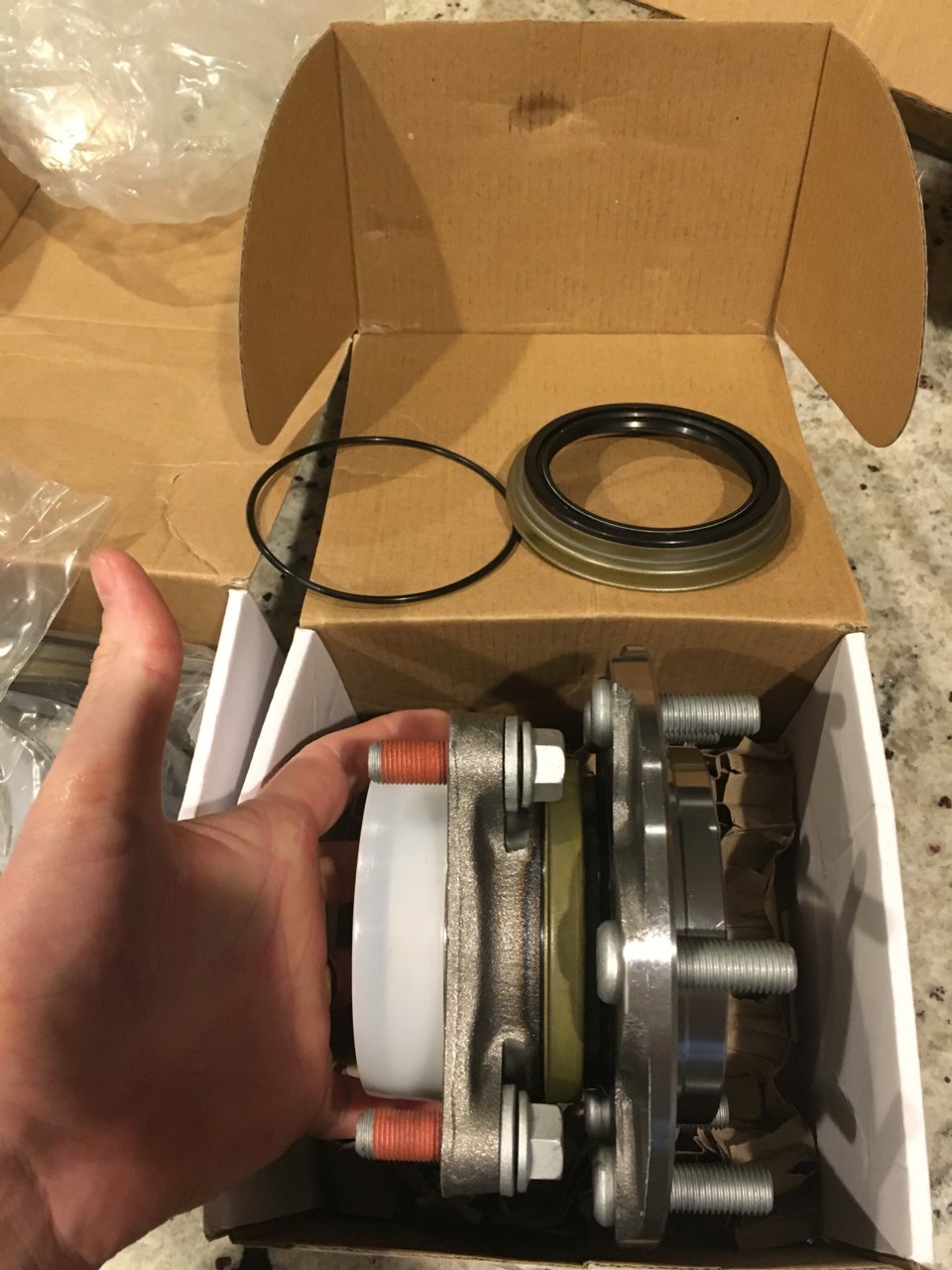

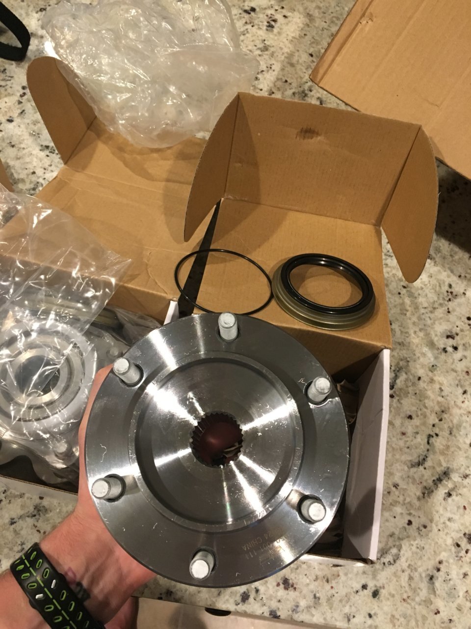

    92DF7462-3AA3-4757-985C-96AD8AF72E23.jpg 55C536B3-4797-4996-9924-BB1848B86713.jpg Hopefully this hub assembly replacement will go “smoothly”
    Planning on Sunday

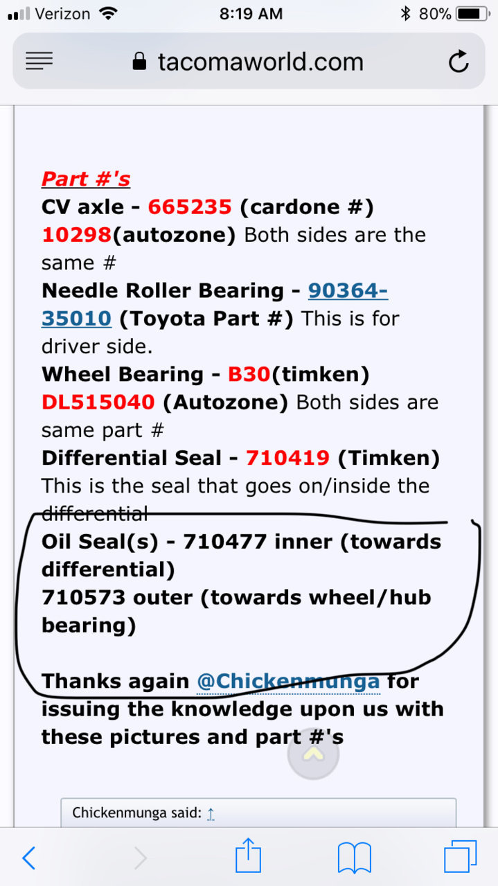

    Quick question relating to replacing an entire hub assembly and the seals:
    Are these parts inside the complete hub assembly OR are these going in either side outside the assembly?
    I think outside right? Like do I need these if I have a full assembled hub assembly and am replacing only that? Doing this tomorrow morning so want to make sure I am ready.
