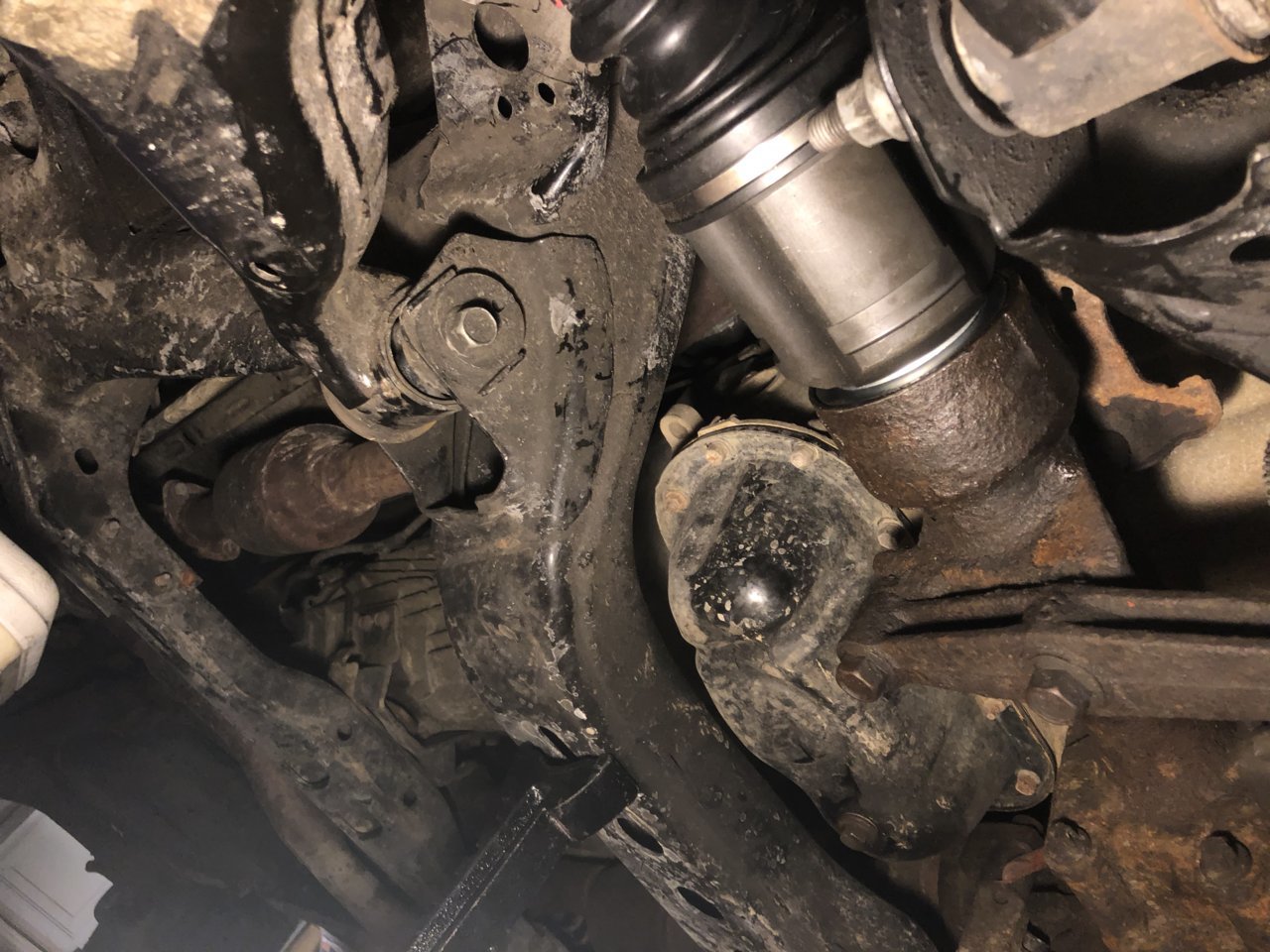

    I tackled the CV axle on the passenger side of my ‘05 truck this weekend.
    Got the old axle out fine w a prybar, but I can’t get the new one out now.
    I think I must have pounded the new seal in too far or something b/c after I put it all back together it’s leaking oil really bad from the seal there. DE010520-B52E-4615-8624-BB840E94ED0F.jpg
    Will need to pull it again and start over w a new seal. Going to go w the OEM one this time, not the Napa or Vatozone brand.
    Anyone have any tips on how to make sure the seal is seated in the right spot?

    Don't waste your money on the OEM seal. I tried that last time and mine leaked like a sieve after the first off-road trip. NAPA is probably the best option, or if you can find an SKF seal at one of the online parts places (I think SKF is who makes seals for Toyota, but don't quote me on that). What when I had to replace it last time was I coated the outside of the seal with Ultra Black RTV and seated it flush with the inner lip of the tube then smeared the excess RTV around the edge of the seal where it sits in the tube. It's currently not leaking, but in fairness, I haven't driven it much or taken it off road since then. You might also try Marlin Crawler Eco Seals, but the one they sent me was the wrong one...of course, I have a unicorn, a Taco with factory manual hubs. Disclaimer: I'm not a compendium of knowledge on 2nd/3rd Gens, so your mileage may vary.
    Also, if you rotate the cv around and try prying from a different side it will sometimes come out, but if I have trouble popping it out with a pry bar I use a long 3/4" brass drift and a BFH to knock it out.

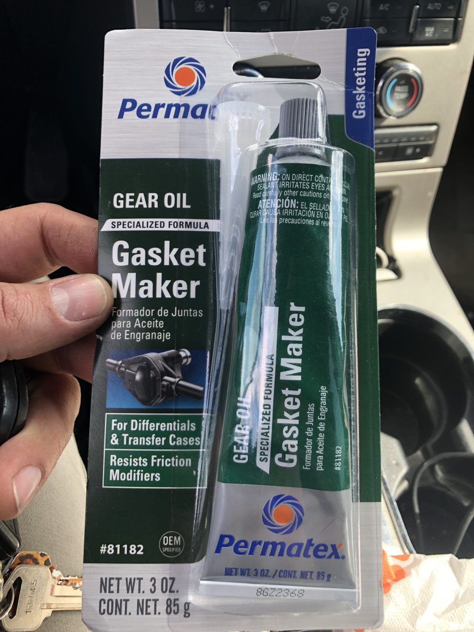

    Awesome! Thank you.
    Okay will do. I’m at Napa now, picking up another seal.
    Got some RTV sealant also, specifically for differentials. Great tip. I’ll coat the seal with it. That should do it ;)
    Taco No Baka[QUOTED] likes this.

    Just the outer rim of the seal, not the seal itself, so it seals the rim to the axle tube. You probably knew that, but I just wanted to be clear.

    Ok cool. :thumbsup: Got it, thanks!!

    Got it out w the pry bar, cats paw and hammer.
    Got the new seal in. Measured to about 4mm. Little deaper than pictured here.
    Letting it dry overnight before I put the axle in tomorrow.
    Napa brand was the SKF by the ways.
    Thanks again for the tip!!
