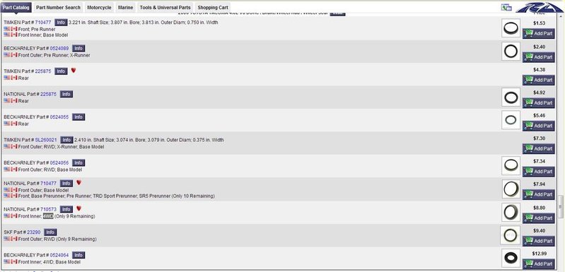

    I ordered what I thought would be the inner and outer Seals/ o-rings. Did I get the wrong thing? I got the Timkin 710573, and the National 510573
    One said inner and the other said outer. They look very similar and I was put off that they both had the same part number. Did i get the wrong thing?

    Here's what rockauto.com lists for wheel seals.
    The National Front Outer, Base Model is a larger size than the Timken Front Outer, RWD.

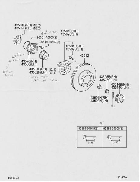

    Check out Toyodiy.com for exploded diagrams.

    Just got these the other day as I could find all the part numbers in one easy location. This is from Toyota's Parts Desk. Hope this makes it a little easier for everyone.

    Everyone should checkout www.toyodiy.com all these diagrams with part numbers are there.. I just keep saying this.

    damn. that is a rather impressive site
    it just doesn't provide a diagram to show exactly where each part is intended to go

    Can you elaborate? It's got the same diagram you posted.
