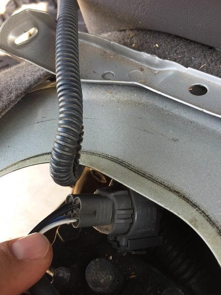

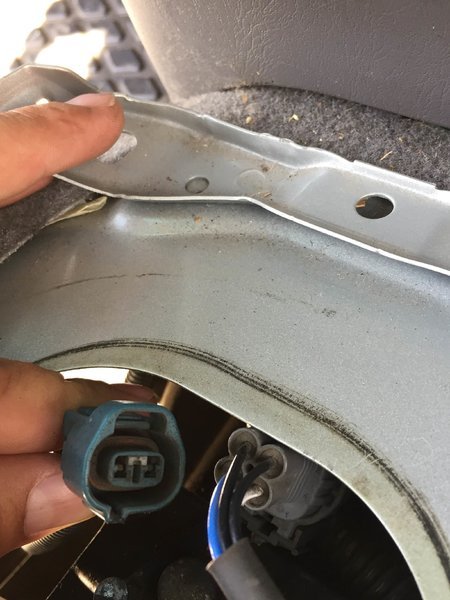

    Doing this now on my 2002 Tacoma 3.4L V6 manual trans. Had 1 question and thought I'd add a couple pictures to the thread. As said, it's a PITA to get to the upstream sensor connection. I went through the gear shift access hole. It took me some time to realize the connection was facing the opposite direction even though I read it previously in one of these discussions.
    The first picture is trying to show the plastic connector that connected the wiring harness to the transmission. I took a flat head screw driver and a hammer and busted it so that I could turn the harness around and access the O2 sensor connector. (the pic is after all this, that blue/black/white wiring you can see is the O2 sensor wiring after I've turned the harness around.)
    2nd pic is just another of the O2 sensor connector for visual. I wish I had gotten a pic before I turned it around but did not. Tip for me: having the O2 sensor un bolted gave me the proper slack I needed to turn the connection around.

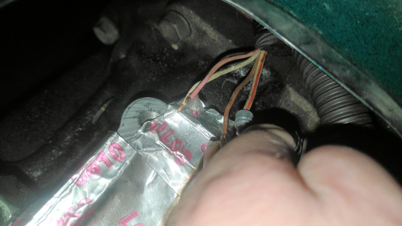

    The 3rd pic is my question. I don't know if in my struggles to get to the O2 connection I knocked this connection loose, but I can't seem to locate where it goes. Can anyone give insight by looking at the connector to where this came from? This really is a poor design flaw having all this stuff tucked away above the transmission.

    Just replaced my B1S1 Air/Fuel Ratio sensor a couple days ago and have a few comments about my experience.
    First, spray a penetrating oil on both nuts and bolt threads a couple times, letting them "soak" for a few hours each time. Don't rush. This will prevent a broken stud, which complicates the replacement a thousand-fold and significantly impacts overall cost and down time.
    Second, use a socket if possible. I was only able to loosen and re-tighten the nut one click at a time, but as I said earlier - don't rush the job.
    Third, the wiring harness connector has a nipple, fitted to a mounting bracket, which you should disconnect that allows much more freedom to remove and replace the O2 sensor connector. Remember to click it back into place when you are done with it.
    Fourth, the gasket will have heat material on both sides, one side is almost fully covered (this side goes towards the exhaust pipe) and the other side is only about half covered (this goes on the sensor side).
    Fifth, apply anti-seize to the bolt after the sensor is in place to ensure NOTHING gets on the element, including you grimy fingerprints (use gloves). You can also apply some to the nut.
    Lastly, do not over-tighten the nuts, or you may snap a bolt off (see above). Check for leaks after install by starting engine.

    I also thought by looking at how dirty the mystery connector looks that it may have not been plugged into anything...

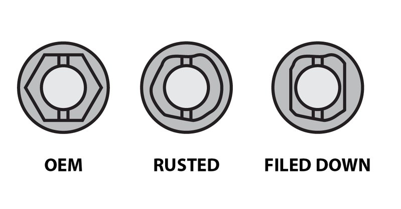

    Super simple to replace... but if your nuts are a rusted mess its more involved (mine were completely toast). I hit them with PB blaster for a few days, then filed them down so I could get a smaller sized wrench around them. I didnt have access to a torch or grinder. Cleared up my P1135 code.
    Denso 234-9001 Air Fuel Ratio Sensor: $96.00
    OEM Replacement Nuts: $5.58
    PB Blaster: $3.76
    Anti Seize: $1.49

    Up on post number 26 of this thread, a question was asked as to where that mystery plug went to. I unfortunately broke the o2 sensor plug on the trucks wire loom so I had to go find a Chiltons book and find out which color wire did exactly what and direct wired it to the new o2 sensor. If anybody else breaks their o2 sensor plug the color code is as follows when hooked up to a denso 234-4161 o2 sensor.
    Brown is definitely ground
    White /red is power
    Pink to green stripe heater to ecu
    White is oxygen wire to ecu
    O2 sensor colors as follows:
    2 blacks go to heaters to pink and white
    White goes to brown
    Blue goes white/red
    I wired straight through to "butt" connectors and ditched the stupid proprietary wire connector. Where does that other mystery plug plug into as I took my truck for a test drive before I put rubber boot and center console back together to find out that my speedometer all of a sudden doesn't work, so I'm assuming that mystery plug is for the speedometer. Now I just got to figure out where to plug it into before a button up my center console. This o2 sensor replacement has been an absolute nightmare. Thank goodness I found that wire diagram for the upstream o2 sensor, otherwise, I'd be screwed. Hopefully me posting that will help someone if they accidentally pull their plug off and are in the same boat as I looked all over the internet and could not find the answer. I was starting to get worried.
