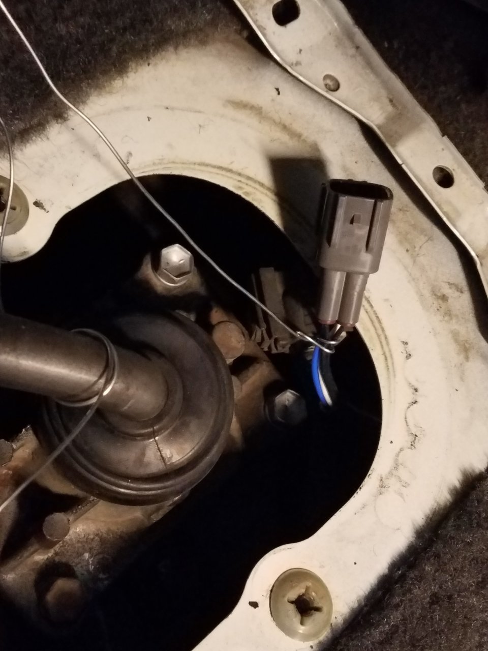

    I believe that's the same plug I must have unplugged that stopped my speedometer from working. Any help would be appreciated as I didn't see a response to the previous persons question answered. I plan on going back to the chiltons book again if nobody here can answer where it plugs into. Thanks in advance for reading.

    I bought a set of DESNO yesterday from Advanced Auto, they have a 20 percent Internet discount going on for 150.00 for both.
    Use a thin wire and run it down from the top of the transmission hole and pull the pigtail of the sensor up where you then connect it to the socket.

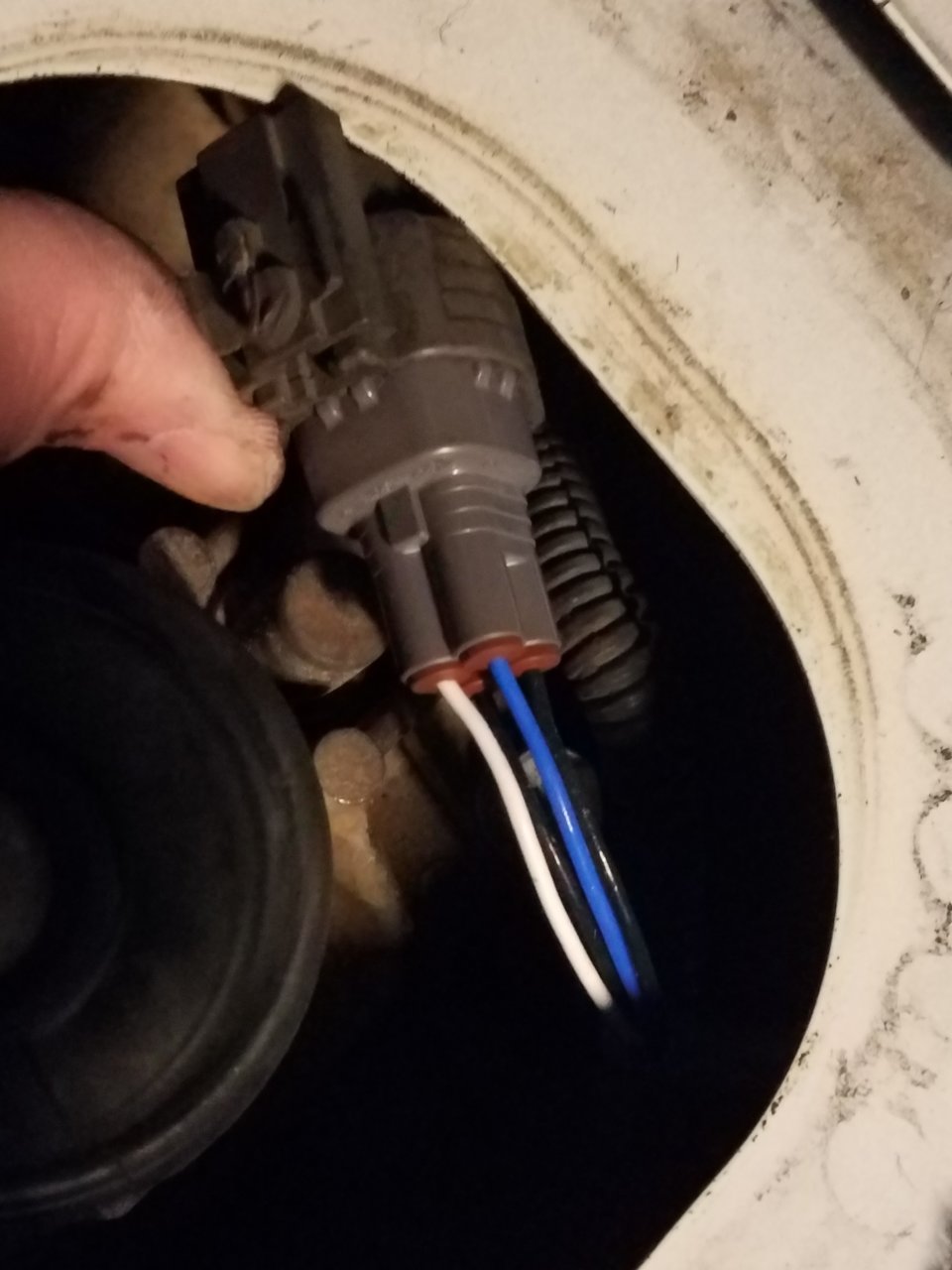

    Mine, Male and female are the same color

    I have an automatic an it was connected up top on the transmission . It was difficult to get undone. I know the back sensor connected under the passenger seat.

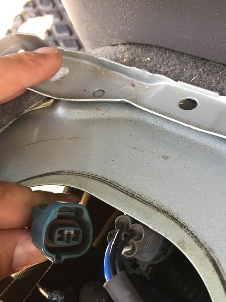

    The sensor plugs are not all like that. Crawl under and look before pulling shift console.
    The rear sensor plug can be pulled out from below even though everybody says remove rocker covers and pull up carpet to disconnect plug.

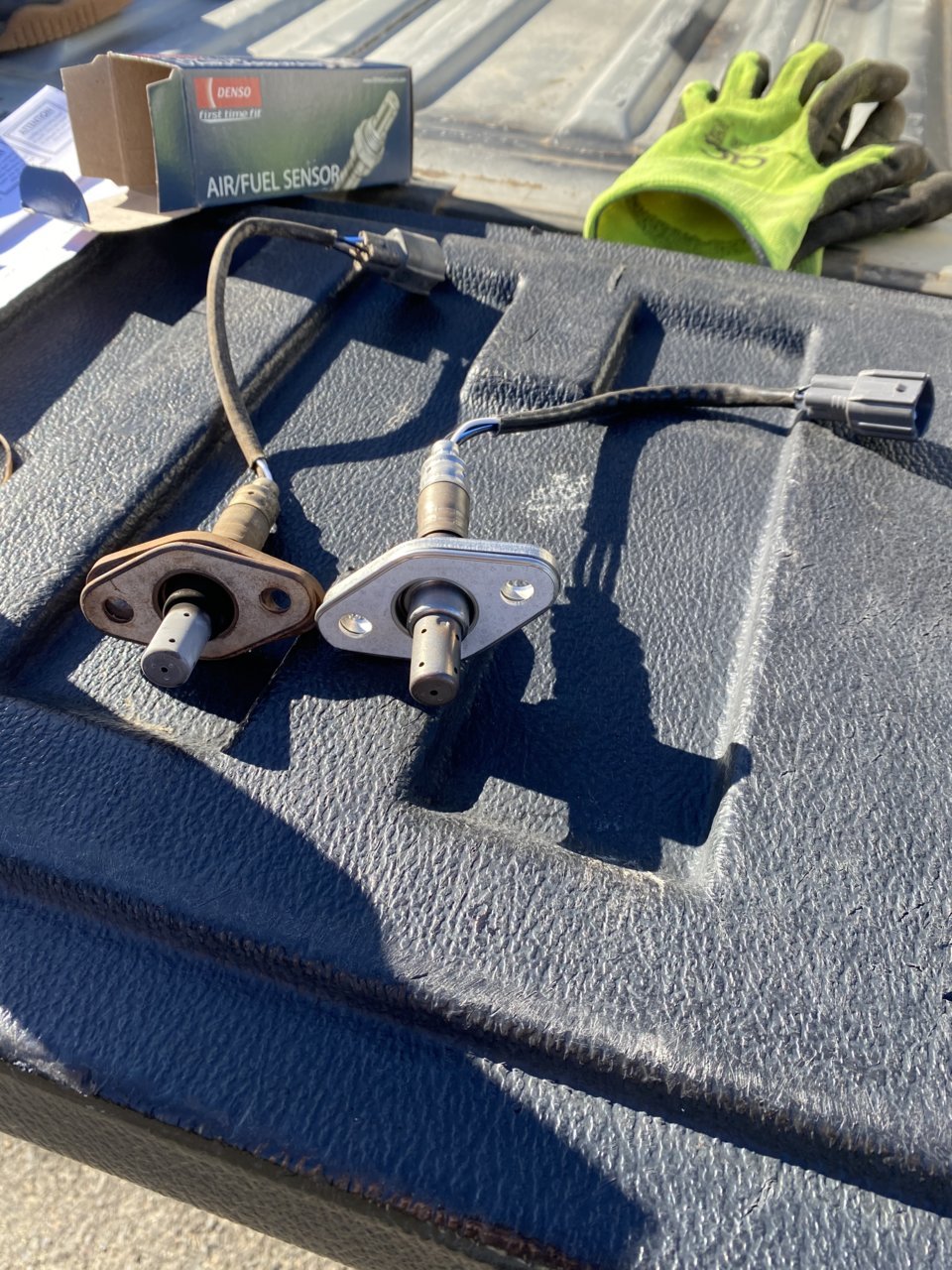

    Old thread, but it really helped when I just replaced my upstream A/F sensor. I was one of the unlucky ones whose electrical connectors were on top of transmission. Going through where shift boot is helped, at least I could see the connectors. Still had a devil of a time getting them apart though. Any advice I can give would be to get sensor off exhaust first so you can get a bit of slack in the wires. Oh and from Toyota the new sensor does not come with a new gasket, I thought it must because I could not find a part # for gasket looking at Toyota's diagrams. However you can find the gasket by looking at the downstream O2 sensor. It uses the same gasket.

    Mine came with a new gasket there on the right. My 04 DC is an auto of course. Not sure if since the part #’s are different you don’t get a gasket.

    Looks like Denso sends the gasket with theirs, mine was from Toyota and didn't come with gasket. I tried to order the Denso from Amazon but they sent a completely different sensor than what was on order. I have to get smogged tomorrow to renew my registration so was forced to get it from Toyota dealer.
