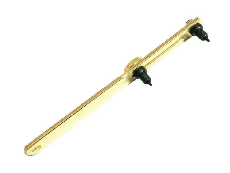

    What's the name of that watch tool? Can you just unscrew the bezel with that watch tool if it's not coroded?

    I had to replace the rusted out antenna awhile back. Had a hell of a time getting it off. I ended up using a dremel. I wish I had found this $5 tool before I started! It is a watch case wrench from walmart! fits perfectly in those grooves and will unscrew the bezel easily after spraying some penetrating grease in it. Hope this helps anyone avoid the shit storm I ran into.

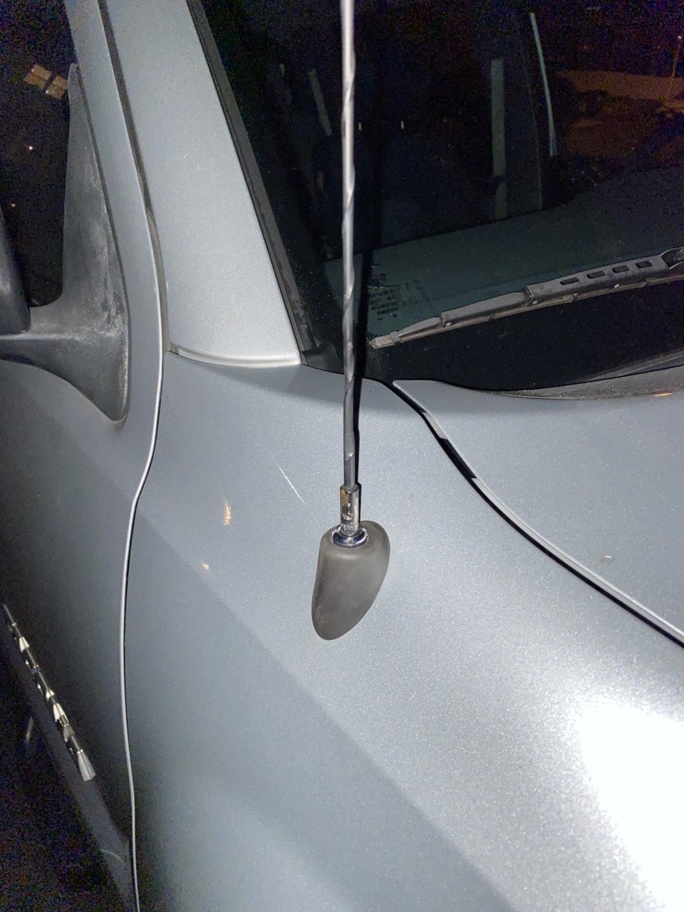

    Just purchased a 2010 Tacoma DC, came with no antenna, upon closer look can see 2 or 3 threads, hard to tell if any broken piece is in there. I am planning to get the antenna off my 07Tundra n try it in ..hope they are the same kind.!!!

    Hello,
    Great write up!
    Couple of questions:
    1) Is this the same on a 2014 Tacoma? Same part numbers? Same process?
    2) Do I have to remove the bezel nut completely OR can I just remove the flare / wheel well and then remove the antenna from the inside of the fender?
    I have a 14 Tacoma with Nav. I broke my antenna off (after market short one) on a tree while offroading last weekend.
    Piece of it stayed down in the mount. I tried everything to get the piece out, didn't work. I tried to get that NUT off, hammer and chisel, liquid wrench, etc. Nothing would budge that nut. Watch makers tool did nothing.
    I ended up taking a dremel to it and sawing through it, but its still partially there and all mangled. I beat the antenna mount to hell and need to replace it.
    If I remove it do I need to take the nut off or does it just slip out from inside the fender if I remove that 10mm bolt on the inside?
    Just asking to see if I need to keep sawing through that thing with a dremel, or just remove the whole thing and replace.
    I am planning on doing the full antenna, bezel nut, bezel, etc.
    Under the rubber bezel, it appears that the nut connects to a larger metal base that looks larger and different then the pictures.
    Is that a different part on the 2014?
    Thanks a lot. This is been a mess.
