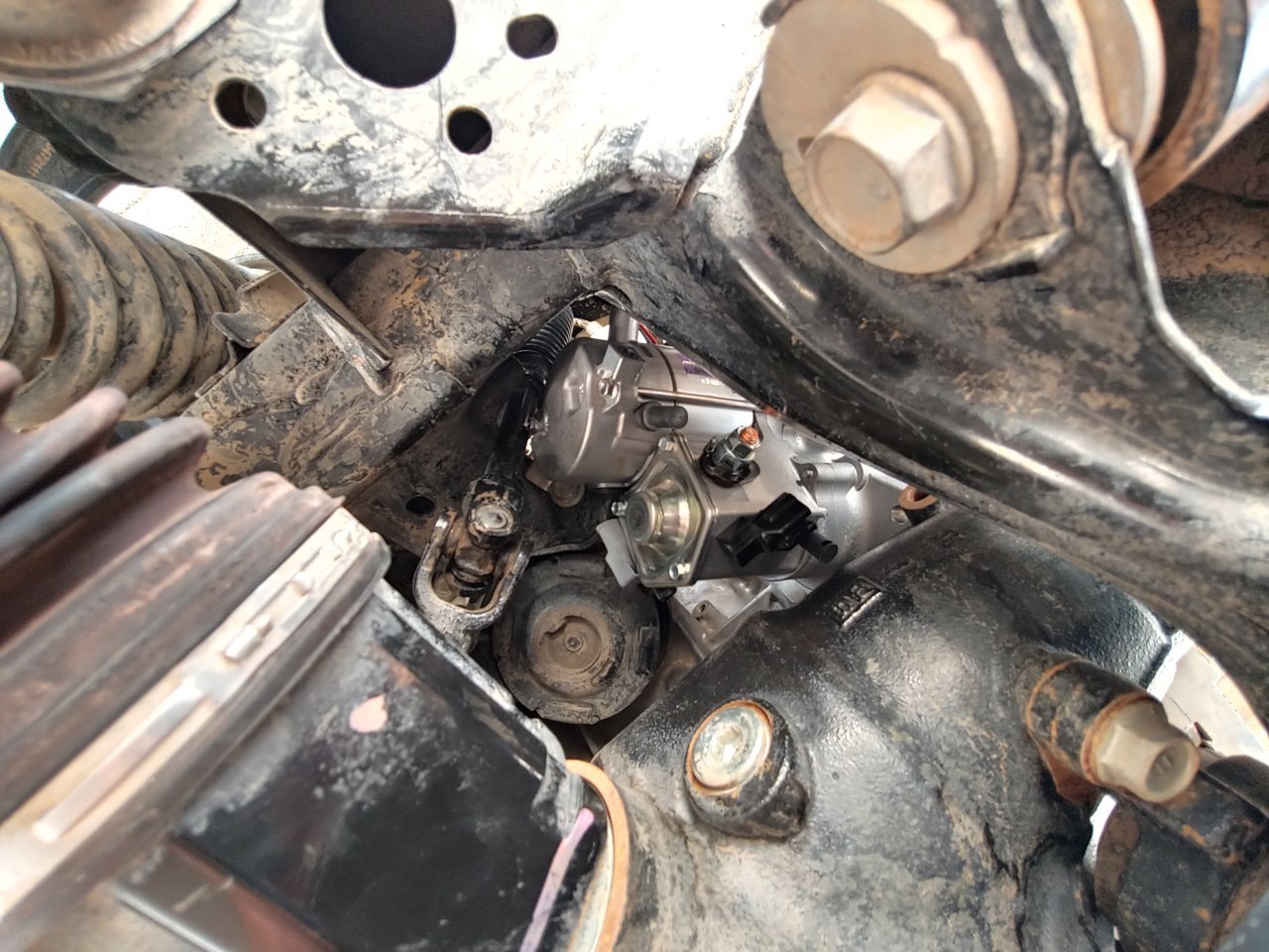

    This is killing me. I'm stuck at the removing the starter from under the truck. Running outta daylight might have to yank the drivers side CV

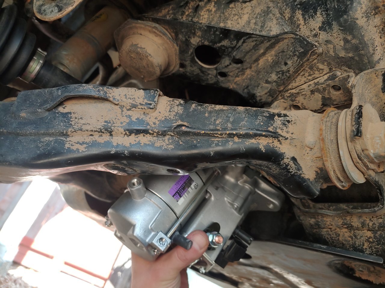

    The pictures i posted on how to orient it and drop it through the bottom are critical. It took me about 30 minutes of trying to figure that out.

    You can also remove the starter without undoing the yoke or support bracket. I separated the solenoid from the motor and then wiggled the both of them out. Not saying it is easier but just another way to skin a cat.

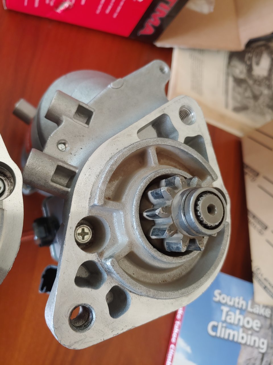

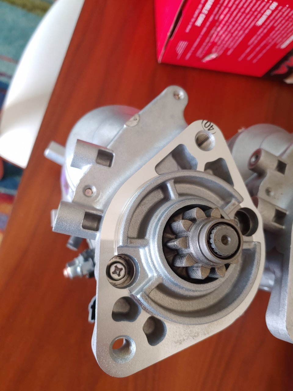

    Are you saying the starters on Tacomas have breathers? The two little black 'fittings' you can see on the OEM one in the first picture?

    Yes, the two little rubber fittings that look teeny like top hats. Most starters have some similar sort of breather.
