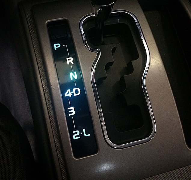

    Yeah I didn't try to force it in but I'll try shaving it down a bit thanks

    If anyone wants blue I can send you a couple.
    Update: all out of LEDs

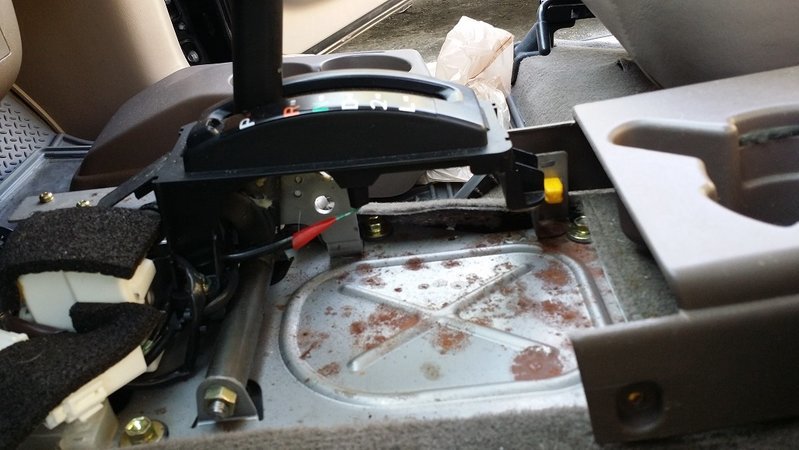

  10. Mar 25, 2016 at 3:51 PM
    #70
    KeptOnChooglin
    KeptOnChooglin Well-Known Member
    Mar 3, 2016
    #180154
    817
    Phil
    Houston, TX
    2003 Crew Cab PreRunner L4 Auto
    Bump for 1st gen instructions.

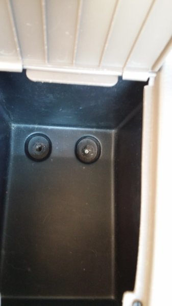

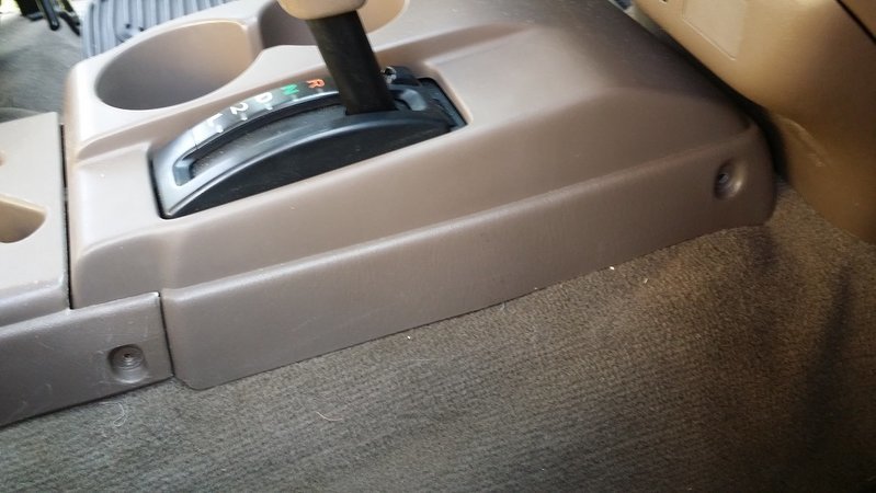

    I did this today, its basically about 10 minutes
    1) Swing back armrest, open little door for lower storage, remove 2 bolts.
    2) Loosen 4 screw head bolts (2/side) from sides of AT shroud.
    3) Lift up AT shroud rotate 90 degrees and remove. During this it will be necessary to lift up the front of back panel that goes to the armrest (where the rearmost 2 screws to). Just lift it up 20 degrees to do what you need.

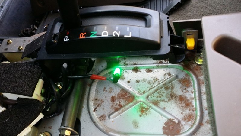

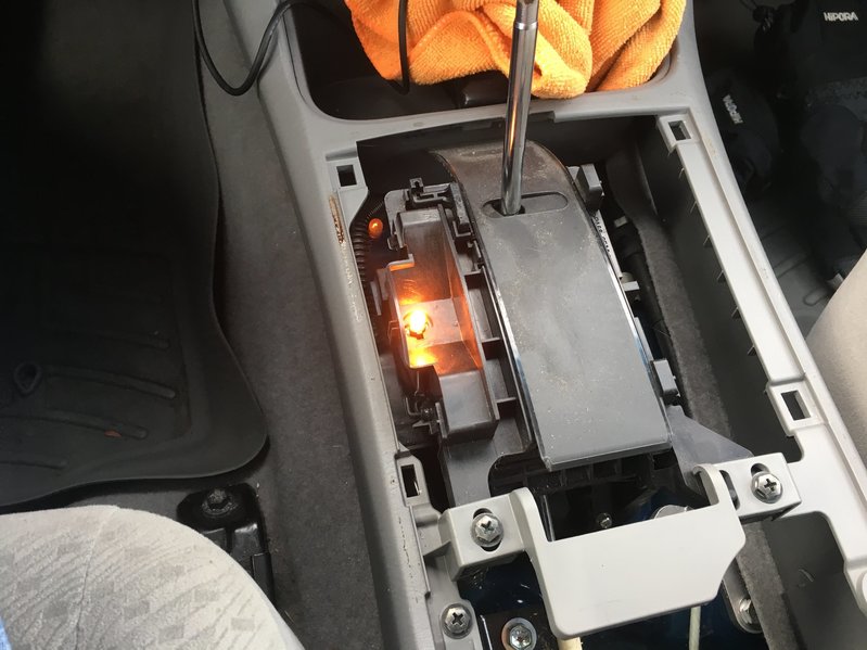

    4) Unscrew the illumination bulb. Hint, its the one with red on the wire underneath. I think it loosens clockwise and tightens counter, you can figure it out, you have the technology.
    5) remove bulb and insert LED. Turn on headlights, if it doesnt light up, remove LED, rotate 180 degrees and reinstall. I had to do that. I was using a shop towel/paper towel the entire time when holding LED to avoid finger oils.
    6) Secure light, and reverse above steps.
    For my 1st gen, the LED used was a type 74. I ordered from SuperbrightLEDs and it is listed as
    74-GHP3 Volts 10-16V Viewangle 360.

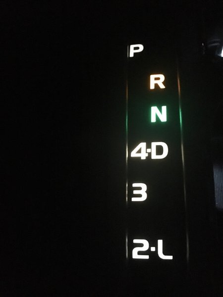

    I changed the shifter indicator lamp to white LED its kinda hard to tell from the picture but it is white now instead of dull yellow.
    Before.
    After.
    [​IMG]http://www.amazon.com/dp/B00LVFJ9AU
