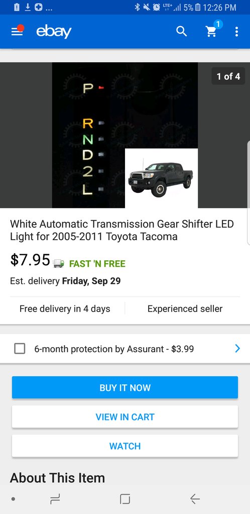

    Can I use LEDS? I came to autozone they don't have that bulb so does that mean have to go to Toyota

    Screenshot_20170923-122616.jpg would these LEDS work help

    I ordered the part through toyota I believe its cheaper than $8.00 buts its not a LED

    I wonder if those LEDS would work 8 bucks got Nothing to lose doesn't work than go to Toyota

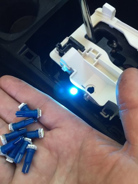

    I have a few extra of those same units as well. No issues with mine so far, they light up nice and blue.

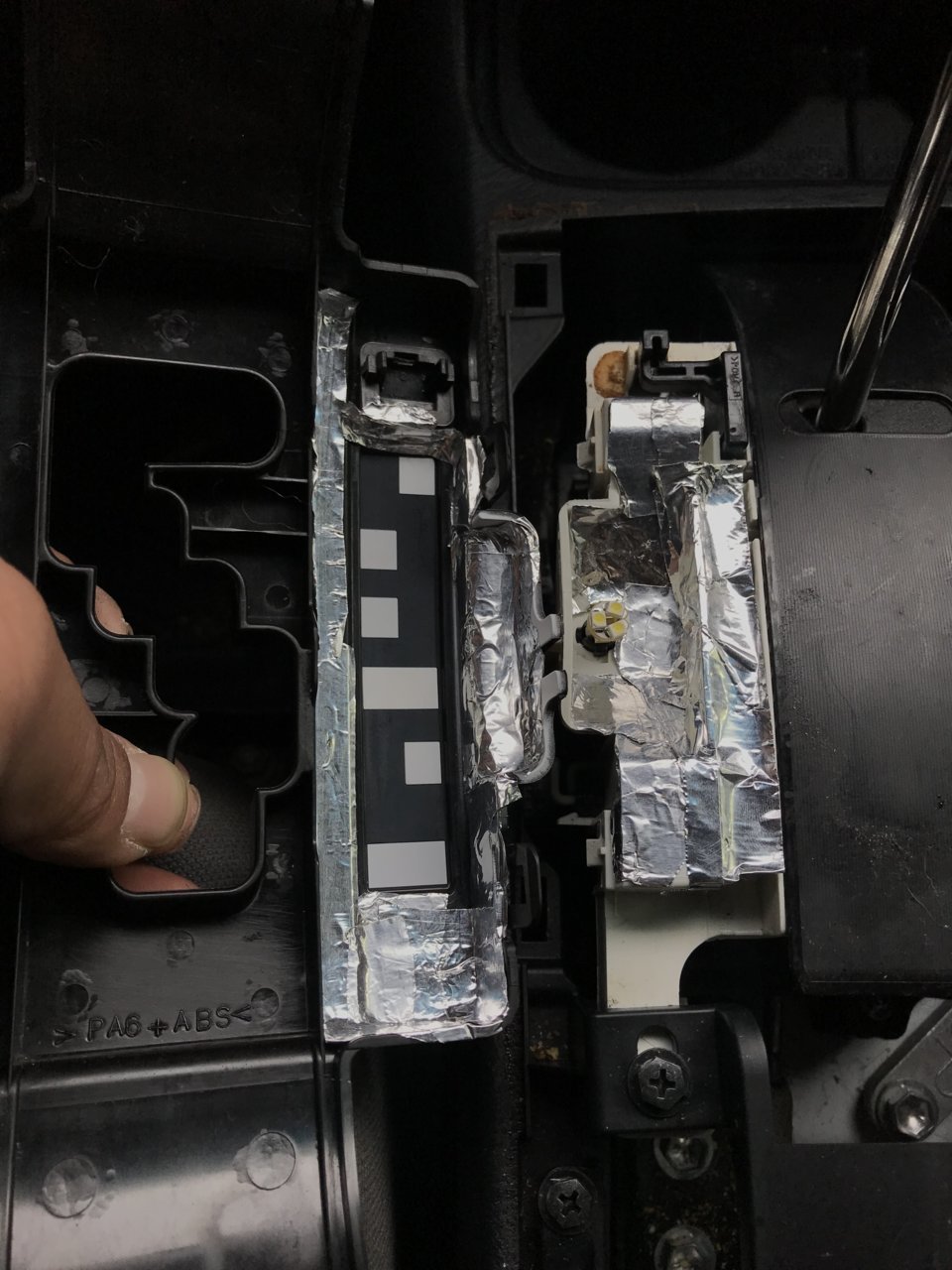

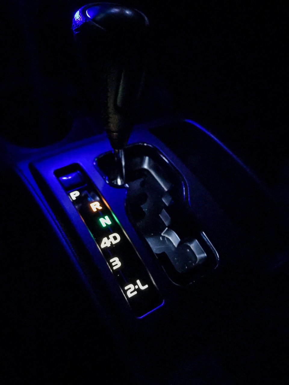

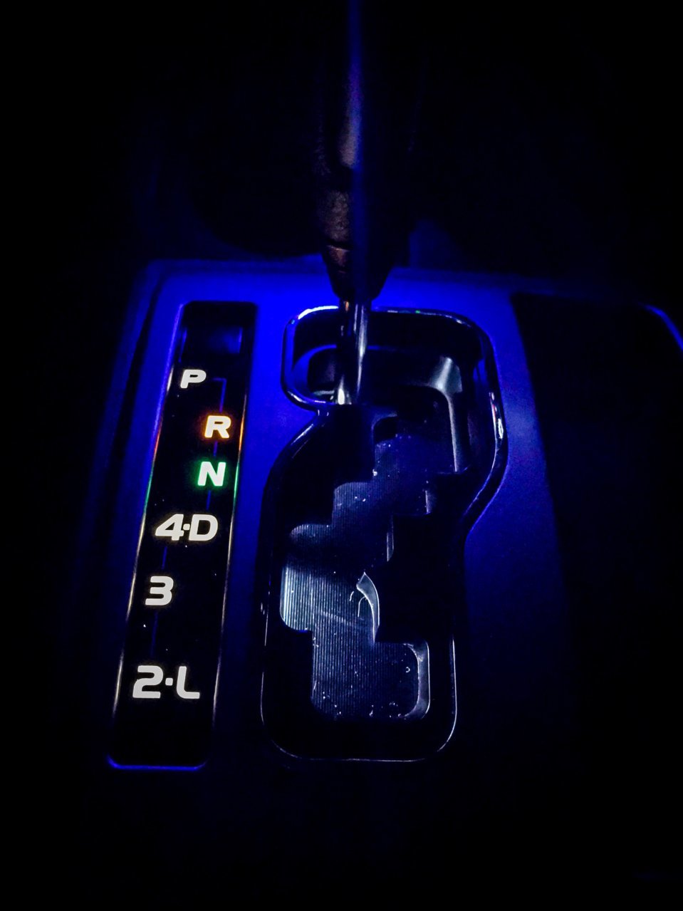

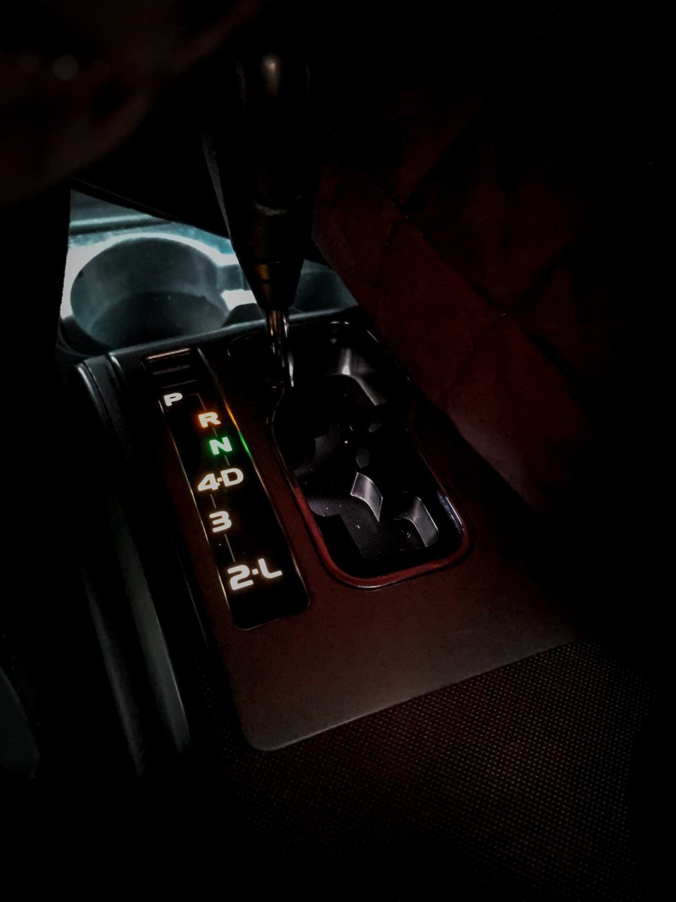

    For even light distribution.
    09FEE7BF-77A4-4407-AB6B-86960F9D5567.jpg 1393DFC1-F57D-4696-8566-D54956A28F09.jpg

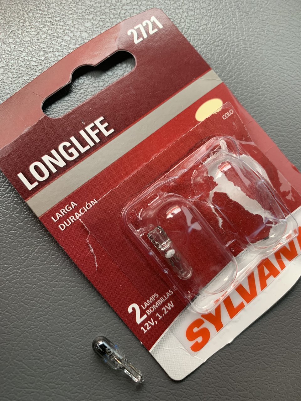

    95AB1102-6CF4-4BDD-B092-03ABB33E2107.jpg The instructions for taking the console apart were perfect! I have attached a couple pics from my 2011 Tundra. The bulb needed is a 2721 that you can get at most auto stores.

    I just bought an 05 yesterday. I discovered at night that there is no lights in the heat air Parris I ordered 2 and waiting on them. I also had no light in the shifter. I bought a pair of long life #2721 and neither one works. Any ideas anyone? It’s very frustrating
