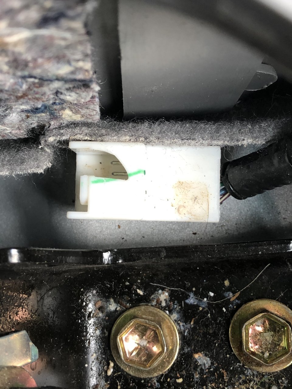

    Great post! I just did this today and it went flawlessly thanks to this. One question, does anyone know what that unused wire harness with the white plug on the end is for? Mine is an April 2005 build, wondering if they prewired for a backup camera or something. Photos attached.

    Could be connector IM1 for the inverter

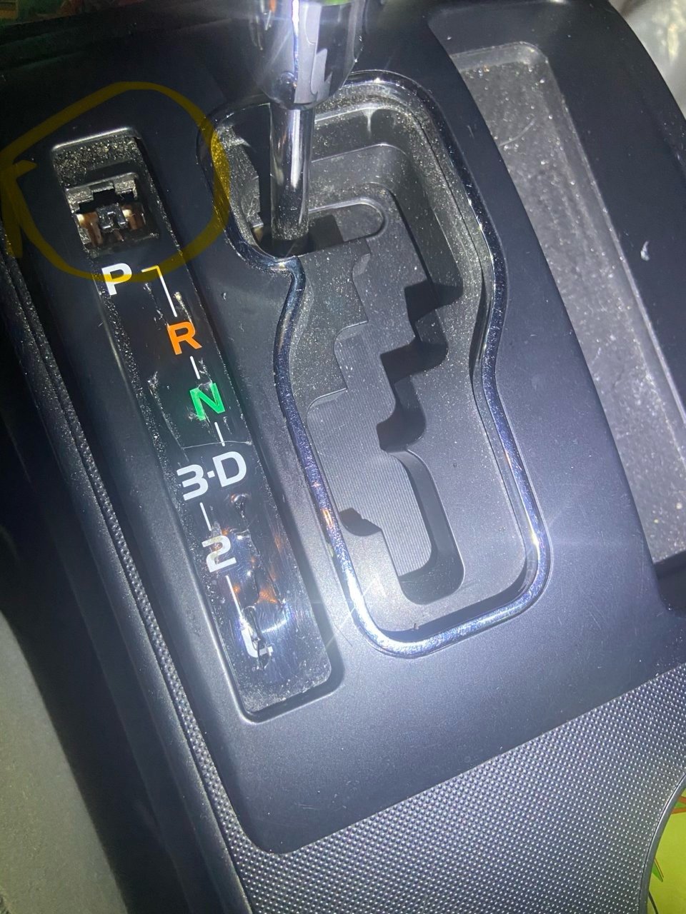

    Looking for some info. Doesn’t pertain to the light bulb but I need the part that has the actual shift pattern. I think it’s a little plastic strip? But I also read the first part of this thread and I’m now thinking I need the whole “upper shift housing”. The previous owner punctured the plastic piece that displays the shift pattern. I haven’t been able to find a part number from the diagrams on the Toyota parts page. Any info would help. Also here’s a picture of what I’m talking about.

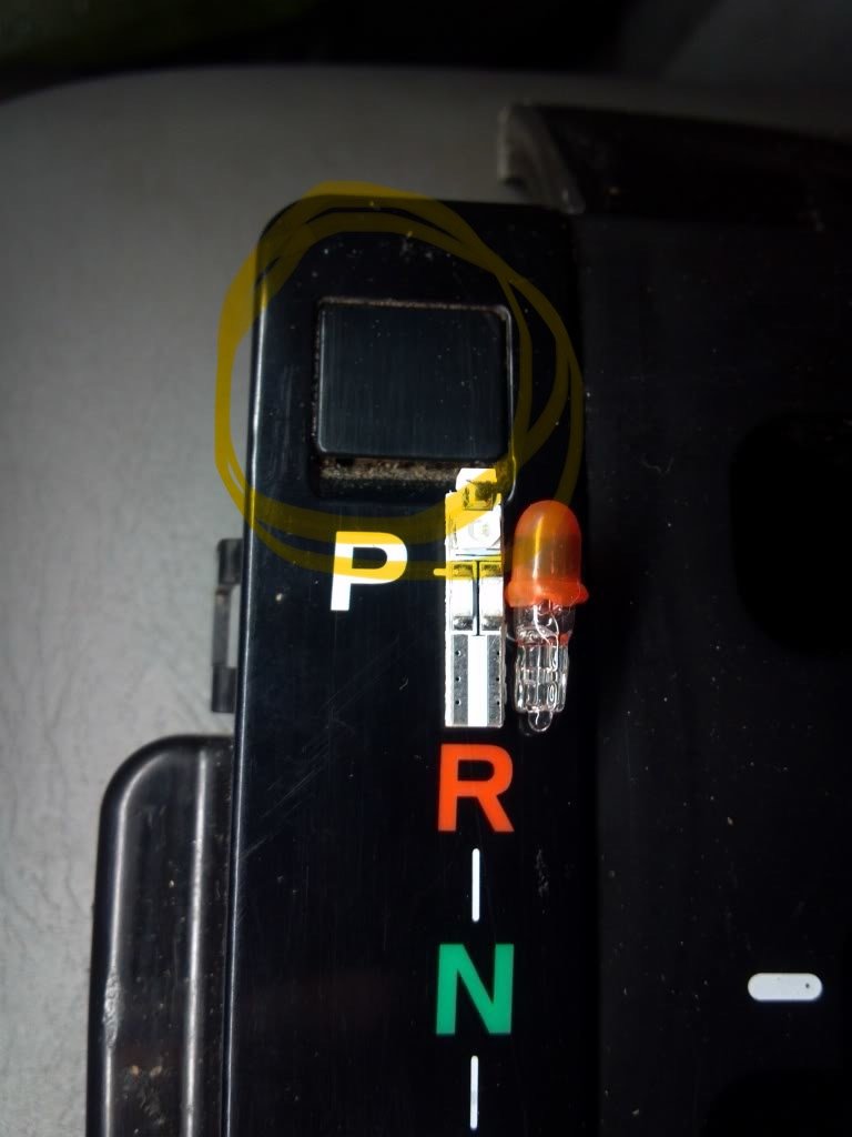

    Hot tip! I didn’t even realize mine was burned out until seeing this. My question is on the opening above the display, a search brought me here. It’s empty like in this photo first photo. What is this? If I stick my finger down in there, it retracts like it’s a button but the cap/cover is missing.

    It is exactly that.
    Pushing the button releases the lock on the shift lever, allowing you pull the transmission out of Park.

    That is your park/shift brake interlock override. if needed you can flip the cover open and press the button to shift out of park without pressing the brake/don't have battery power, etc.

    Thanks, working as expected, even without the missing button. Does anybody know if a replacement button is available separate from the rest of the component? I’m guessing that’s probably a longshot
