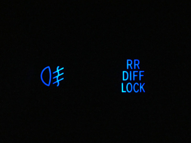

    That looks awesome! The light looks a little unevenly distributed across the switch though, is that just the picture or do yo notice it when driving too. I assume the blue isn't too bright?

    Where did you get the blue bulbs at? I want to change all of mine to blue now. How many bulbs did you have to buy to replace them all?
