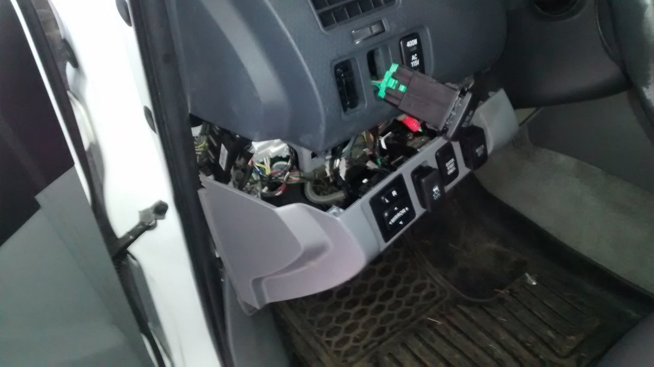

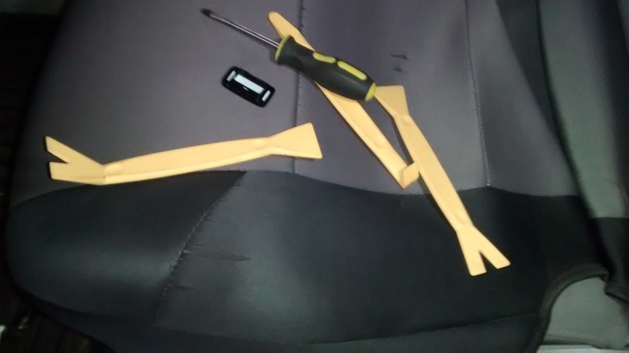

    Removing the dash helped. Removed the screw near the door (tucked behind the panel coming up from the floor) and removed the right screw behind the pop-down panel, tugged dash down. Then I tugged the dash with the fog light switch out. That probably wasn't necessary, but it gave me a bit more room. I used nylon body panel tools (Harbor Freight) to push, pry the middle switch out, and then used the reverse V tool (in photo with screwdriver on it) to push the fog light switch out from behind (by pressing the reverse wedge against the switch and pulling the tool). It's taken me longer to type this than it did to remove the switches.
    I have four bulbs to replace, so I ordered 4 T3 neowedge bulbs off Ebay for $10. We'll see about quality when they come on Monday.
