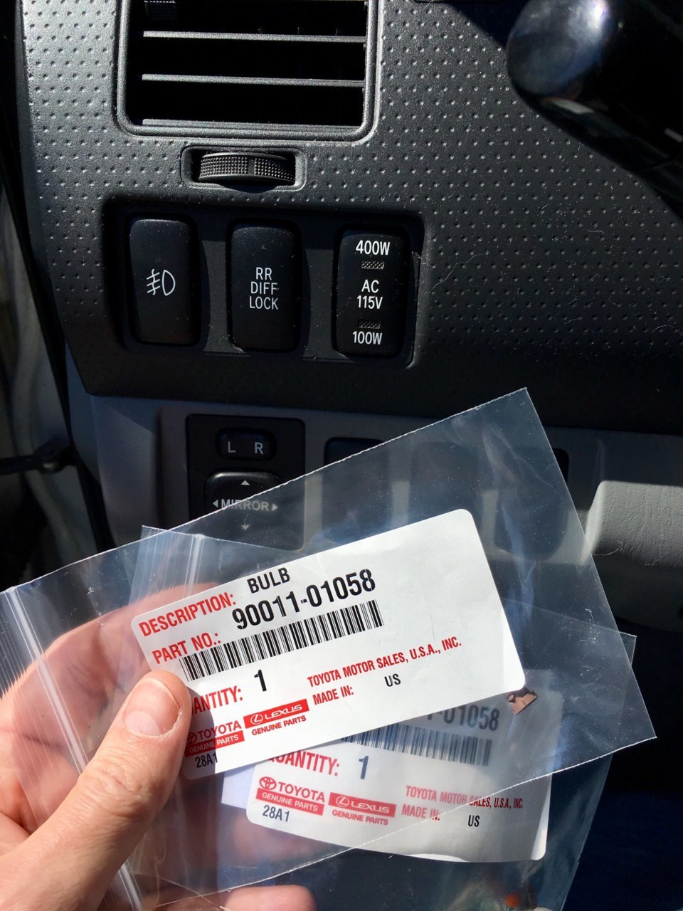

    Figured I would update.
    Part number was spot on, got my replacement bulbs last week. Pulled the lower dash and popped the switches out, put the bulbs in, stuck em back in.
    Maybe 15-20 minute job. All are now lit again and my wife can find the foglight switch in the dark.

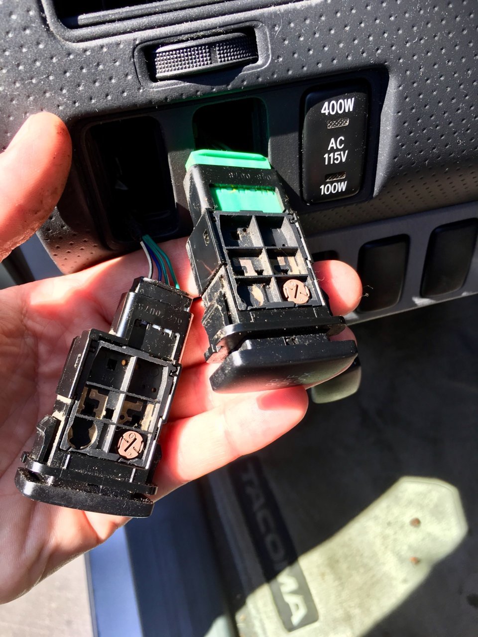

    all you need is two small flat head screw drivers to pry/pop fog light button out, then use one of those screwdrivers to replace bulb. takes less than a minute to do.
    I just did it yesterday, except I put a new light switch in with blue lights to match the other 3 light switches i put in and wired up yesterday as well.

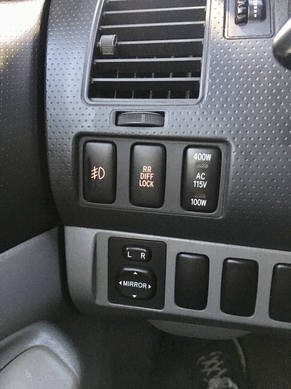

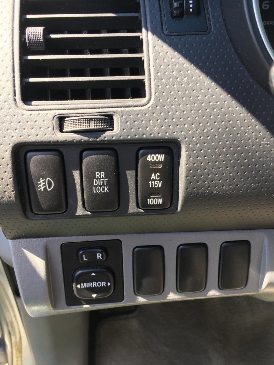

    Owned the truck for almost 11 years and the fog light switch never illuminated. Replaced the bulb today and now it works. I used the part number in the OP and everything is good. 20210303_141327.jpg

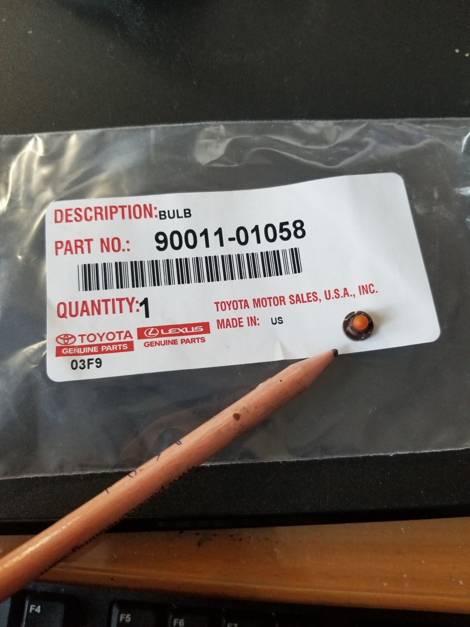

    I ordered the bulbs years ago in the first couple of posts and they are Amber does anyone have the part number for the green
