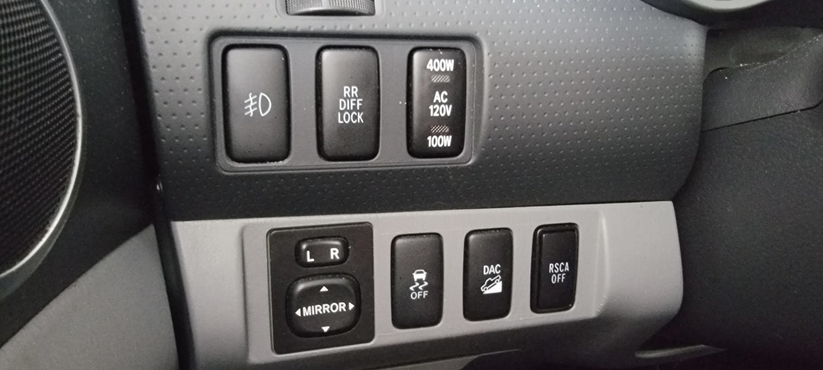

    Haven't read through every reply on this thread... but question??? I have a 2008 off road and it has I think 4 switches in this area with 2 lit up, are all these supposed to be lit? The fog and rear diff are lit but the clutch by pass starting and the inverter switch are not lit up. the other 2-3 places are blanks. thanks bob

    i did read every post lol. and everything should light up left of the steering wheel except for the mirror controls.
    I need to try getting to my fog light switch because i have to tap it to illuminate and my dash is half way apart doing the accessorides remote start.
    my 2012 seems to have some metal structure below it making it hard to remove. I dont really understand what hes doing with the fishing line, unless thats what he is using to depress the tabs.

    So if everything on this side is supposed to be illuminated, do they all take the same bulb? I swear... I bought this truck new... first owner and all... and I can not ever remember any of these buttons being lit. But now I want to fix it right.
