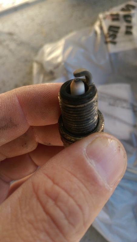

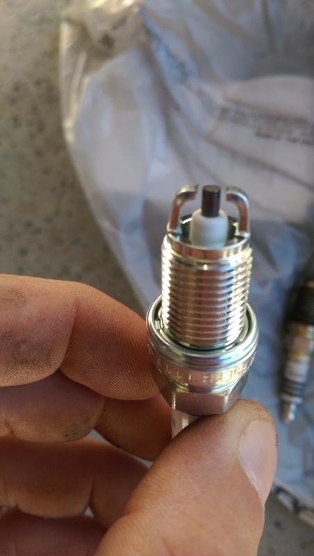

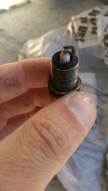

    I know this topic is quite old and also beat like a rented donkey! I recently had the pleasure of seeing this issue first hand a friend of mine with a 96 Tacoma very similar to my own was discussing his engine issues, such as stuttering, terrible gas mileage, bogging and flat spots, and now it started dying after getting off the freeway. I asked him what kind of maintenance he had done in the past and he said plugs and wires, fuel filter, air filter, mass air flow sensor, and the usual oil change is around 3000. All these things seem like they could have Ben one of the solutions for these issues. However since they had all been done I left them alone and decided to go straight for the plugs knowing this issue has plagued many Minds! Keep in mind these plugs were 6k miles on the 5vz. the plugs he put in there were recommended by your local auto parts store as factory OE replacements upgraded platinum plugs, or so they say. the center electrode was completely missing from the entire driver side bank plugs, instead of protruding out of the center ceramic insulator it was recessed more than 3 millimeters. this factory OE plug was complete garbage and I could see immediately that this was going to be an issue. I swapped them out for the NGK dual electrode that I have in my Tacoma. Wam bam! LIKE A BRAND NEW ENGINE AGAIN. She ran top notch immediately & not a single symptom was present. moral of this story manufacturer's suggested parts only..
    IMAG0335_a585388fc8dbf306d90dd32f80011580b2a54c88.jpg[/URLIMAG0337_50cc9ea908898dc4ebc6485b67584b4b83790c51.jpg[/URLIMAG0338_89fbf1adb35c65057f09ce68cccbb79413296afb.jpg
