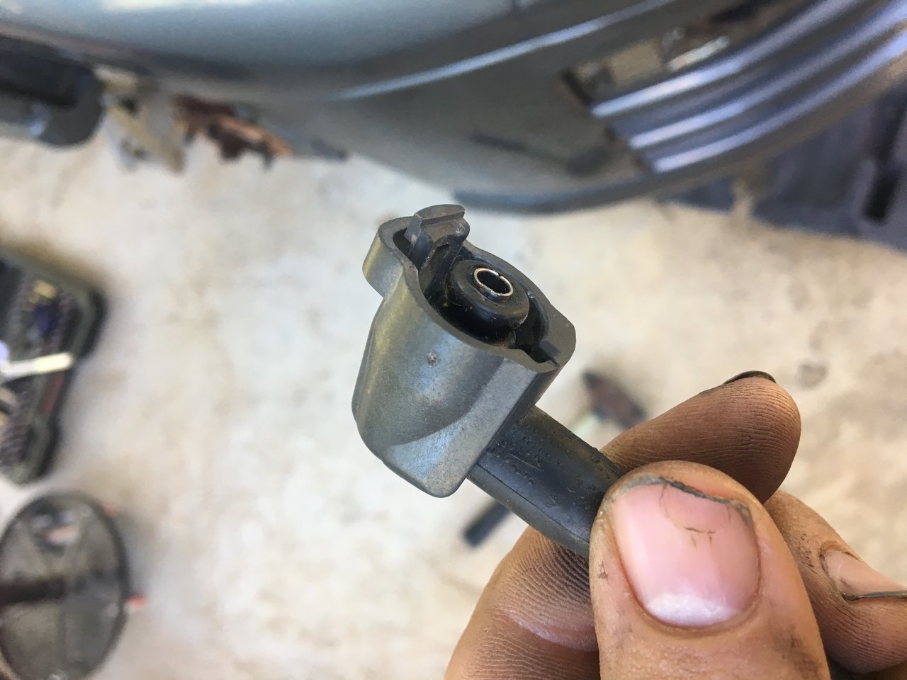

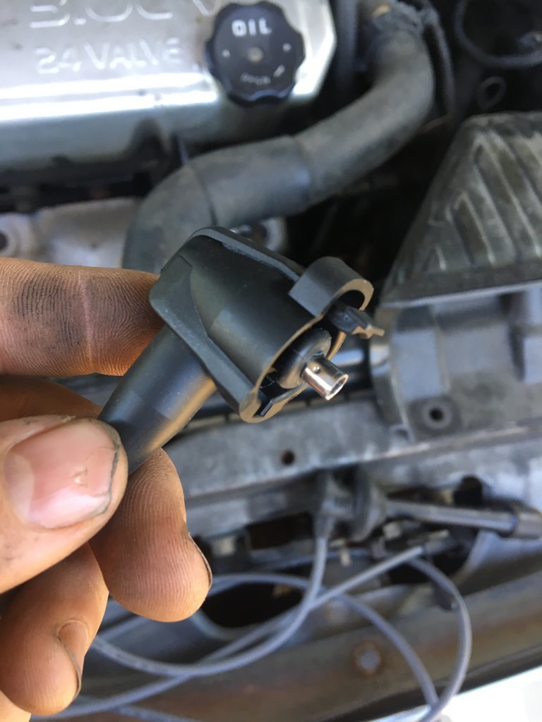

    Sorry to revive old thread but don't want to make a new one. Has anyone encountered problems with the connection between the coils and new wires? My new wires don't fit well on the coils because the conducting material in the wire sticks out more than it did in my factory wires. (See pics below). I checked with Oreillys to make sure I have the right wires and I do. Other brand wires look the same way as well.
    Old wires:
    New wires:
  12. Sep 28, 2017 at 10:29 AM
    #132
    ThunderOne
    ThunderOne Well-Known Member
    May 20, 2009
    #17473
    10,048
    Mitchell
    Nashville
    1ST GEN OR GTFO
    Toyota NERD
    That seems fuckey. I would take them back and get wires from the dealer or an online OEM supplier (camelback toyota, trdparts4u, conicelli toyota, etc)
